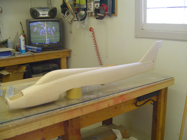

Phewww! All the heavy duty carving, hollowing, and sanding is done! It's finally starting to look like a Mach 1. There has been some talk about using the OS AX .55 in the Dirty Birdy threads. The AX .55 along with a Performance Specialties muffler is what I plan for this one. The fuselage as you see it weighs 15.2 ounces.

Thank you everyone for your compliments.
Dave, I'm building this one from plans. It's been alot of work but I'm thoroughly enjoying the build. The plans are pretty good but they are like most of the plans from that era in that they contain some minor inaccuracies. For instance the former drawings are not quite symetrical. So before I began the build I took the time and drew them out using my CAD program. I then printed the formers off on sticky back label paper, and slapped the patterns on the wood for cutting. It's the next best thing to a laser cut parts.
All in all the fuselage is not that hard to build. There is an extensive amount of carving, shaping, and sanding involved.
