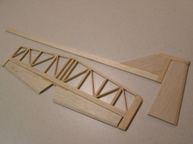

This is a 12 or 15 year old Ace Super Pacer kit. I'm building it to fly in a local contest in July 2008. I bought the kit a LONG time ago, after flying a friends plane a few times. The kit, along with a half dozen others, has been sitting on the shelf waiting to be built. There's a second Super Pacer kit there too.... maybe someday.

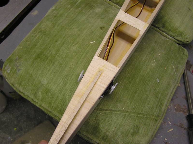

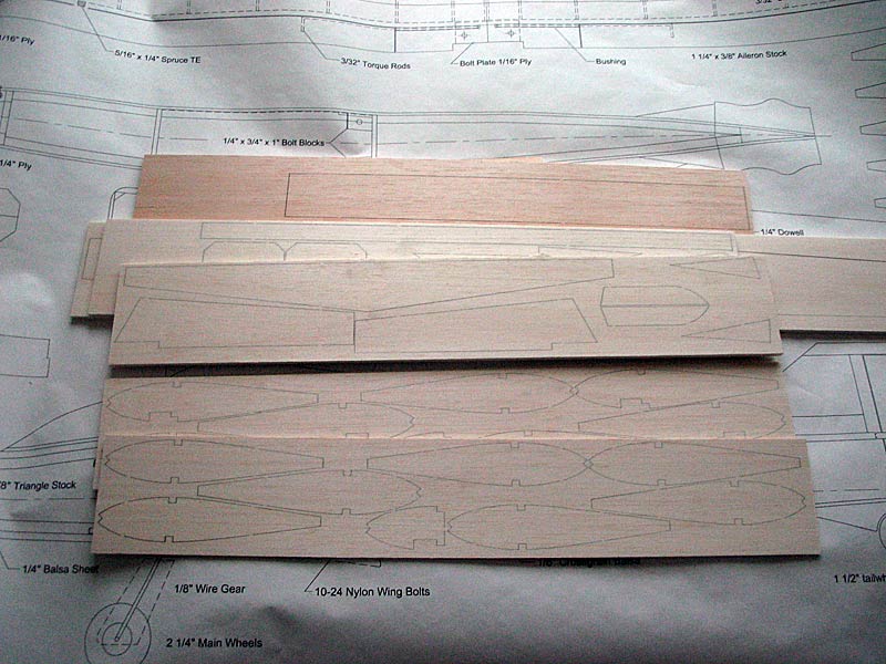

The plane is what I call "1980's over built". In my opinion, the wood selection is overkill. In the "old days" of the 1980's, it seems 1/4" planking and plywood formers were used everywhere. I think we were building for crash protection, and not so much for performance. I'm going to build the kit relatively stock, but substituting some construction and wood in an attempt to save six ounces.
As you can see in the build photos below, the stock kit uses a 1/4" thick, solid horizonal stab and elevators. I chose to build up the stab. Was goin to build up the elevators, but the weight savings wasn't going to be as dramatic. I'll be using the hole saw to cut out a few holes later in the construction. I'm using the stock rudder right now, but may build one out of sticks later.
My goal is to remove the wood weight such that I can install some Hitec 255 servos in the tail, and avoid using long pushrods. Each servo weighs about one ounce each. So, if I can save three ounces in the tail, I'll be happy.
The front of the plane, and turtledeck uses a lot of 1/4 and 3/32 planks. I'm going to use 1/8" with a few extra cross stiffeners. I'm also removing a lot of the material from the formers.
In my opinion, the wing could easily lose three ribs and be just fine... but I chose to keep the wing stock. In hind-sight, I should have drilled some holes in the ribs... I may try that later, it will just be a pain with the wing half that is already built up. I'd like to install a couple of shear webs in the wing, but it's so thin, and has so many ribs, that shear webs most likely won't help any.

Thanks guys.
I'll post more photos as I progress.

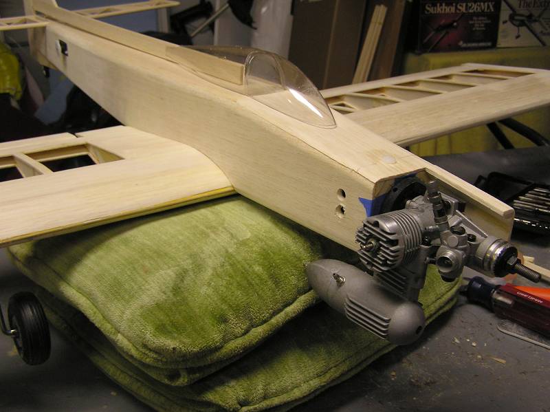

I've got a Thunder Tiger .25 for power. Most likely I'll mousse-can pipe it.... but we'll see how she does stock first. I think it will fly just fine on a stock muffler though.
Remembering back about 12 years.... the buddy's plane I flew had a .28 in the nose on a stock muffler. It flew very well. Another guy jammed a .32 in the nose of his, and it was too nose-heavy, and flew terrible.
I've decided to frame up a vertical fin, rudder, and turtleback spine. It will be fun,
and save a little more weight.

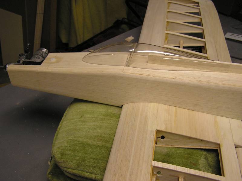

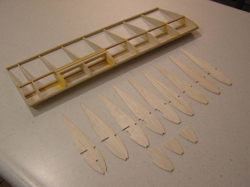

Wing is done. Except for final sanding and final fit to fuselage. I'll get the fuse back out and start working on that. It's been rather warm here the past few days, and I got a lot of building time this past saturday. It's supposed to get cold here again, with a high of 18 degrees by Saturday.....

The stock wing is way too heavy, IMHO..... far too many ribs, fully sheeted leading and trailing edge.... it's solid as a rock. I guess I'll see how well it flies, and I can always build another wing, making it much lighter, if need be.
Here's what I'd do if I built the wing again:
1. replace the basswood spars with balsa. No need for spruce spars in this wing.
2. remove two or three wing ribs from each wing half, and
3. make the cap strips a little wider
4. remove the carved up blocks of balsa on the wingtips, and put a simple anti-vortex plate out there
5. replace the aileron stock with built-up 'rons
6. Cut the length of the landing gear in half. There's 7 inches of steel wire buried in each wing half. I think I could have made my own new gear, and cut that length in half.
7. Added a mini sub spar ahead of the main spar, and cut the sheeting in half... basically, sheet only the very forward leading edge of the wing, both top and bottom.
8. reduce the amount of sheeting in the center section
9. increased the size of the dowel in the leading edge (that holds the wing on the fuse) to the next larger standard size.
ahhh well... maybe if I build another....

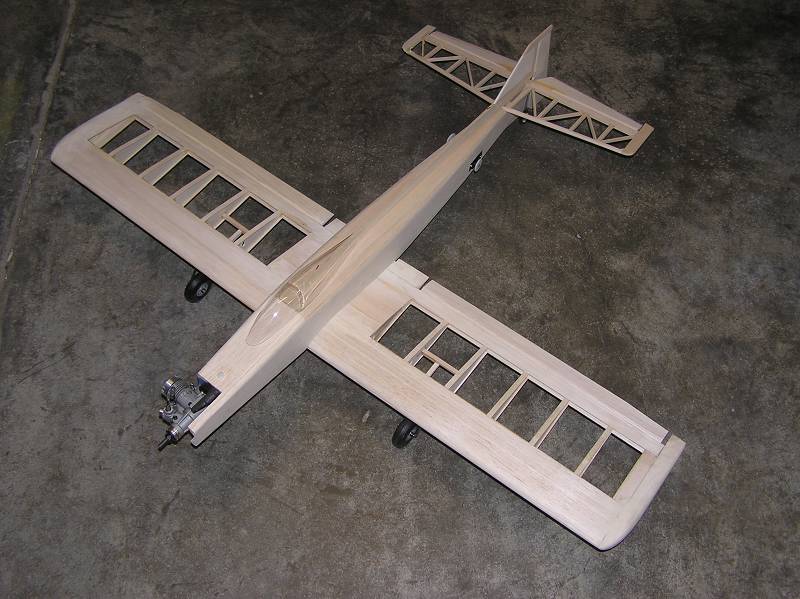

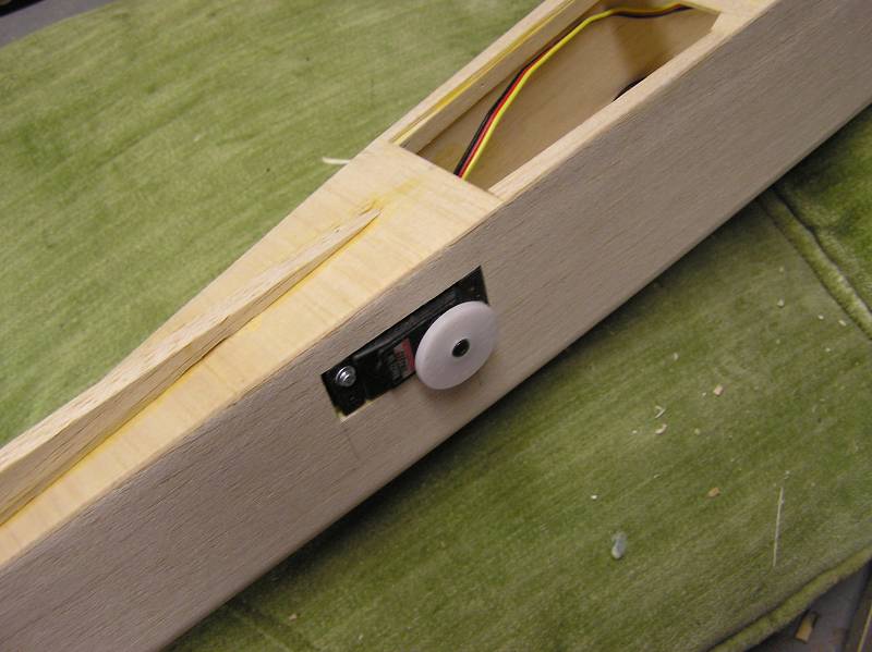

Ok Guys,
Wing is framed, pretty much complete, less final sanding. I still need to install the wingtips.
Fuse is pretty much done too. Note the two holes in the right side, those are for the fuel lines.
Tail surfaces are complete.
Canopy is cut and fit.
Fuel tank is built, and partially installed.
I really like the servo installation in the tail. I counter-sunk them into the fuse sides. Nice and clean install.
She's ready for servo installation. Then covering, then final assembly.
