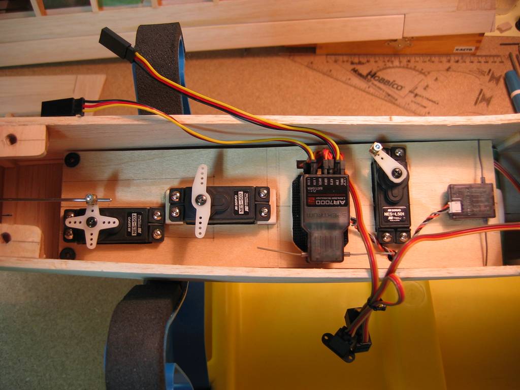

Here are some pictures of a radio installation that might be a little more appropriate for your glow model (standard servos are used since this is a 40 size model). You can see how I went about planning it and then changing things as it went together. I needed to make sure the area behind the wing LE former was able to be cleared so I could remove the fuel tank if needed. This particular model doesn't have a front tank bay hatch like the SP.
I should mention that here the servos' are installed in a staggered fashion because the elevators are independent (not joined) and operated by a forked pushrod from the single rearward servo. In front of that servo is the rudder servo which is centered on the fuse center-line and used with a Pull-Pull wire setup rather than a pushrod. In your case, using two pushrods, you can simply install the servos for the elevator and rudder side by each in the back with the throttle servo just forward of them as described in the post above. Very similar to what I did on the SP but it might help to cut a servo tray on which you can mount the receiver -especially if it is a small modern 2.4 GHz type Rx which is hard to pack in foam.
I mount my receivers by using double sided foam tape on a little lite-ply board which in turn is velcro'd to the radio tray or fuse side. This helps to insulate them from vibration. One can also use a velcro strap with the Rx backed by a piece of foam rubber but they have been known to slip on occasion from under the strap.
David.

That is a very, very, very nice installation David. I was looking into light balsa and laminating it with CF for the Tiger Tail III, but I kept looking back at the 1/8 ply trays I used to hack and saw up back in the day. Did you use 1/16, 1/8, etc? I was thinking of using basswood to save a few grams or simply the 1/8 ply with lightening holes, on rails.

I'd like to bask in the glory of it but there wasn't too much rocket science behind it. CF laminated balsa is very cool and stiff but also a little pricey (well, CF is). If you are going to produce some for formers or some such, then by all means, might as well make a servo tray while you're at it. Otherwise, good old fashioned hardwood (basswood or ply) does the trick. Provided the try is properly supported, I find that 1/16" ply is fine but if I had more of it, I might use 1/8" lite ply on larger models. The lite ply can be a little dangerous though as it can "chip". I made the frame for this model with 1/16" ply and then, where the servo's go, I back up the tray (above or below as required) with some 1/8" ply or square hardwood stock. Even if using 1/8" ply, I find it is not thick enough to adequately capture the servo screws.
I am still on a search for the ultimate way to mount an elevator servo sideways though in the absence of a purpose built side mount servo. Putting the servo on it's side is really the way to go in my opinion with forked split elevators - almost completely linear motion is transferred to them. I often find that there is not enough space between the fuse centerline and side to accommodate a standard size servo and put the output on the centerline. With classics, I've found that I need to use low profile aileron type servos so they will fit.
I'd say go with the 1/8" stuff on your TT and remove material where not needed - more effective on a 60 size model.
