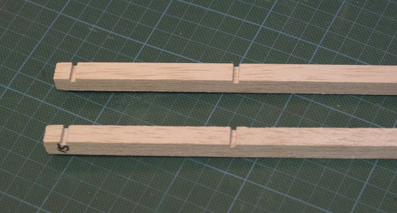

I had a Great Planes wing jig laying around so I decided to use that to build the wing. After fabricating the wing ribs the other parts of the wing structure need to be fabricated. In my opinion the model is overbuilt but I wanted to stay true to the kit. The 3/8 in sq hard balsa spars were matched in pair according to weight and then notched to fit the wing ribs. The sub-trailing edge stock was also notched. I used a jig setup on the scroll saw to quickly and accurately create the notches.

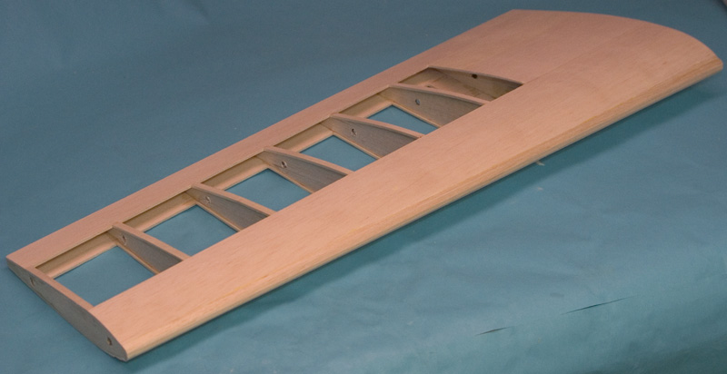

One final post for tonight. One other small change I made to the original wing plan was to shorten the rib faces slightly (by 1/8 in) so that a sub-leading edge strip could be used. I have used this method on some of my original designs and find it to be a great way to create a leading edge. The sheeting glues to the ribs and overlaps the sub-leading edge piece creating a nice solid wing leading edge.

I also prefer the sub-LE method. I never liked trying to feather sheeting into an LE when it's glued on top. It's never as neat. Notching the TE is also worth the extra time. It's a much stronger joint and it keeps the ribs square. Great job!
