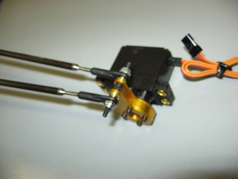

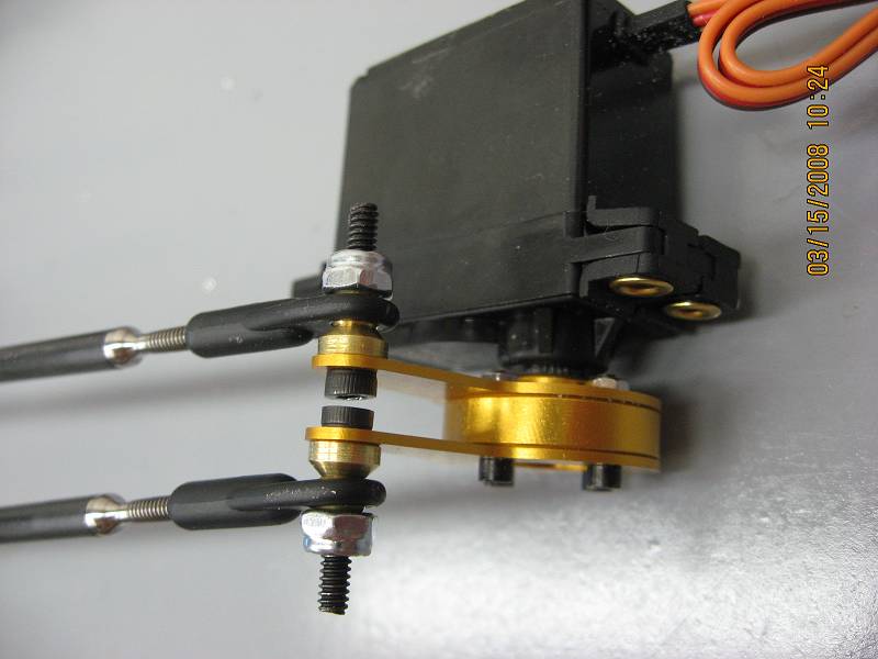

Hey, what do you think of my DEPS solution? THis is an Air Wild Hobbies 90 Degree arm, with (1) leg cut off. Then I used (2) Central Hobbies CF pushrods, and ball links. This will control the split elevators on my GP Illusion.

ORIGINAL: jquid
Great, as long as the output shaft is double ball bearing supported. Single - it might have problems and the tracking won't be so good.
