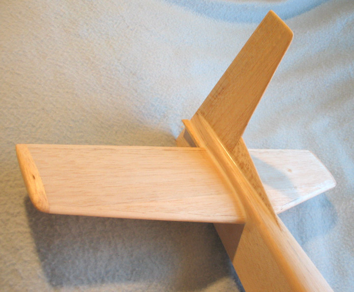

ORIGINAL: rainedave

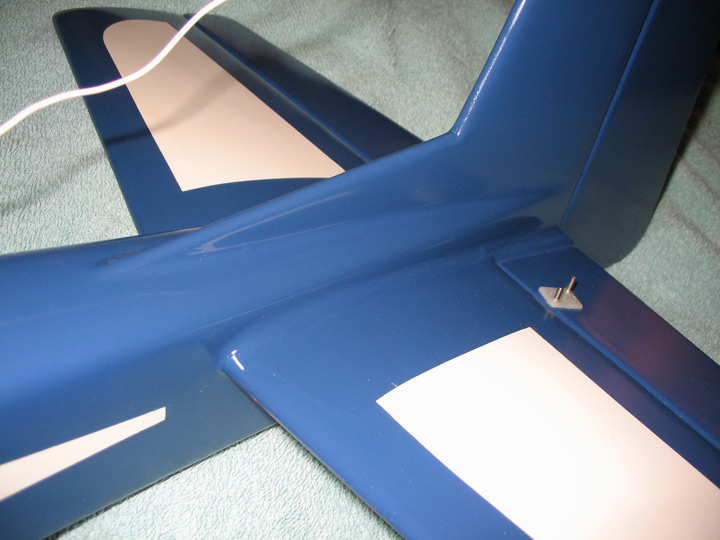

It would be some work, but you could make a built-up, symmetrical stab like I did for my Super Kaos Jr. I was told by a current pattern plane designer that it would help tame the tail wag.
David
David

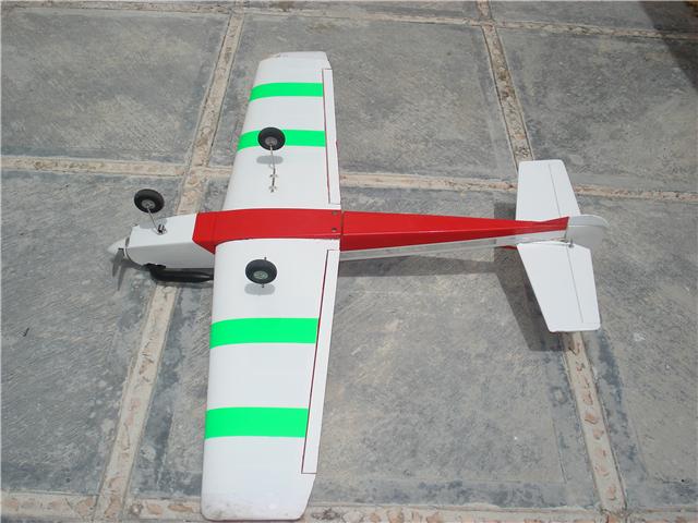

Hey alcarafa:
The only mods that I made to the TH Kaos was to strip off the cheap covering. When I received the Kaos all the seams were coming up and the covering was a mess. Hit it with a heat gun and it all came off. The rest is history.

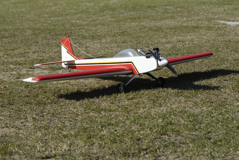

Alcarafa,
Here's something different to consider. Here is a picture of my Tower Kaos that I converted to a tail dragger. The motor is a YS53 4-stroke getting ready to turn an APC 11X7 prop. I haven't flown it yet, but I'm getting the itch to fly it pretty bad...

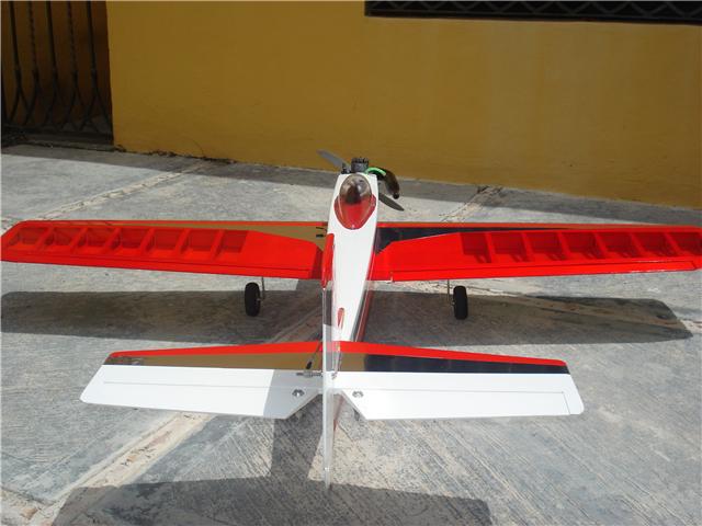

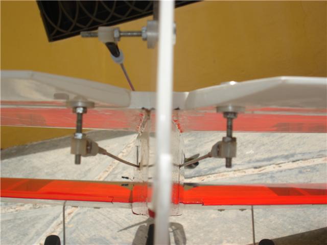

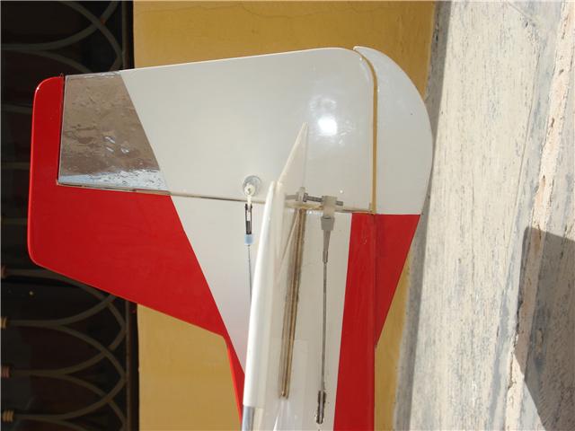

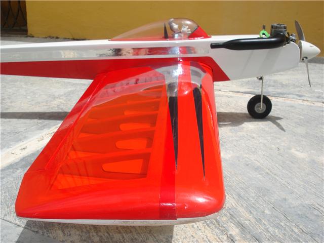

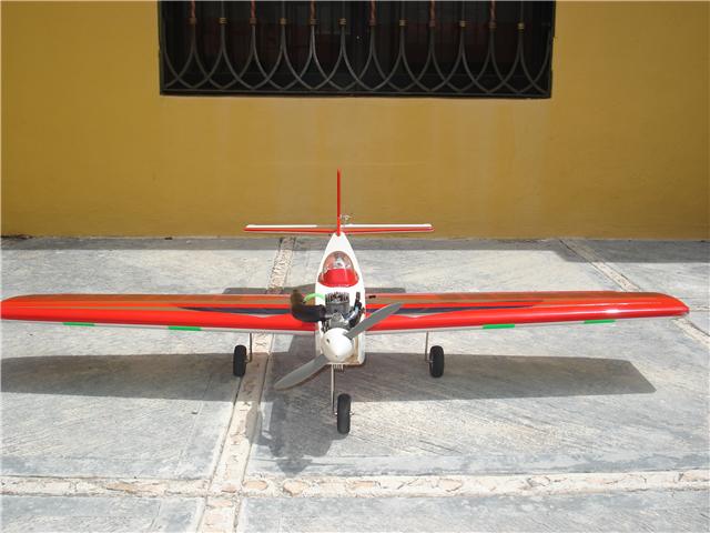

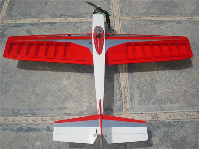

Hi guys I have finished the mod's on my TH KAOS, set up ended with SPEKTRUM DX7 & DS821 Digital servos, 6 v 2500 mah battery, striped and covered again with transparent red ultracote , silver and white monokote, Os 46 FX with MACS pipe and APC 10 / 6 propeller. Also changed all the hardware supplied with the plane except engine mount.
This lady flies fffffaaaasssssssssttttttttttttttt !!!!! specially at sea level where I live.
I followed set up for servos, ailerons, rudder and elevator from another post here in the forum, and it really is smooth as silk.
HERE ARE THE PICTURES OF THE MODS FROM MY TOWER KAOS, YOU CAN NOTICE I UPGRADED THE HARDWARE, COVERING, CHANGED THE TAIL ON BOTTOM, THE NEON GREEN ON BOTOM OF WINGS IS A GOOD WAY TO SEE HOW THE PLANE IS FLYING WHEN PLANE IS ROLLING.
Hope you like it
Rafa
Hope you like it
Rafa

The plane looks great! Best of luck with it. Nice colors on it [&:]
Worth noting though.... the black Mac muffler you have on there is just that.. a light weight muffler with decent flow characteristics. It has no tuned pipe effect - not a tuned muffler.
