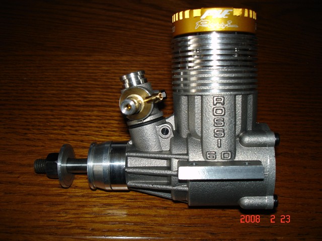

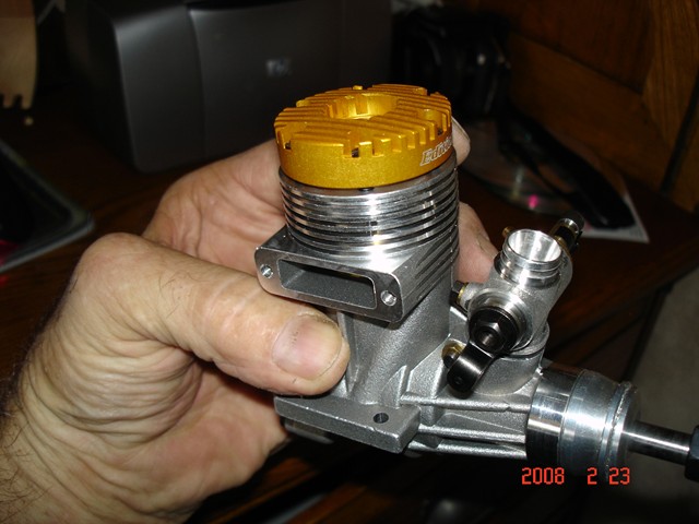

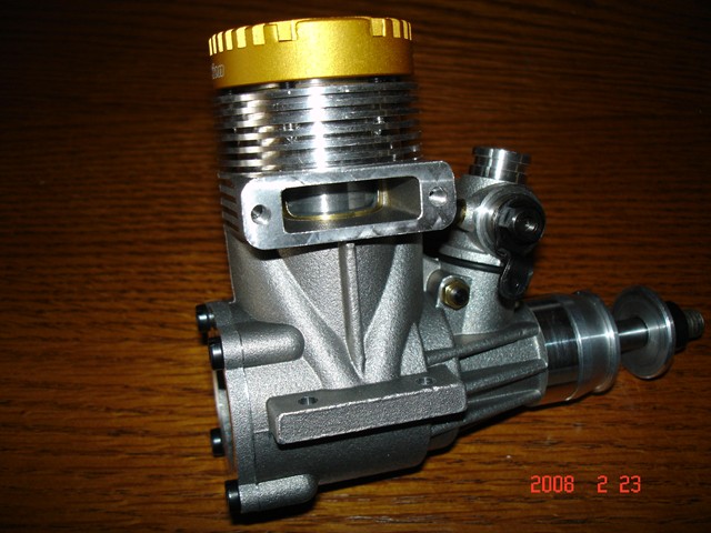

Put the new Rossi in one of the Phoenix' here. Started first flip, right out of the box. APC 12X7. I have never used a tach. For a new powerplant, I am impressed. I have heard story's about the carb, but it comes down fine, great transition from idle. For a new ABC, looks good, sounds great. Using a Mac's muffler with adapter's, may have to use the single adapter and another Mac. Muffler hanging a little low, may go to a 2.25" wheel on front. I was told, 2 gallons to break it in. That will be in the air.
Any suggestion's on this Rossi, I would appreciate it, but all looks fine. Using 15% Omega. I had to try this out, vs. the OS61FX's in the other planes. I don't like the rear NVA in the tight opening.

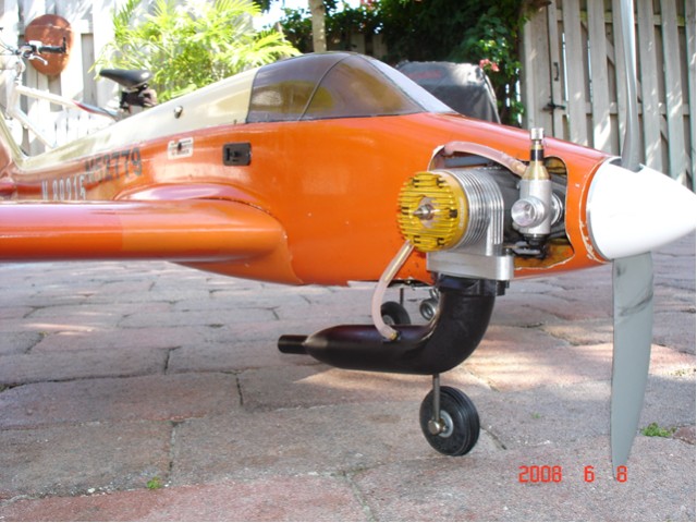

That's too much nitro for a Rossi....at least for the Rossi engines I used to run. Unless things have changed, Rossi engines of this type are designed to run on low nitro and even no nitro. I think you'll be happy with the performance on 5%. With 5% you will be saving some $$$ and extending the life of your engine. Why not give it a try?

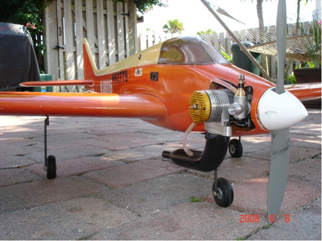

JC - Rainedave - As far as I know, 15% is fine. I will ask Sahak at AXE Rossi in CA, which is best. I checked this fuel situation out, some time ago. A copper head gasket comes with it. I do not have it in. If 5% is the way to go, then I will do it.
After running the first tank, the engine was not that hot. It cooled down fast. No lean runs. More later, and thanks for info.

Unless this model of Rossi is different than its brothers, 0% to 5% without a shim and a medium to cool plug will give you the best performance and reliability. If you have to shim it to run 10 or 15%, then it was obviously designed to run 0%. From my experience, the less the better in Rossi's, MVVS's, Webra's, Moki's. Even if you shim it to run more nitro, it will still run better on less without the shim.
I have a Rossi 50 that thrives on 0% nitro and 10% oil.
