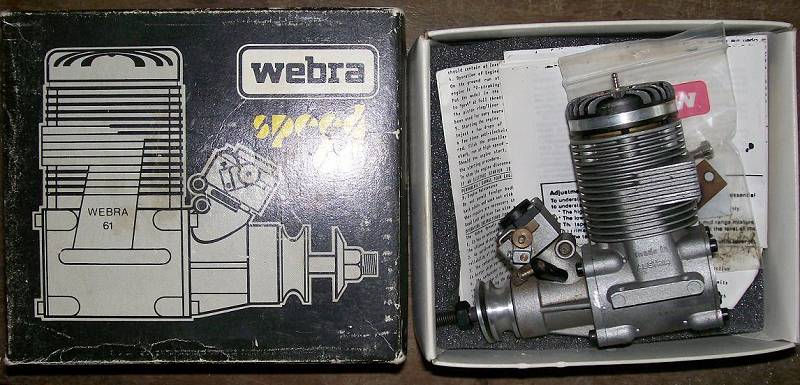

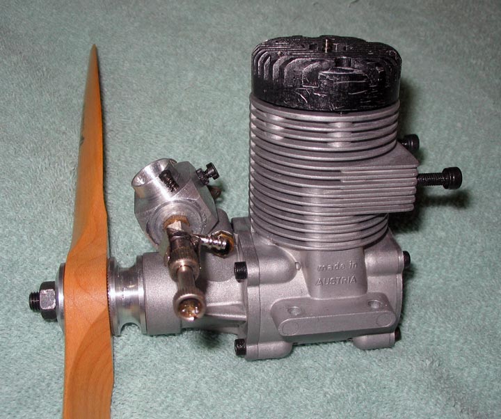

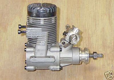

Does anyone know which model this is? The Racing 61F (1030), the Racing 61F C (1030C), or the Speed 61 LS (1033CP)?
David
ID:	977235   Click image for larger version
Old 06-23-2008 | 08:18 PM
My Feedback: (102)
Joined: Nov 2007
Posts: 609
From: Transylvania, LA
Default RE: Webra ID
Doesn't look like a long stroke. They would have a taller head gap. My 1030 RC ABC looks like this one.
Terry in LP

Thanks Terry. I think it's a 1030 racing 61, too. I don't have it in my hands yet, so I don't know if it's ringed or ABC (they made both versions according to the Webra site). I bought it from Paul's Model Supply at auction for $37. Webra still sells all the parts for it, in case it needs anything replaced. Now that I have a rear exhaust .61 there are lots of new possibilities in terms of models I can build for it.

Old 06-24-2008 | 05:36 PM
My Feedback: (57)
Joined: Jun 2003
Posts: 960
From: genoa, IL
IT has been a long time..... but the cob webs tells me the Racing 61F (1030) had the black head with the polished ring around it. The 61FC (1030C) was the same as the 1030 with the addition of the dynamix carb. And the 61LS (1033CP) was the all solid black head engine. Here is a pic. of the 61FC

Thanks impactiq. Most Webras I've seen don't have the model numbers on them. I'll learn more when I get it, but it does look more like the 61LS head.
Definitely NOT!
The engine with the all black head is the shortstroke, the engine with the polished ring is the long stroke.
You can imagine that for both engines use the same crankscase, but the longstroke with its longer hub has a higher liner. You can see that longer liner between the case and the head, look for that brass ring !!!
Best Regards,
Rainer
German F3A Team Manager

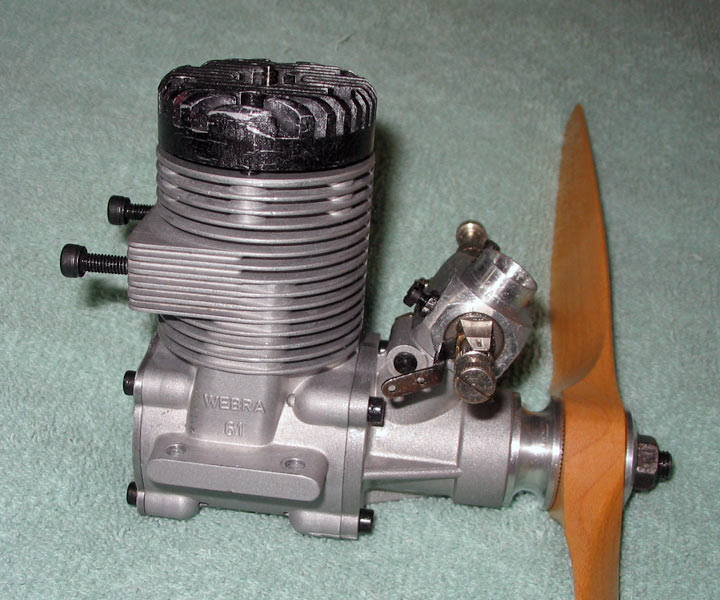

Thanks Rainer. I blew up impactiq's photo. Is this the top of the liner you are referring to?
David
Old 06-25-2008 | 08:25 AM
Joined: Nov 2007
Posts: 21
From: Munich, GERMANY
Exactly, that's it!
The Racing 61F C, as you can find it on the Webra home page (aero engines) is the revival of the "classic" Webra Racing (1030). It has a modified crankshaft (8mm instead of the former 1/4"). Bore is still 24mm, stroke 20mm, recommended propellers 11x6/12x8, everything typical for a SHORT stroke.
Rainer

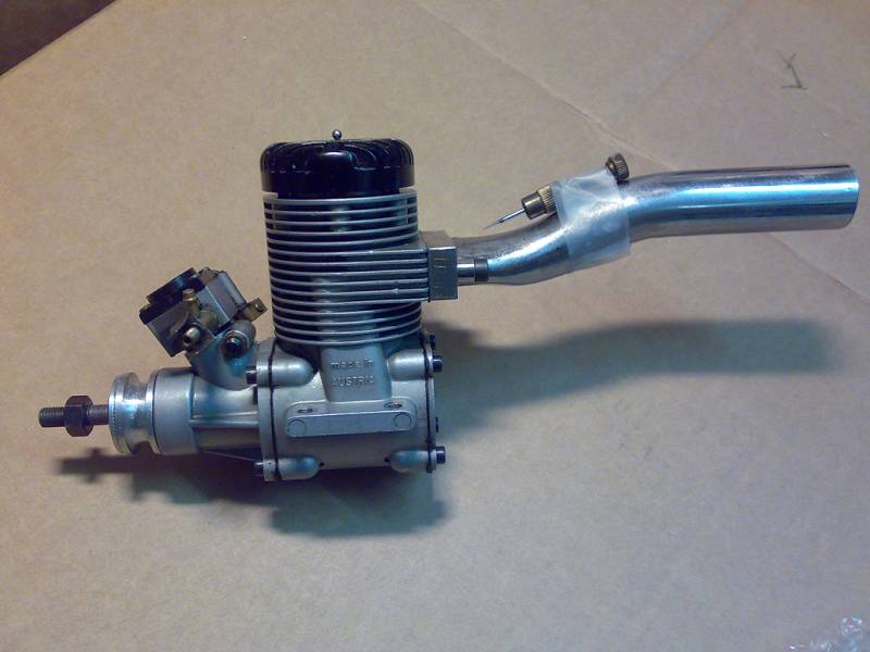

The engine arrived today and I cleaned it up a bit. It's in very good condition internally. There is no visible wear on the rod bushings. The piston was just starting to get that light golden varnish, but there was no black carbon anywhere, even up inside the piston. I have learned that one sure sign of an engine that has been run lean and hard is egging of the top rod bushing with black residue. The bearings are not rusty, but rougher than I trust so I'll get a new set from RC Bearings. The crank looks almost new. The best news, IMO, is that it's the Dykes ring version, not ABC. I know you can get a few hundred more rpm out of ABC engines, but I don't even want to think what Webra sells a new piston/liner set for. Frank Bowman has the ring in stock for $14 shipped. Scuff up the sleeve, put in a ring, and you've got many more gallons of use. The only part that looks bad is the head. I might see if a friend who anodizes engine parts can restore its appearance. The rest of the external parts look great.
I haven't bought a header yet because I'm not sure what plane I want to build for this. So, it will be a while before I run it.
David
ID:	983090   Click image for larger version

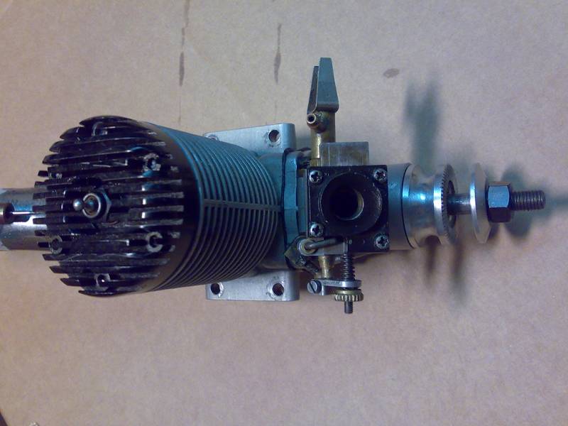

I've never operated the Dynamix, but I have three other TN's and they are really simple to adjust. Like most two needle carbs, you can only adjust the low speed needle after the high speed is set near peak. This seems to be more critical with my Webra TN's than with the average OS carbs.
I cleaned a bit more and scuffed up the sleeve with 320 wet/dry soaked with castor oil (you have to de-glaze them). As you know, Dykes rings typically don't create a great seal when hand flipping the engine. That's how they're designed. The seal is created on the downstroke as the combustion gases actually expand the ring against the sleeve. On the upstroke the ring imposes a lot less pressure against the sleeve creating less friction and drag. So, you don't feel the same kind of compression pop when hand flipping that you do with conventional rings and ABC engines. Still, there is a good pop with this engine.
Now, I have a question. What was the most commonly used header style for upright installations in classic designs? The fuselage top, 15° straight, or 90° straight? Maybe that's a stupid question since I really need to choose a plane first.[sm=bananahead.gif] I'm just impatient to run this thing.
David
ID:	983250   Click image for larger version
