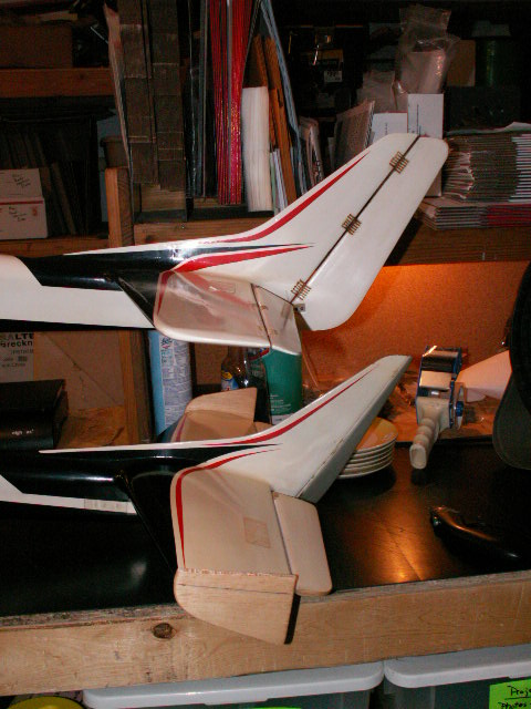

Taurus-II restoration 1
After getting some minor projects out of the way, work began last evening on the Taurus II restoration. It is my intention to post the progress, (such as it is), on this thread. It may take some time as I'm not the fastest worker in the world, and I am a little awed working on a plane like this, built and flown by "the Great One" himself....it is kind-of like I'm "not worthy"
or something. Now I know a little bit how the "restorers" felt working on Michelangelo's masterpiece in the Sistine Chapel....not quite, but you know what I mean.
When you work on the original 45 year old wood, the shavings and dust has that "musty crate" smell; I am constantly reminded I'm working on an original Kazmirski "classic". On the other hand, I'm here and he isn't, so if the plane is going to fly again, I'm going to have to do the best I can, and "pray" for his guidance. I'm trying to be very deliberate and careful.
First thing, I am trying to restore the plane to the way it LOOKED, (on the outside) back in 1963, and am not particularly interested in using the exact methods Ed would have used with the technology available back then...the final goal of mine is that it looks the same. With that in mind, I considered several methods to try to lengthen the stab some 7-3/4 inches, (Ed shaved that much off in his effort to experiment with the Taurus II by adding "side thrust generators" to the stab, presumably in an effort to increase drag..see picture). Ed also shaved down the elevators, so they will also need to be built-up. Strength not being a major factor, I eventually decided to add an approximate 3" long by 1" thick foam extender to each side of the stab since the stab was 1-1/8" thick at the point Ed shaved it off. Stab-tips will make up the difference as it was in the original. I used my "unfinished fuse" as a model, since it appears both the Taurus II and the unfinished fuse have identical thick stabs, (which are about 3" longer than the original Taurus). I felt a built-up balsa extension would be more difficult and would add too much weight. I believe this method will work, and I'll let you know soon, and include some pictures.
Going back to Eds stab mods, I don't have any idea if Ed's experiments were successful, or even if he actually flew the plane after making the mods to test the results of the changes he made. The S.F.G. while carefully applied, were not even painted, and frankly looked a little strange. I made up my mind I had to restore the T-2 to its original configuration as he first flew it back in 1963-1966 or so....and as it appeared in all the vintage pictures contained in this thread. This will be the biggest part of the restoration.
More later
Duane

Hi Duayne,
very interesting. What you call SFGs may actually be an attempt to reduce tail weight. Tip plates have the effect of increasing the effective Aspect ratio by reducing tip vorticies. So weight saved by cutting 3 inches of stab, but tip plates keep the effective tail area adequate.
Any Aero-engineers care to comment?

What you say is interesting since Ed DID make the stab-span in the Taurus II 3" longer than the original Taurus, (30 vs 27"). He may have been trying to get back to the original tail...but he could have more easily done that by making the new tail 27" again.
Before I made the decision to remove the "winglets" a friend and I closely looked at what Ed had done from all angles. The "tip plates" seemed to be canted in slightly, (slightly wider at the front than at the back). As Cees mentioned way back, we know Ed sought to have a CONSTANT SPEED throughout all the maneuvers...my friend took the winglet's angles to be a means to further increase drag for more constant speed on the downlines, but it is just speculation. Ed also originally wanted to do the same thing by designing the Taurus II with a very thick wing, (which we called the "Carrier Wing"..see above). That was the original wing he used on the Taurus II, and the wing he had with him as a backup to the 1963 "worlds", (there are FAI stickers on both the thick wing and fuse). Later on, for whatever reason, he decided to abandon that thick wing, and the Taurus II was converted to accept a standard airfoil Taurus wing. You can see the strips of balsa he used to fill the "thickness gap" on the fuselage. I guess what I'm trying to say here is that both the thick wing and thick stab were attempts to increase drag...he abondoned one early, and perhaps the other later on.
I DO know that he successfully flew the Taurus II (after a brief period with the Carrier Wing), with the standard Taurus wing, (with straight trailing edge), and its original stab, (without winglets) for several years because all the pictures we have show the standard enlarged stab. There are no pictures of the plane with the winglets. Other than it looking bad, that was the primary reason I chose to remove them.
The stab is coming along, and I should have some pictures to include in a few days. It's going to be difficult to make a perfect, seemless extension to the existing stab, but I couldn't leave it the way it was. Perhaps the smartest thing to do would have been to fly the plane with the winglets THEN make the change so I could compare flight characteristics, but I made the "executive decision" to do otherwise because I KNEW the Taurus II would fly well as it was originally flown.
One aside. My original King Altair had a 34" stab, (shortened by the builder to match the clipped wing). When I built my first "scratch built" King, I didn't "pick up" on that and built the stab full size at 36" while using the same clipped wing. I couldn't notice any difference, (but I'm probably not that good a pilot to be able to evaluate the difference; I'd probably attribute any difference to something else, the wind, or my own novice flying ability).
Duane

Duane, WEDJ
WEDJ is right, but there can be more.
I think "toe-in" Ed did use to generate also two opposite forces, compensating each other, with the SFG’s so more drag.
You also get a better balance just like a profiled fin to prevent waggling of the tail.
I use "toe-in" when using winglets on tailless and canard models in stead of the fin and rudder.
When there is a little rotation on the vertical axle the SFG that’s most out of direction generates the correcting force.
I think "toe-out" is dangerous to generate drag so it is safe to make toe-in. (Toe out I cannot use on tailless and Canards)
About the weight distribution, the more the weight is concentrated in the centre of the plane the better it will be manouvrable with less forces of the “doors”, so less drag. Also the balances around the axles/axis are "faster".
My contribution, success
Cees

Duane, thank you for another inspiring post! Since I saw the end plates for the first time I'm wondering what Ed intended. I had the same idea as WEDJ and I like to comment even though I'm not an aero engineer (industrial instead).
First, I wondered why Ed used a thick horizontal tail but the old slab vertical tail. The only explanation I have is that it's a by-product of the thick wing. There's a simplified rule that the tail should not stall before the wing. A thick airfoil makes for big maximum lift at high angle-of-attack, though. Usually the horizontal tail has a rather small aspect ratio to accomplish a stall at higher aoa than the wing. Now the carrier wing is so thick that a thick tail airfoil may be required in addition.
Following this simplified "theory", one could assume that Ed still felt that the horizontal tail stalled or was not effective enough. So he replaced the small stab tips by end plates, effectively getting more tail effect at even higher aoa. Maybe he fitted them toe-out (wider at the front) to avoid the nasty flow separations that would otherwise develop in the corners between stab and end plates. I don't think a small toe-in would have a noticeable effect on directional stability, either.
That's the only "theory" I had so far, and it has a major drawback since Ed fitted the end plates only after flying the T2 with the new thinner wing for a long time. So the reason for the end plates could be directional stability as well. After all such things are used on floatplanes for that reason, and maybe Ed was satisfied with the thick horizontal stab but not with the slab vertical.
As an afterthought, he might have complemented the small and ineffective vertical tail by the side force generators, as they are now called, or simply fins, like those used on many floatplanes to augment vertical area and directional stability. The small horizontal tail tips were not really needed (and the end plates gave more horizontal effect), anyway. And it would have been much harder to replace the whole vertical tail by a new one since it's tightly integrated with the fuselage. Ed did replace the slab tail by a big and thick-airfoiled tail (later?) on the unfinished fuselage.
It's all theory, I know, but seems consistent and is more than nothing. Any more bids?

Gents,
I am "OUT" with my toe-in, did understand "canted in slightly" wrong.
I still have a change when the SFG's are asymetrical as on my drawing. So flat on the outside and curved inside.
From reading from papers I still know that Ed did not want drag behind the propeller, in the slibstream, maybe that can still a point to think about.
Cees

Cees, I know what you mean, but things seem to be rather complex. I found Martin Hepperle's [link=http://www.mh-aerotools.de/airfoils/winglets.htm]winglets explanation[/link] very helpful.
Yes, the end plates are not in the slipstream and the vertical tail is. But the thick vertical might be intended to remedy a mushy rudder around neutral. And the rudder has to be in the slipstream to have rudder effect also without airspeed, only by exploiting the propwash. By the way, I think a more articulate rudder could be achieved as well by simply not sharpening it (a slab rudder with square trailing edge).
