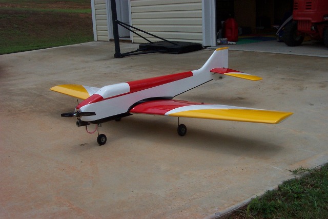

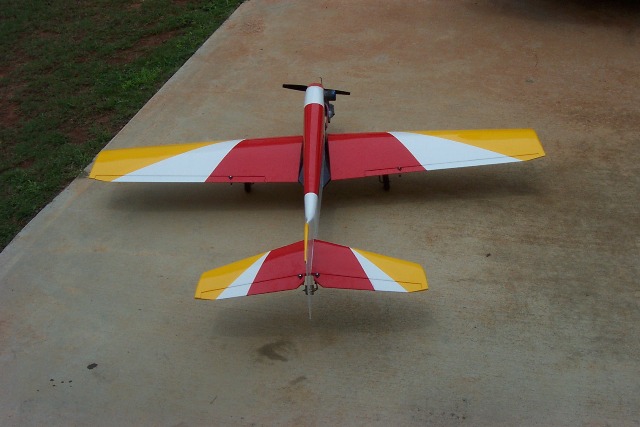

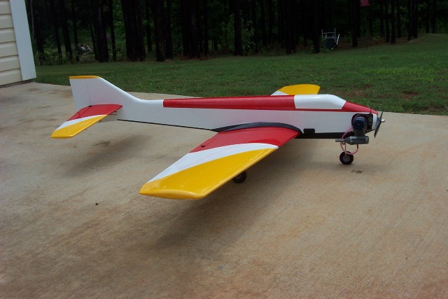

I just finished my MK Curare, have to pick up the spinner at the LHS, and just finished running up the engine. Need some info on initial throws. Plans don't call for any but I figured it would be a good idea to start with some knowns if you guys wouldn't mind giving me your setings.
MK Curare, (original parts still in box)
ST61 PDP Bluehead with old flow thru muffler, jeez is it loud!
6lbs, 6 oz dry weight
Yeah, I know it needs a few stickers or stripes, I'll get there, but after waiting 30 years to find this kit whats a few more days? Thanks in advance for any info.

Outstanding job! That is super light. What retracts did you use and are you going to hang a pipe on it?

ORIGINAL: Bashedit
Elevators: 3/8" up and down
Ailerons: 1/4" up 5/16" down
Rudder: 2" L & R
This is a good starting point. The ailerons on mine needed a touch of differential, hence the difference up and down.

Nice looking plane! You did a nice job Just curious, is that the battery switch behind the muffler?

Yes, that is the switch, wasn't sure where to put it when building. Next time it'll be further back and on the other side.

"ST61 PDP Bluehead with old flow thru muffler, jeez is it loud!"
I have that exact muffler on one of my Blueheads. I don't know why they call it a muffler, because it doesn't. I took mine apart and screwed a large sheet metal screw into the flow through venturi from the inside. That quietened things down a lot but unfortunatly also robbed quite a bit of power.
The good news is tha most any 60 sized ST muffler will fit this engine.

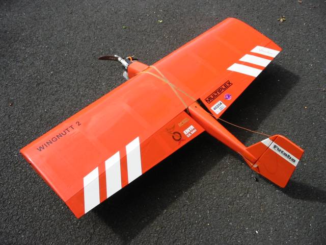

This is the only model on which I have ever used "reverse" differential. Own design Enya 35X powered flying wing. Dead easy to build and great fun to fly - who needs tailplanes.
