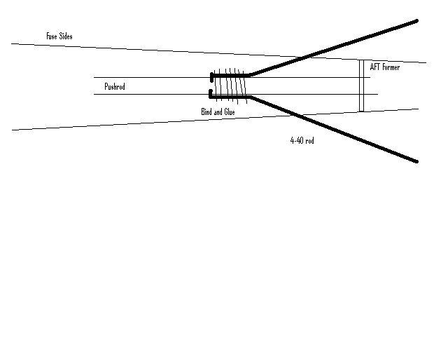

The best method I have seen was on a Sequel that Dave Guerin built back in the 90's. He used the standard arrow shaft pushrod with two 4-40 rods in a Y format. The difference was that instead of coming out of the end of the shaft, he attached the 4-40 rods to the shaft on the OUTSIDE about 4 inches from the end of the shaft. He drilled two 4-40 sized holes in in the shaft where he wanted the rods to attach, bent a short L in the rod to lock into the holes, left about 1.5 inches or so straight before he bent the Y to exist the fuse. He bound the wire to the shaft with kevlar and epoxy??? Now you ask, why??? Remember the extra 4 inches past the Y, well the went into a former that had a precisely drilled hole in to support the aft end of the pushrod. The kept the pushrod from moving up and down or side to side. Of course you still need to make sure your elevator servo is precisely mounted to eliminate the angular deviations.
I try to mount my elevator servos laying on their side when using a y set up.
This probably does not make much since in words, but I dont have a picture.

JeffH,
That looks like a good idea although I’ve found if you plan the installation well, cut the exit slots correctly and use Great Planes plastic exit guides you won’t have problems with the shaft moving. I used fiberglass arrow shafts for the rod for many years until a few years ago when I decided they were expensive overkill and started using ¼†hardwood dowel.
I tested the concept by lifting my bench vice and then decided that it might be strong enough for the control surfaces.

JeffH..Great Info!!
That is the same method I'm familiar with but I never thought of doing the 4/40 rods on the outside and wrapping them...That is sweet!! I struggled and finally fit 4/40 rods once (just like raindave's experience from the other thread)...I really didn't like doing that...This external method should work Great!!!
Thanks for posting!!

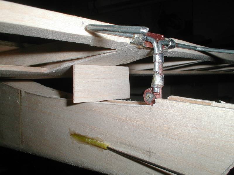

Gents,
Maybe interesting for you, my own design method to couple two elevators on the pushrod, as by my Taurus. So with central and intern connection!
Try to make a bras bearing with grease because after mounting it is not servicable animore.
This picture is taken before lowering and glueing the horizontal tailplane in position.
The Taurus do make nearly 400 flights now without problems on this detail.
Second picture Orion, about 150 flights, same linking.
These linking is used by Ed Kazmirski in the kits from Top Flite models Orion (1960) an Taurus (1963).
Cees

Hello David,
You often see, nearly always, may I say, that they use a pianowire connecting rod between the two elevator halves.
Then they make the lever, for the push-rod by solder on these connection rod. Yes do silversolder!!!!
Wrong.................
Try to realyse what's happen when the solderconnection of the lever disconnects!!!
Yes, The two halves of the elevator still have on there last meters through the air exactly the same position, nice to know but not effective!
So
Each elevator-half you have to connect with the push rod,
Each elevator half you must give its own lever, that is the only safe method. You can not let the live of your airplane let depend on one single solder connetion on the connectionrod.
But now you have to connect two levers on the same pushrod, that thrue, but that's no problem. But do use double security!!
Between the two levers you solder epoxy two side copper sheeted circuit board AND WRAP WIRE around (that's the double safety!).
The little circuit board surface on the end of the levers. Thats the place you solder a bras bearing that has a good fitting with the rod.
Remove the copper from the circuit board on the place you can see on the picture.
This is my methode to isolate (electrical) the metal of the pushrod from the elevator connectionrod!!!
You've ever see this before? No I do not think so, own design.
Go to the Thread of the Taurus of Ed Kazmirski and look for the second quiz!!!!
Cees

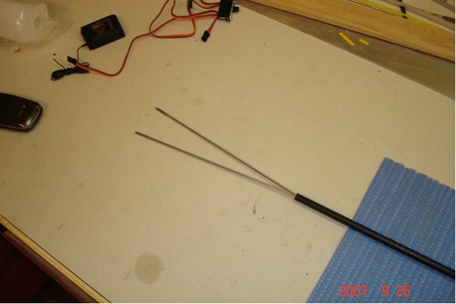

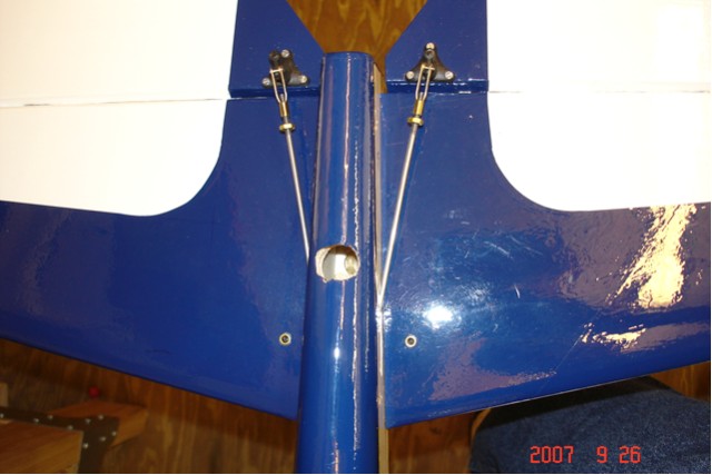

Here is my new method. (2) CF pushrods from Central hobbies, and AL Control horn. both pushrods go out from servo so there is no slop or flexing. CF is pretty light so not an issue. I used the ball links so ther is no bind and they go off in either direction without hassle. Still working on the install, kids take up most building time!
http://www.rcuniverse.com/forum/m_72...tm.htm#7246813

This will work fine. 4:40 rods. Dave Brown pushrod's.
Crank
