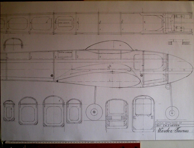

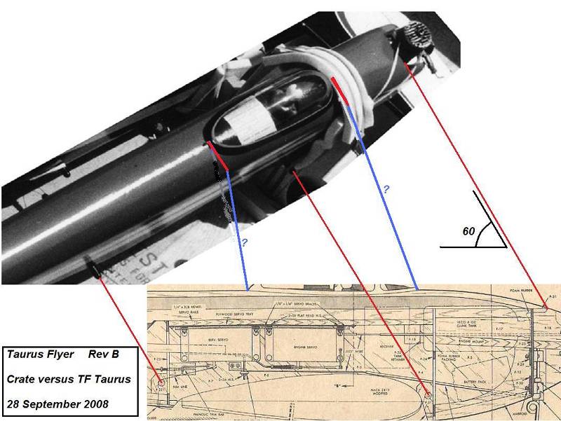

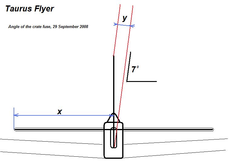

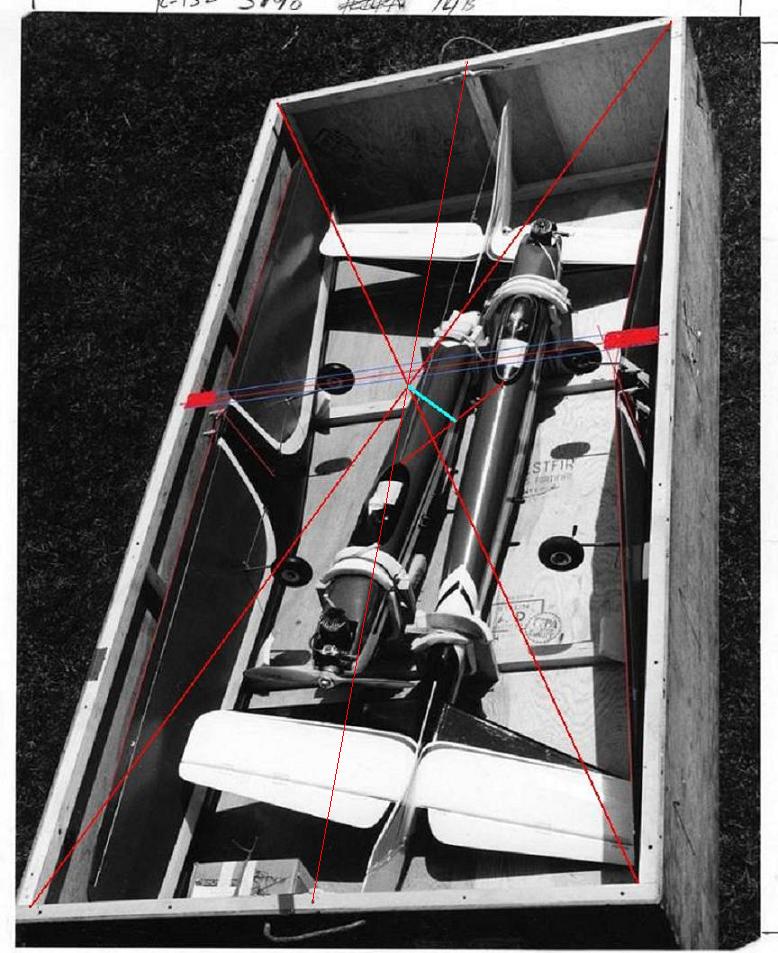

Gents,
Our thread about the Ed Kazmirski’s Taurus is long. Started on 25 June by RCDent it is nearly on the third place on the hits counter.
Many of you do have read that I am reconstructing the Taurus that’s visible in the crate that was used by Ed during the trip to Africa in April 1962 together with the other standard Taurus.
On that moment already it was the “back up” for Ed, no equipment was in the fuse, no antenna.
I do have a “high resolution” picture of this crate. And I am lucky.
With only this picture I nearly can reconstruct the complete original fuselage of the oldest Taurus ever exists.
Other pictures I mostly use I also show, black and white from Les Fruh and Ed Kazmirski after the first modifications of this first Oldest Taurus on Earth.
Paint scheme but also some distances I did check with the pictures and a fuse of the e-bay auctions.
Ed must have used the Taurus, from which we see the fuselage on the right side in the crate, in 1961, in the period we heard the first time about the Taurus.
Maybe this original was also the eye catcher for Top Flite to kit the plane later.
What can be the thread?
The complete reconstruction process with pictures of the drawings I already show some of in the other Thread, simple calculations (mainly CG check) and construction pictures of the this Taurus.
Next year, Report of the first flights with data logger and measurements.
Proving of the flight characteristics of the first contest Taurus from Ed.
To give the Taurus in this period a recognizable name :
WESTER TAURUS.
If there are members interested let me know and I’ll make the show.
If not? No problem, I will continue the process back stage.
To make you enthusiastic, already some pictures.

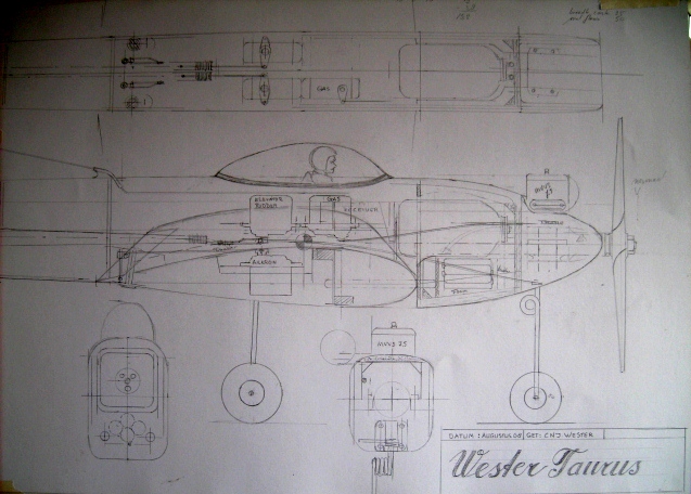

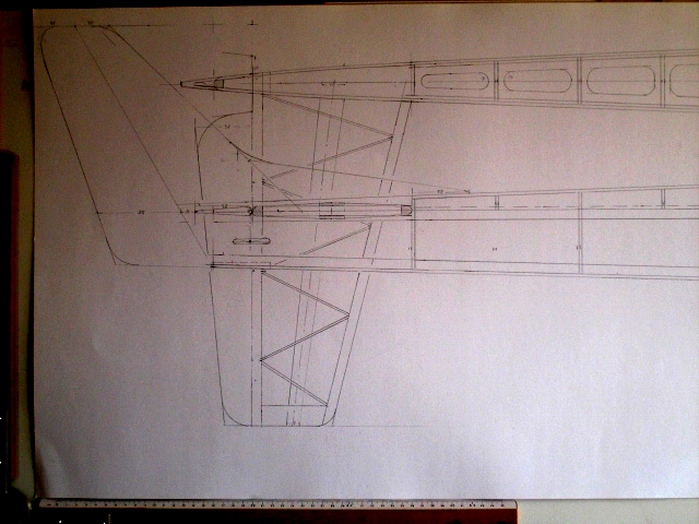

Gents
Construction drawings with feasibility study of the CG.
The construction drawings are nearly complete, so it is possible to make a first calculation and see if the normal position of a CG is possible without any balast.
From every piece of material I did calculate the weight and measured the distance to the CG.
To keep the calculations simple we can assume the cg is not influenced by the wings.
De weight of the main gear on the wings behind the CG, makes the wings neutral, I did check this with my own wings of the (TF) Taurus
Calculation of the sum of weight *distance (torque?) of every part of the tail section has to be the same value as the sum of torques of the nose components.
The sheet calculates the ballast that had to add in the nose (positive), or in the tail (negative) to get a CG on the right position.
First impression is, it is possible with light building techniques of the tail to get the CG on the right position. The yellow values I already manipulated to get this right CG. This will be a continuing process during the building of the prototype.
All the parts that are not in the calculation listed are located around the CG so neutral.
Calculation is with empty tank.
After the fuselage is completed, the new set of wings also will be calculated to reduce also the weight of the wings. I thinks it’s possible to reduce the weight of the spars and ribs, so the new wing get “spare ribs on the spars”!
Cees

To bring others up to speed, (and avoid having to read the whole 31 page Taurus thread), Cees feels strongly that the fuselage on the Taurus on the right in the crate from Ed Kazmirski's estate was the oldest Taurus constructed, and is the same fuselage as the one recently auctioned as the Taurus-2. Later according to Cees, Ed changed the stab and made it much thicker. Ed also designed a very thick wing with a straight trailing edge for this fuselage known as the "carrier wing", (note picture from the aircraft carrier). Even later, Ed went back to a traditional Taurus airfoil...still with a straight trailing edge, and changed the fuselage again to allow proper fit. I have the Taurus II fuselage, (the one Cees feels is from the oldest Taurus). There is evidence the fuselage has been modified for different wing shapes, but to me, it appears the thick wing was the original wing, and the thinner traditional airfoil wing with the straight trailing edge came later. This wing fits the fuselage now, as the pictures show. This wing had a different striped paint scheme. He flew this Taurus II from approximately 1964 on. There are many pictures of it. I'll include a few of the pictures so you can follow the history.
The Wester Taurus has the same look as the Taurus II fuselage, (which is slimmer, trimmer, and 1/2" narrower), but with the original stab the fuse in the crate had. If you look closely, the vertical fin shape and rake of the Taurus II is different from the fin on the Taurus kit. I don't know which of the fins Cees uses on his Wester Taurus. A traditional wing goes with this fuselage rather than the taper wing with straight trailing edge.
So the Wester Taurus is a slimmer, trimmer, Taurus with a traditional wing that as closely as possible approximates the Taurus on the right side of the crate.
I hope I have accurately reflected the gist of Cees's arguement. According to Cee's theory, this is the very first Taurus designed and flown, but it is his theory...it was not proven conclusively to all of us. Some still feel a version of the Taurus on the cover of the January 1963 MAN, and the Taurus of the kit was the first Taurus design.
Cees may be right, but people need to know that not everybody agrees with all his conclusions from the other thread. It is not my intent to say he is not correct, just to inform others that there are other ideas out there.
The Wester Taurus is a handsome aircraft, with a slimmer, trimmer body that will likely be lighter than a standard commonly known Taurus from a kit. I believe Cees referred to it sometimes as Ed's "contest Taurus". It is certainly worth building and flying, but is it "the oldest Taurus on Earth"....I think "the jury is still out".
Duane

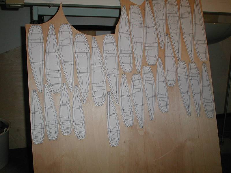

Gents,
It is true, Duane wrote, it is a product of my theory, but we can talk a lot about it and on the end of time we still are not sure and have nothing.
That’s the reason I make a model. Because I am a model airplane builder.
So, this time my project is a scale model! Scale 1:1, just the original plane was 69/70” span.
On the end of the process I can make a picture and see the differences with the plane in the crate.
My reward will be a nice plane that I can call a Taurus, because all the separate parts are all from Taurusses.
Maybe on one moment in the past all these parts really were a Taurus all together, the Taurus that did make his first flight on Thursday, the twenty-third day of November of 1961. Who knows?
A last word:
There is a remarkable and visible detail on the fuselage on the right side in the crate, and that’s the lower thrust line of the K & B engine on the right.
Second detail is that the fuselage on the right side looks “longer”.
That are my motives, so, no more debate, designing and building, that’s my hobby.
SOME DESIGN WORK, THE WING.
My way of construction with pictures of a wing I did make in the past.
1 Picture of the excel program I do calculate the profiles.
2 A picture of the total sheet to calculate all the details of one profile.
3,4 and 5 Printed profiles, glued on plywood, a picture of the Taurus wing in the past.
For the Wester Taurus I want to use balsa plywood for the ribs so calculation of the weight I have to do now and making examples of a several ribs to weight.
Just for who is interested, and it is what KLXMASTER 14 did write in his post about the Vertico II:
“It is fun and interesting to introduce technologies that did not exist back when this aircraft was originally conceived”
Cees

Results:
See picture 4.
Blue markings are the results. Green circles do mark the distances to check. Red so it was, blue the positions it has to be when compare with the crate picture.
To get this result I had to change the drawing of the fuselage near the leading edge of the Wing. I did make a former near the LE of the wing and also a other position of the dowel , lower in the fuse. So the front dowel I already did give a lower position, but we see on the measurement, not yet enough.
(When compare this with Taurus II, we also did find remarks of something like a former on the same location!)
Before I really change the drawing I do check all the values again and measure the distances of the crate picture with higher accuracy and more calculation also with the rasters.
Of course I also check my results with other drawings so also with the Top Flite Taurus. Because it is always possible to find another result but!
Look at picture 4, my drawing pencil gives the line of view of the dowel near the TE of a Top Flite Taurus in this situation when compared with my markers!
Picture 5 I did draw the lines of view with the backside motor compartment and dowels as markers on the drawing of the Top Flite Taurus and compare the drawing directly with a part of the crate picture.
I only can find the right ratio of distances between them on a angle of around 60 degrees!! So this is not a reel situation and I also cannot find back the canopy.
So nothing is really proved yet, but it seems impossible the fuse on the right side in the crate looks like a Top Flite Taurus fuselage.
Last remark is, all the measurement is going within small tolerances and my opinion is already the K & B probably has no down thrust when I recalculate the point of view of the cylinder head ( I have no degrees left for the engine!). Probably that will also be my experience when flying the plane in the future
So, you all have to know I am always still prepared on a disappointing result, and also then I will let you know, but, I still can go on with my study with a positive result. When somebody sees a mistake please give me a sign to check and I hope I can correct.
And if I cannot? My Wester Taurus will crash!!!!!!
I can tell you also this is as exciting as building and flying a Taurus because it really seems to be possible to create this Taurus. Construction starts this week most of materials are present.
Cees

Hello Crankpin,
It is good to read your reaction, otherswise it feels like a acrobatic show without a safety net.
Like to do the job, but also every solution gives new challenges and insights how to lose the next problem or how to enlarge the accuracy.
After the changes on the construction drawing I consider to do the final measurements again. But in that situation I probably place the construction drawing under the small angle, about 7 degrees, we see the side surface of the fuselage in the crate. I also can copy the curvature of the side surface.
The way to calculate the angle I show you on the picture. These extra corrections gives no complications to do.
I also consider to use my little laser beam and maybe a mask with holes to replace the crate picture.(or holes in the picture himself if I can get a big print-out.)
Another possibility is also probably using a slide projector.
So still a lot of possibilities to enlarge the accuracy.
Second picture is a rev B of the picture of last post.
When I do the job well, I have to project every point in the same/side surface of the fuselage. It also makes the principle more clear.
This does not make the result better, but worse. So this does not change the conclusion!
Cees
