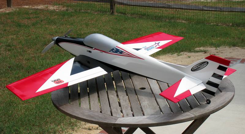

David,

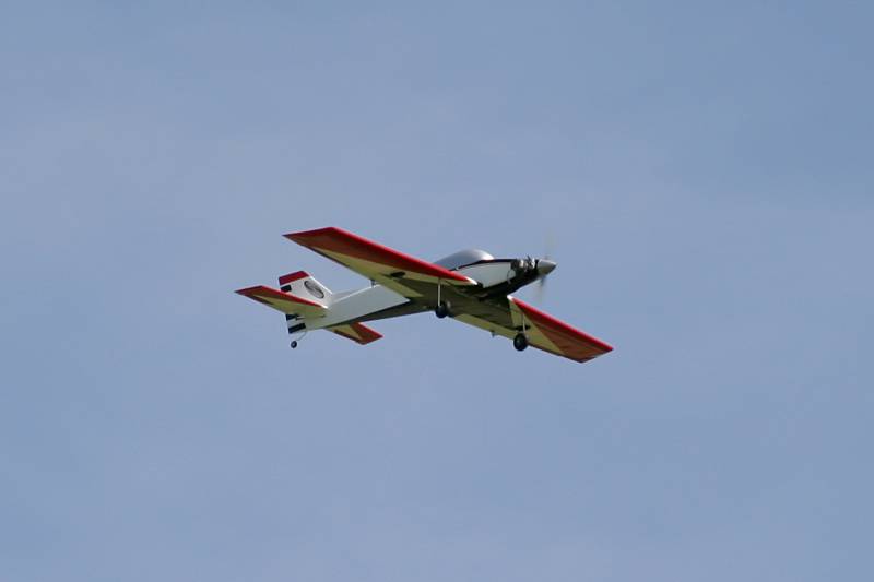

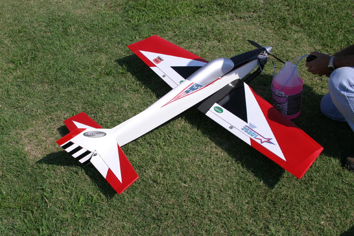

Promised you a few "in-progress" photos of my Tsunami. Taken earlier today, here they are. O.S. .55AX in the nose, Coverite wing covering, 3/4oz fiberglass over the fuselage and the control surfaces. Just about ready to paint, after I get done painting the dining room.
Greg
Greg

Saw the video of your Tusnami flight and was VERYimpressed. Hope mine performs as well. Had to shoehorn that .55AX into the nose of mine, and it probably still won't stay with yours in the verticals. I'm really dumb about electrics. Maybe I'll try it someday... or not.
Greg

#166
Joined: May 2008
Posts: 759
From: Foxfire Village,
NC
David,

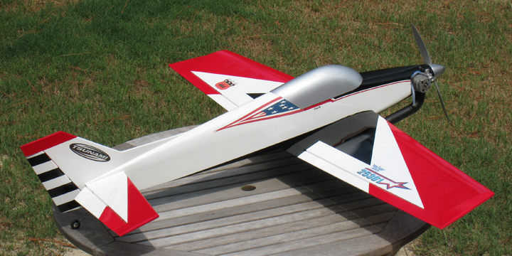

Here she is... added 3/4" to the main struts and bumped the wheel size up to 2.5" to provide clearance for the 12" prop and good handling on grass. Still installing radio, but she'll be ready for her maiden voyage soon.
Greg

#167
Greg,
top notch - she's a real beauty! Congratulations and good job on sticking with the project despite its setbacks.
Yours will probably be Tsunami #2 to maiden. I'm not sure what I'm procrastinating on (oh right... the pipe). I have to check my to do list and get her airborne. Right now I'm pretty psyched about getting the little 40" Tipo on the wing. So it goes, the most recent project is the first to leave the nest...
I'd be interested in seeing your radio install if you have a snap or two.
Make sure to give us the full report. 55AX... 'twill be scary. [:-]
Here are the latest shots I took of her a few days ago. I almost got her finished. Of course, I had to go make dinner.
In any case, nice to have them beside each other in the posts. A couple of the Pico as well is hopefully not too brash of me.
David.

#168
Joined: May 2008
Posts: 759
NC
David,
The Pico is gorgeous as I would expect from you. I'll take a few shots of my Tsunami radio install as soon as I've got it done. I had originally planned on "tinting" the canopy, but my cheapo paint sprayer deposited a big blob of paint on the inside surface. Removing it created streaks that are permanent, so I had to spray paint the inside of the canopy. My "Pilot" figure (Snoopy flying his dog house) will have to wait for another project. While bending the replacement landing gear (to get that additional 3/4") I broke my very old wire bender so I had to order up a new one and the Mark Twain Hobby Center came through again. They are really fast, ordered it Tuesday morning - they shipped Tuesday afternoon - FedEx delivered it Thursday (standard FedEx Ground - not Priority). I'm just a customer - (no other interest in this company) but I appreciate exceptional service and they provide it.
When I finish this airplane, I'll have to lay off the building for a little bit. Too many honey-doo's have piled up.
Greg

#170
Greg,
nicely done on the tail. I like those DB control horns, they look very solid and blend in with the surface nicely. Are the elevator horns DB as well?
Hey, I just noticed the dorsal fin on your plane! Is this part of the latest plans or was it an addition of yours? I like it. Nice custom Tsunami graphic too.
I've held off from attaching the canopy because I also planned on tinting it with Pactra spray tint (a Hazmat product so difficult to obtain...). After looking at the latest shots, I think I'll leave it as is. It's in keeping with the model's gleam scheme. I guess no more excuses to not attach it permanently.
I'm glad you like the Pico. Right now, she ranks quite highly in the shop!
Thanks for your kind words.
David.
David.
#171
Joined: May 2008
Posts: 759
NC
Thank you for the kind words David. The dorsal was my own addition, but I really like the look of it. I also printed all the graphics you see on the plane on decal paper. I sprayed a clear coat of Klass-Kote over them once they were applied, as well. I didn't design the Tsunami graphic however, I found it on the net and "borrowed" it. I had several possibilities I was considering, but the design element for the one you see won me over. The rudder horn is DB, the elevator horns are GP. I think I like the DB design better, but I'm not crazy about that long connector arm. My canopy will be permanently attached today. Looks like tomorrow will be "maiden" day. I will be so glad to get this thing into the air. Will try to get some in-flight photos and report how it went...
Greg

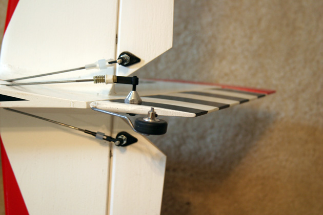

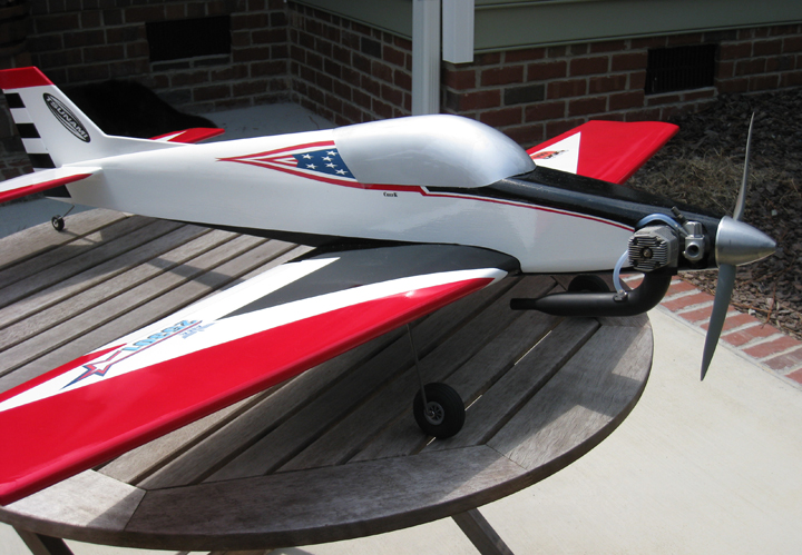

Greg

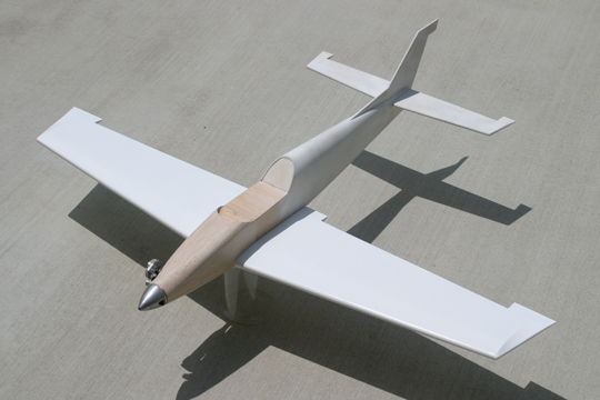

Gents,
although this is clearly getting ahead of myself (i.e., not having maidened big brother yet), I thought you might find the following tid bit interesting:
I've started work on a 75% scale little TsunamE. Although it probably already exists as a name for a model, I'm considering calling it the Vortex. However, I am open to better suggestions. Inspiration came in part from Frank's excellent flying electric Tsunami, the availability of a 300W motor which needs a home and the desire to build one of these pups with retracts.

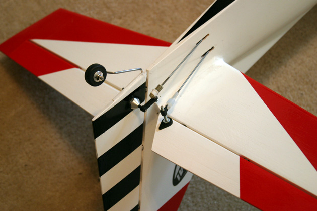

Here are the specs of the model I'd build:

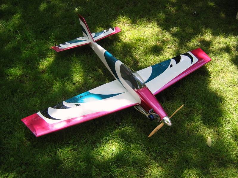

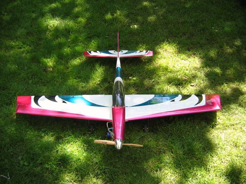

[ul][*] ~75% scale[*] 43.25" Total Wing Span[*] 40.00" Effective Wing Span (not including tips)[*] 310 sq in Wing Area[*] 18.40" Stab Span[*] 36.75" Total Fuse Length (including spinner)
[/ul]
Other features would include:
[ul][*] 10 size GP Mechanical Retractable Landing Gear[*] 1.75" DBr Lectra Lite Main Wheels[*] 0.75" Steerable Tail Wheel[*] Removable hollow canopy formed from blue or white foam

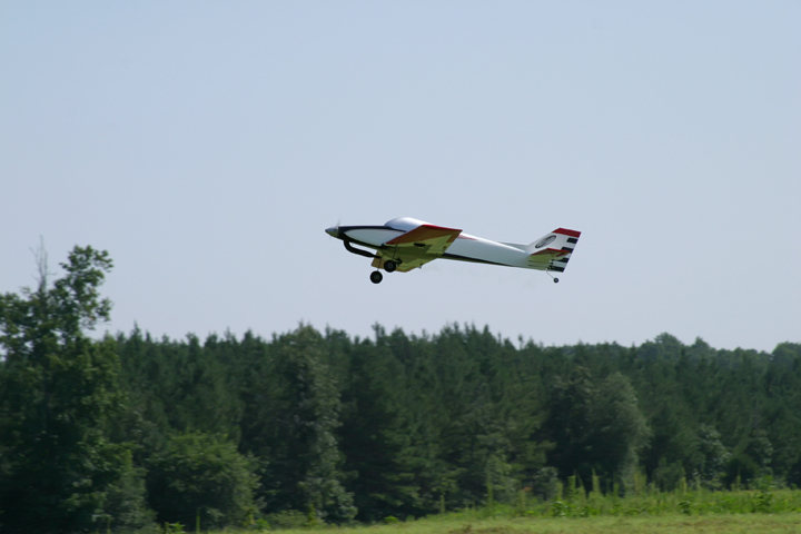

Two flights on the Tsunami today. It is definitely HOT and goes vertical like there is no end. However, was surprised that the ailerons were not more sensitive. Rolling maneuvers are too slow at this point. Gonna have to jack them up a bit.
Greg
