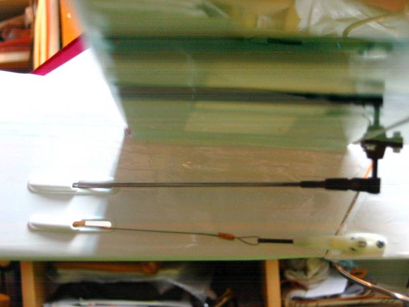

Hi Greg,
excellent news! You must have managed to solve your wing problem. I was just thinking about those cores a couple of days ago.
As it happens, I just installed the tail linkages the other day. My setup is very similar to yours. I'm using the supplied 1/4" dowel rather than an arrow shaft as I made that pushrod back in the late '90's. I'm also using a forked pushrod. Ihave an EZ link at the servo end but Ithink I'll replace it for a ball link. For horns I'm using something very similar to MKhorns (actually they're from airborne models - quite nice).
For the rudder Idecided to go with a P-P system so there are no other pushrod in the fuse rear other than the elevator. Things get a little narrow in the back like you say and Ididn't want the two rods rubbing agains't eachother (even though that should be fine). P-P is also quite light. Iused a Sonic Tronics (originally was going to use GP but it's heavier) P-P linkage and horn (which I have to adjust because the right side is a little lower than the left). And, yes, the horn is quite low. Iplaced mine in the FG bottom area covering the tail wheel wire as this provided a little more meat. However, with a P-P setup, it might have been better to locate the linkage, albeit less aesthetic, above the stab centered on the rudder limiting any adverse torque on the rudder at the upper end. I think it will be fine as it is though.
The setup is not too challenging. Ibelieve Ilocated the pushrod exits where the plans show (Ican't recall if the plans show exits). Bringing the exits forward of the stab makes the linkage to the elevators more linear (less angle to the clevis rods). Iused GP pushrod exits to make things look a little nicer and to provide a smooth exit. The pics below should tell the story (sorry for the streaks in the pictures - my camera has been acting up).
David.

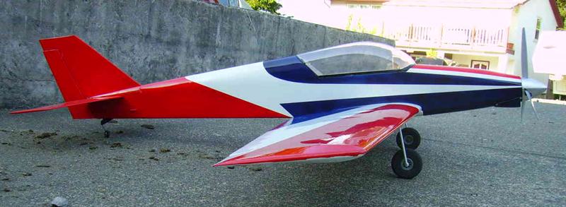

OK, I'm guilty of posting over on E-Zone and forgetting about this thread. My Tsunami is almost ready to fly. Just need to make and install the pushrods. All up weight, with battery ready to fly, is 3.75lbs. Yup, beat the 4lb mark by 4oz. With my power system, that works out to 173W/lb. If you don't speak electrons, that means unlimited vertical approaching rocket ship performance. Should be a blast to fly. I've attached a photo of my original Tsunami with Webra .40 and tuned pipe circa 1997 (with my daughter), and also the same daughter 12 years later with the new Tsunami (or should that be Tsunam-E?)

Frank,
beautiful reproduction! Thanks for posting some pictures of your epsilon-Tsunami here.
60 oz AUW is outstanding and with 173 W/lb you won't need a runway for takeoff - you can simply point her straight up, stick forward and watch her head for thin air!
Your wing loading will also be ~ 60/3.8 = 15.8 oz/sq ft!! For a 58" span model, it will be something to watch. I came in at 80 oz AUW (5 lbs) but considering it's unmodded, I'm happy. I'll be flying at 21 oz/sq ft and around 160W/lb (~800W). I'm still considering building a foam core wing with retracts which should change things... just a tad.
I'll have to take a picture of the model with my 4 year old daughter... perhaps I'll find myself building #2 in 2020! Oh, it looks like your daughter is holding a JR Century 7! I've got one of those... kewl radio!
David.

<table width="100%"> <tbody> <tr> <td width="90%"> <div class="smallfont">Maiden Report</div> </td> <td width="10%" align="right"><!nd of show warned sig></td> </tr> </tbody></table><hr size="1" style="color: #a7a7a7" /><div><!essag></div><div> Well, that was the easiest maiden I've ever flown. I slowly advanced the throttle, and at about 1/2 power she took off smoothly. It seemed to have lots of power, so I just left it at 1/2 and climbed out. I needed three clicks of right aileron trim, and that was it. In a word, it flies great! Very stable and tracks very true. Vertical is, as I suspected, unlimited. It will climb forever. Top speed isn't in the pylon racer category, but still plenty fast. One thing I noticed and everybody else remarked on too, is how quiet it is. You can barely hear the motor and prop. Most of the noise is wind noise over the airframe. It is really noticeable in the knife edge. Once it's on its side and the rudder is full over, you can really hear the air over the rudder. Neutralize the rudder, and all goes silent again. Loops, rolls, and any combination is effortless and true. Landing is a piece of cake. Line up, reduce power, flare, done. My 4th flight of the day lasted about 12 minutes, and I was using quite a bit of throttle for vertical maneouvers. The 3700mah pack was cool to the touch after landing, and took 2100mah to charge back up. So 15 minute flights should be the norm.
Not much more to say, she's a keeper and will be making a lot of trips to the field with me to just kick back and bore some holes in the sky. I didn't get any photos or video, but hopefully next week I can get out sometime again and will try to get some.
Compared to my old glow powered version, I would say this one flies quite a bit better. It has better vertical, and seems a bit lighter on the sticks. Slow speed performance is better, and it is quicker, too. And you can't beat the sound, and the look of that smooth nose without mufflers or cylinder heads sticking out.</div><div><! messag></div>
