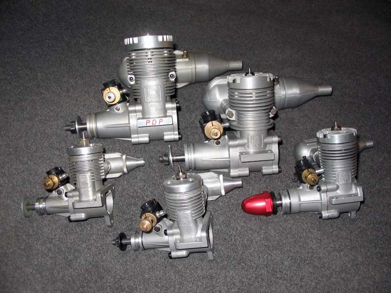

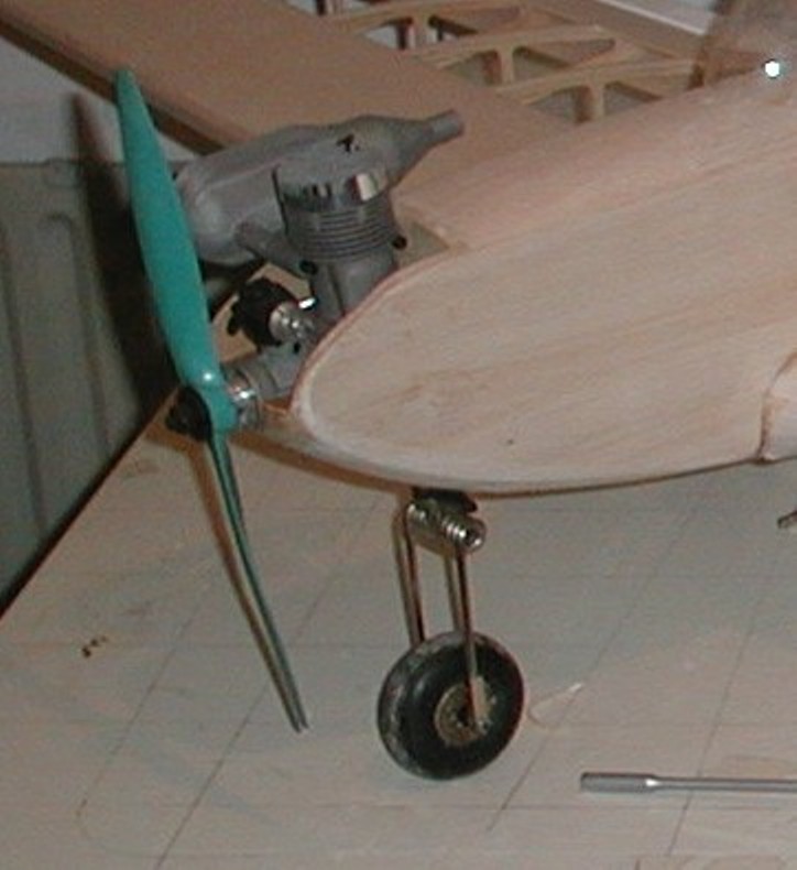

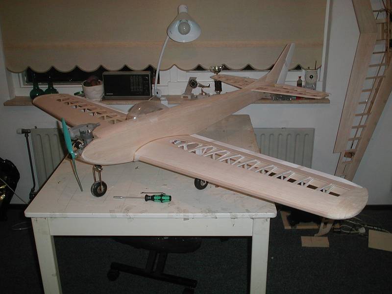

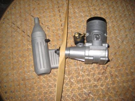

Rainedave
Standard HB non PDP vesion with muffler
The plane I don''t know?
Cees

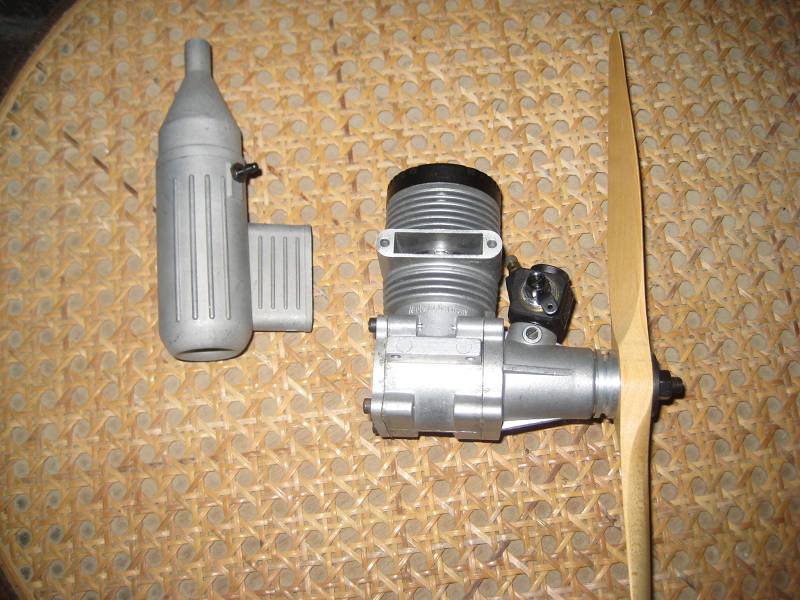

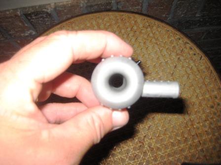

It has black letters and a black head, but has a flow-through muffler.

Thanks fp. That's a fifth version I hadn't seen. Yours also has the HB carb. The PDP versions shipped with Perry's. No problem finding a quieter muffler as the K&B .61 and Webra 10ccm mufflers fit.
David

I got this engine as one of three from the auction site. The other 2 are k&b 65's, one for use in my sons kadet, and the other to sell. The purchase also included 10 12oz tanks and 97!!! 12x5 props. I have not flown plane larger than a .15 in about 4 years, so it is a real change to be holding an engine that weighs more than the last two airplanes I built combined (a .02 lightest stick and a .049 blink). If anyone would like some props or a tank or two, just let me know!
BTW: Is this a good prop for pattern? I am out of my element when prop selection goes above 11".
Thanks for all the replies!

That's probably not enough prop for a piped .61. You would probably do better with something like an 11~8 or 12~6, 8 depending on how fast you want your plane to fly.
Terry in LP

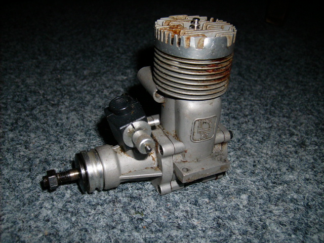

Rainedave,
From of this moment 6? Do not know the fp's photo's.
Cees

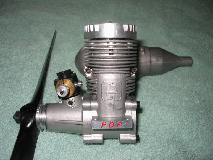

Cees, that one has the older style case with the cross-flow bulge more apparent. It looks closer in date to the red head versions I've seen.
My .61 PDP has fins on either side of the bulge.
Is there a seventh version?
David
