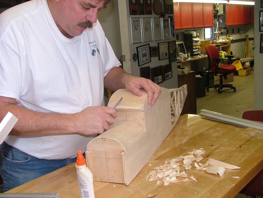

Thankfully Phil has come to the rescue of this project and is now building a 20 size Tiporare - the certainly infamous Nanorare!
He will be building a 4%+ version, the Nanorare+ as discussed in this thread. The fuse is scaled to 78% while the wing and stab will be 74%. This model will present more like some of the current squarer pattern planes except that it will be sleek and fast rather than bloated! Phil will build his wing and stab on a set of cores I cut in the past and are like the ones shown at the head of the thread. Perhaps he can highlight how he plans to power it and other details of what he has in mind for this build. This will be an excellent reference for this little bullet!
Below is the start of his build:
Phil,
Please do post pictures of your build. Every step is interesting to follow since many builders have never built a wood Tipo fuse. And as far as I know, no one has yet built a Nanorare (unless Don has sold some short kits of it) so you are in virgin, uncharted and excellent territory!
Below are some notes for other potential builders and perhaps they may be obvious to you Phil. Please use what's useful and disregard the rest.
For the fuse top, use standard 3/8" tristock. Be careful not to use the same wood shown on the plans - that is for the 60 size model! You must choose the wood appropriately for your scale of the model. Fuse sides should be 3/32", doublers probably can be 1/32" ply and tristock should be 3/8" above and 1/4" below. I can't recall the thickness of the rudder at the LE but I suspect it is 1/4" which means that you will have to use a 1/16" keel in between the fuse sides when you join them at the tail. This way, if you add the two fuse sides ( 2x3/32" = 3/16" ) plus 1/16" keel will give you a 4/16" or 1/4" thickness at the rudder hinge line.
The fin and nose section - top and bottom - are the hardest part of building any Tipo. If your fuse sides are correct and identical and you jig your construction, you will end up with a sleek and straight fuse - very critical. For the wings, I would now recommend to install the wood TE to the cores after they have been prepared for retracts and servos, and then sheet them with pre-sanded cut to size 1/16" contest sheeting. If you want to build very light and you have a good source of 1/32" sheeting, then go ahead and use that on the wings and stab. Keep in mind it is very thin so you will have little available to sand after the sheeting is applied. I'd strongly recommend using 1/32" for the stab if not for the wing. Once the TE is applied to the wing cores and they have been sheeted, you can then do the LE and tips making sure you tack glue the tips in place and then hollow them out once shaped and sanded.
The wing is sheeted and center joined with slow cure laminating epoxy. The wing panels should be identical mirror images of each other prior to joining. Make sure you cut the ducts for the retract and servo leads before joining them! E-Flite electric retracts are stronghly recommended but Spring Air 603 pneumatics can optionally also be used at a not insignificant weight penalty.
Wing should be mounted and aligned square and level to fuse and the stab should be installed and squared up and leveled after that. Incidence and diehdral/anhedral is shown on the plans and made reference to in this thread and perhaps in my little Picorare (40" span Tipo thread). Nose gear, fuel tank and engine should be ideally planned for and installed prior to fuse assembly. Proper down and right thrust should also be built into the model via the firewall and spinner ring.
Well, I think that's a start. Your model should come in weighing in the 48 to 56 oz range all gear up and finished.
David.

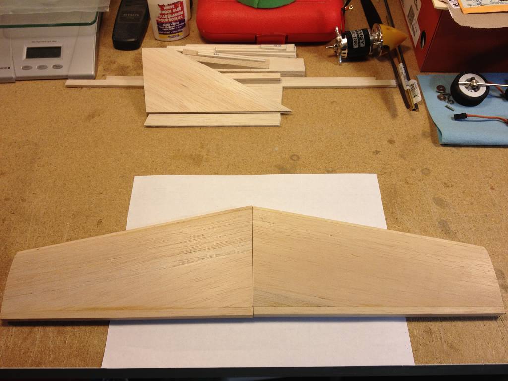

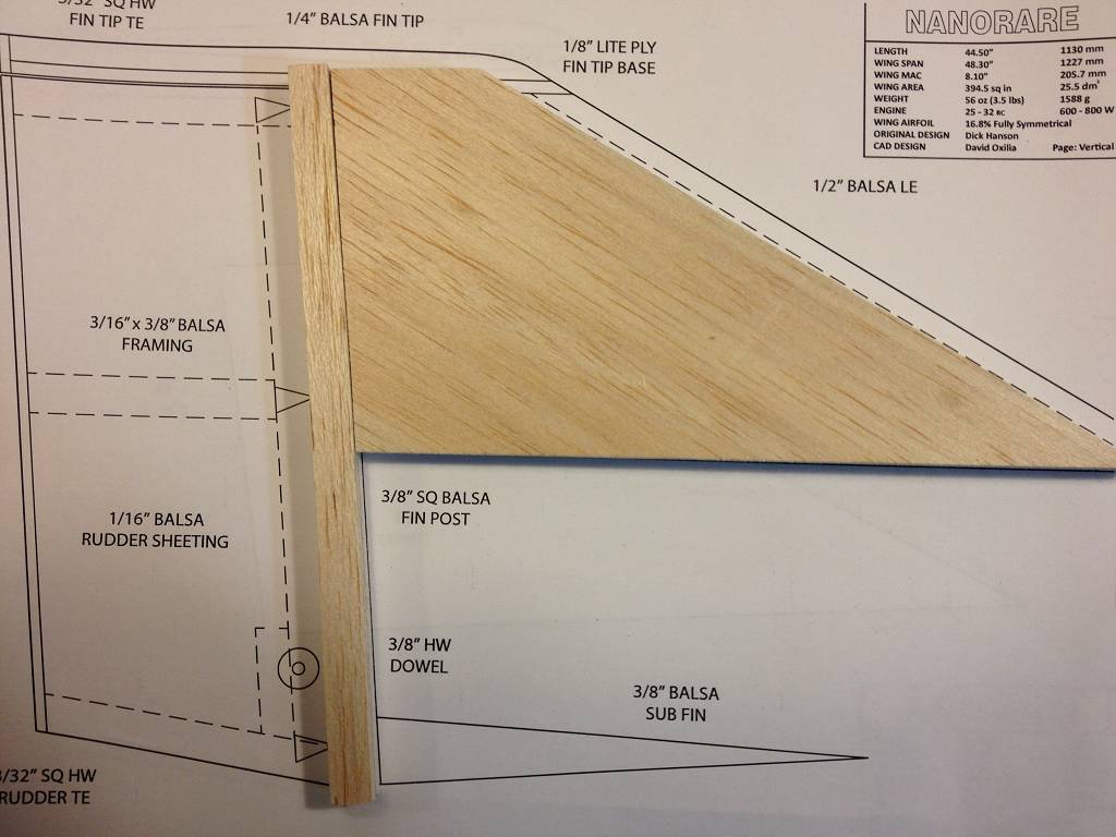

Well,
in the resurrection of a thread, some pictures and posts are usually required so here's where I'm at.
I managed to get the first of two fins and rudders framed up. The first picture shows my modified "flat base" Tipo vertical design which will integrate seamlessly into the new CAD design I've made of the model. The new Nanorare, which in retrospect I'm glad I waited to build, will be of a full fuse CAD design and much lighter in construction than the original. Wing and stab will follow the foam core design and the model is designed around the available cores from Don at Eureka who took up the mantle with my scaled Tipo idea making cores available for each size. I no longer have any of the cores I originally cut except for those I plan to build.
I will be building two models, as I originally intended when I started the thread. I've decided to focus on Webra instead of OS power as the engines are shorter, much lighter and are power houses on pipes. I have a Speed 32 as well as a 36 GT on its way to me as options. All Webra's from 25's to 36's use the same small crankcase and are roughly the same in weight. The 32's are actually a tad lighter than the 25's as their sleeves are thinner. I discovered this to also be true with the Webra 50's which are built into 40 size cases and also have thinner sleeves.
The second picture shows the frame, rib and gusset parts to frame up the vertical. I cut parts for two verticals and am scratching them as a trial to see how I found the build process which is always a little delicate with a framed up small "ribbed" part like this. Third picture shows how I went about getting the angles right and insuring I would build a straight fin. I basically glued the fin TE vertically and centered on to the new fin post which extends down along the rear of the fuse sides. I then glued the rear bottom gusset to the fin base rib. By joining this to the fin TE and fin post, I ended up with the correct rake for the fin/rudder hinge line. I then added the top rib along with the fin sub-LE and remaining two gussets to create a frame using center lines on everything to insure I was plumb and symmetric. Satisfied with that, I added the 1/16" fin sheeting to one side to partly lock the frame in place. To complete the fin frame, I added the middle rib and sheeting to the other side. Sanded everything smooth and then marked, cut, glued and sanded the 2 x 1/4" soft balsa LE.
While that was drying, I ripped a couple of strips of 3/32" balsa 3/8" wide and glued them together to form a 3/16" x 3/8" stiff strip. This would form the "rib" structure for the rudder following the original design which works and is light. Basically you add a couple of these strips along the top and bottom of the rudder sheeting, then a strip along the hinge line and finally a third rib in the middle as well as a little doubler piece where the control horn will go to provide some material. Wait for everything to dry, sand the ribs to a sharp edge at the rudder TE and add the right side sheeting to the assembly. Once dry, you can sand it even and round off the base.
I need to add a little 1/16" cap to both the rudder and fin top as I sanded the rudder to fin top line rather than sanding the fin to rudder top line. The cap on the top of the rudder is nice anyway. Once that is leveled, I can add the fin tip which will consist of a 1/8" lite ply base topped with 1/4" balsa sanded to contour. Lastly, the fin tip and rudder TE will have a strip of 3/32" HW added and sanded to foil to protect the TE.
I'll frame up the other vertical, finish them both up and then move on to the stabs and wings while I wait for the laser cut fuses to come in. Both models will have electric trike retracts and approximately 700W of power each - whether electric or piped glow. Props will be 9x5, 9x6 turning in the 14-15K range.
All fin parts were cut from scrap wood from my laser cut Dirty Birdy kit.
David
