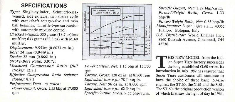

Some performance curves and specs for the Super Tigre S.61 (ring)

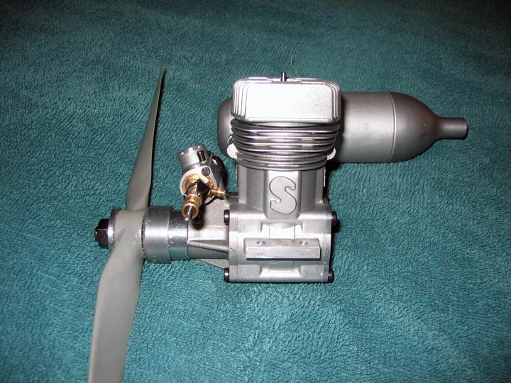

Thanks for the data UStik. What I'm primarily interested in is how the three ST's differ in power. This is problematic because of all the different versions of the Blue Head that Garofali produced. I have no idea whether the S.61 underwent changes during its production. I believe the S.61K remained the same during its lifetime. The BH that I have is one of the last versions; it has PDP porting, STS porting, a chrome sleeve and no baffle on the piston. It's probably one of the strongest BH's, too. Still, I would imagine the S.61 is stronger having Schneurle porting. But, is it stronger or weaker than the S.61K? At any rate, it looks to be a bit lighter (smaller head). I will tach my BH and S.61K with an APC 11x8 and a Top Flte Super-M 11x8. What I'd like to see is an rpm figure for the S.61.
David

Yes, David, I think Ray's posting gives you these figures, though without assigning propellers. The data I posted are for a BH with "Perry scavenging", what essentially means Perry Directional Porting, PDP. The textbooks show Perry porting with a baffled piston, and the engine in my book is baffled as well. (AFAIK, only Schnürle does without baffled piston.) I think the data could apply to your engine, particularly if it has a hard chrome plated steel sleeve. It should be one example of the long-standing G 60 series. The changes were made to the carburetor, the piston (cast or forged), the porting and maybe other things. That's meant to be the reason for the +/-20% differences in power. By the way, my book explicitely mentions that the G 60 was especially popular in the US.

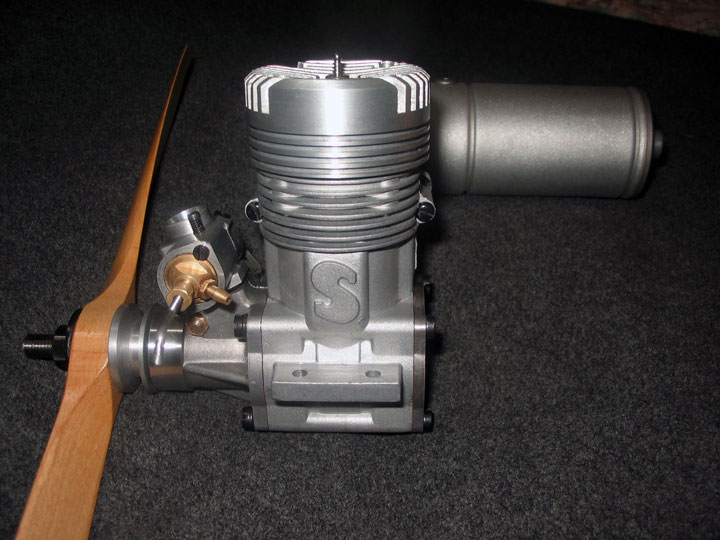

Prettner Calypso ARC...
The Modeltech ARC has arrived.
The ST S .60/.61 has arrived.
Macs standard header has been ordered. The muffler that came with the S .61 FITS on my NIB ST .60 Blue Head! An almost impossible muffler to find.
.60 size Supra retracts with titanium struts were in stock.
Would anyone be interested in a build thread?

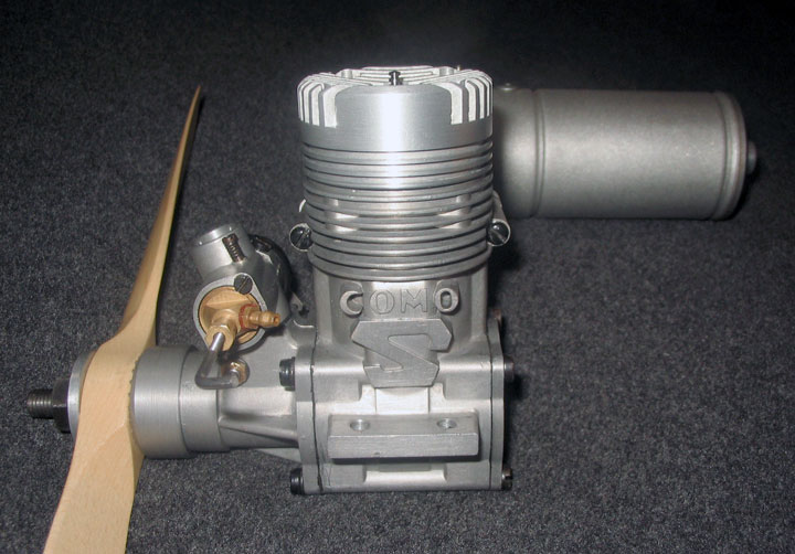

I came across this RCM review.
Also, I recently picked up a Como Schneurle .61 and an ST S.75. Both are roundheads of the same series as the ST S.61. The Como is basically identical to the ST and uses the same internal parts, AFAIK. Since BPA doesn't limit to 10cc, the .75 would also be a decent choice for a plane like the Calypso.
David

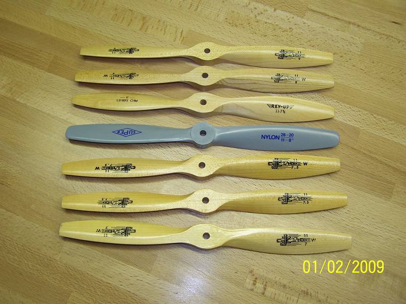

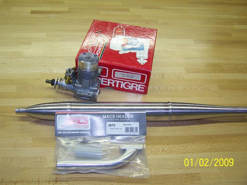

Calypso...information on Modeltech Calypso ARC
Props, power system photos
I was in Milwaukee a few weeks ago and stopped by a hobby shop with boxes and boxes of stuff from...the beginning. I found a Graupner 11" x 8" plastic nylon prop, a variety of JZ props and a Rev Up. The wooden props will have a few standard "mods" including the angled tips and blade thinning. A warm Saturday afternoon may allow a flight with each of the props and a caller with a notebook discussing the results. A tachometer for the purist, I prefer to just "fly" them.
The Buy-Bay found motor is as used by Mr. Prettner, header and pipe by Dave at Mac's.
The cost of the project is reasonable considering it was "World Class" in Hanno's hands. (Note: the Goldberg Falcon 56 MkII would have been in Hanno's hands as well.)
Modeltech Calypso kit $350 with shipping
Super Tigre s .61 $ about $150
Mac's header and pipe about $80
Original EZ Supra .60 retracts about $70

Nicely done Rusty.
If you are still interested in some Graupner props, there are racks/boxes full at my LHS - I just need to find the right sizes... They wouldn't have a clue where they are.
That looks like a marine double quiet Macs pipe - true?
