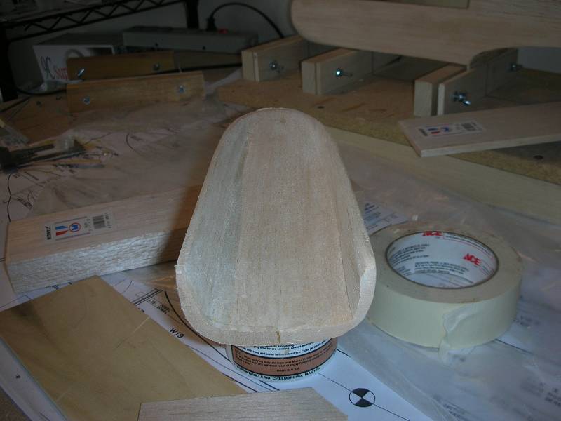

Well i got firewall glued in and mounted the m.m. to the f.w. and engine bolted down for now. The plans said the nose already had some right thrust built in so i added 1 degree of down, that can always be taken out with a couple of washers.
*edit sorry that they came out so big, and BTW i will use an FAI spinner

MJ,
I assume that you got the nose gear retract holes drilled - if you're going to use one - of course you are...
It can be a little tricky to get a drill in there once your FW is glued in place. Worse case scenario you might have to make a larger rectangular opening for the gear and access the FW through that slot. Alternatively, you could plan on a tank plate mounted gear. I'd recommend you "build this" before you glue the tank plate in place.

#34
No, i figured id do that when the retracts arrive, im pretty sure i can figure out a way to manage that(i hope) You are very right about the tank plate.

MJ,
I see. Well, I would consider going with a belly mounted gear in that case. It should be much easier than wrestling to mount a FW nose gear. As you've seen the tank plate is 1/16" ply so you'll want to beef it up at the FW junction. I would use 1/4" ply and just keep an eye out for where your tank plate needs to go in order to clear the 2" nose wheel. Note that the fuse bottom fore of the wing LE is slanted so this distance is not necessarily 2" and change. Then you'll need to space the gear from the 1/4" ply in order to make sure the strut spring clears the fuse bottom.

Thanks for pointing all that out David, i never thought of a belly NG retact, much easier than a FW mounted one i think..... the more i study the fuse the more it seem doable
