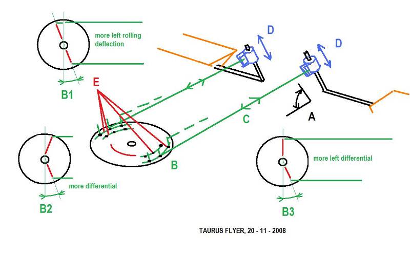

David,
You will know, but for who is interested.
I did make a picture that also with one aileron servo we can adjust everything.
A angle pre adjust differential (separately), see the drawing of the plane!
B1 adjusting the aileron deflection rolling more left or right (both)
B2 fine adjust the differential (both)
B3 if you really want it, more differential on the left side aileron ( adjust also D and C)
C adjust neutral each aileron (separately)
D adjust deflection fine (separately, adjust also C neutral)
E adjust deflection common
A profit of the system is, after I did check the servo deflection LEFT is RIGHT, I can see the setting looking to the adjustments. This never changes.
Cees

if pattern competition was limited to 4 channel radios with trim and reverse controls only i would agree. but most of these guys have mixes that i can barely even understand. rudder to throttle, aileron to rudder, dual and triple rates and on and on, they even mix mixes together. most guys make their adjustments from their radios. highlighting an aileron endpoint and spinning a jog dial is the way it's done these days. any competitor out there want to compete with a $79 4 channel radio? or a 30 year old Kraft. with a more simpler SPA plane you have a point but even most of those guys take advantage of modern computer radios.
david
david

MatallicaJunkie,
It is all for you, you did ask!
I did make a picture for you,
Difference in aileron position when you have flutter in the wing.
green with the torque rods, red with the two servo control.
Cees
Cees

MetallicaJunkie,
This was one of my posts.
Did you have have had an answer on that? No!
People did forget the things we did learn in the past.
Install the torquelinks, show me pictures and I will help you.
You have the material I know how to install. I am busy with the same part of my Taurus.
When we are ready you have a good mechanism on a way your Tipo deserves, do not throw away those materials.
Cees
