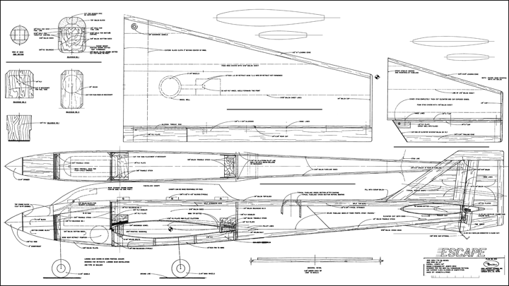

I cleaned up, re-arranged and added wing and stab core templates to my copy of the Escape plans. I also added a 6" scale to the title box.
PM for a copy.
David

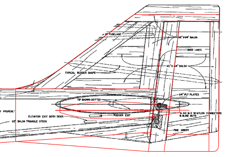

Here are the mods I made to my original Escape's
1-Install 2-1/2 inch spinner and contour nose to match. Original is 2-1/4.
2- 2 degrees of down thrust, about.
2-Raise F-2 at the wing L.E. 3/8-1/2 inch. These two items make the bottom of the plane look flatter.
3-Lower the rudder hinge post 5/8 inch. Requires additional fuse side splice.
4-Extend the front of the bottom dorsal fin so its starts directly below the fin leading edge where it attaches at the fuse.
5-Build the stab straight, install so the stab T.E. centerline is centered on the fuse height at the rudder hinge line.
6- Bottom of the rudder, make parallel with fuse top.
7- Remove counterbalance from rudder and install to fin cap to overhang rudder. 1/2 inch tall.
I have some pictures of the original, I need to have them scanned to be able to post. I'll see if I can get that done.
Bill

Old 12-16-2008 | 09:58 PM
rainedave's Avatar
Joined: Jul 2005
Posts: 6,344
From: Richmond, VA
Default RE: Escape plans
Thanks Bill. Take a look at what I drew over the plan in red. Let me know if I misread any of your instructions.
Edited to add one more image.
David

Old 12-17-2008 | 10:26 AM
Joined: Jan 2005
Posts: 116
From: tulsa, OK
David,
I think you nailed it, great job. I cant remember if I lowered the thrust line but dont worry about that. Do the original plans show how much down thrust is in the engine? I know we had to increase it just a little to keep the plane from pitching to the canopy. Of course we didn't have adjustable anything back then, dark ages. I will take a set of the revised plans if I can. Does anyone have a canopy to make a plug and mold?
Bill

Old 12-17-2008 | 11:08 PM
rainedave's Avatar
Joined: Jul 2005
Posts: 6,344
From: Richmond, VA
Thanks Bill. I drew the thrust line at neg. 2° which is what the plans show. What I posted was sort of a rough sketch until I knew it was correct. I am working on a final drawing now.
I finished the new fin/rudder drawing. This is really the only drawing needed. The nose and belly mods can be done by simply cutting a new 2 1/2" ply nosering and sawing 1/2" off the bottom of the former at the wing LE. The added area to the bottom of the fuselage sides is a straight line from the rudder hinge line to the bottom edge of the former at the wing's TE. My plans already show 2° of engine downthrust.
I can send this as a separate file to be used with the full plans. It is 20" wide x 12" tall.
David

Old 03-01-2010 | 08:09 PM
Joined: Nov 2006
Posts: 71
From: Co. Leitrim, IRELAND
Just found this, I think it is from the 1985 Worlds in Holland. Dave
