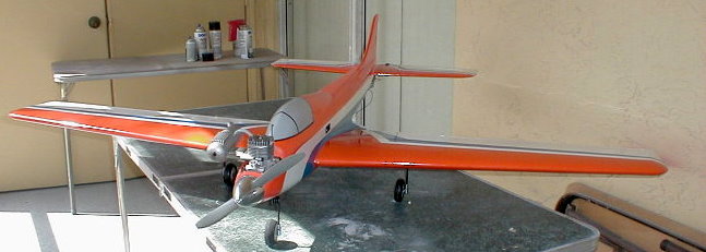

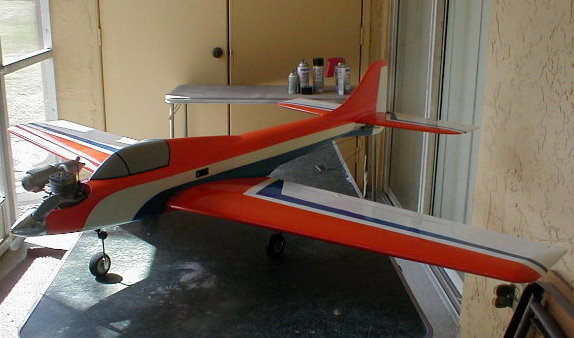

I finished my Super Chaos (short kit from Lazer Works) and built from the original Bridi plans and installed the old B&D pneumatic retracts. All I did was place a 1/4" thicker block under the engine and tank compartment and did more sanding. I was able to really round out the nose section and fair in tht spinner very nicely. The nose wheel when retracted sticks out into the airstream approximately 3/8". Other than that it a good set-up and no problem. I also have a 12oz standard Dubro tank and a floor between the tank and retract compartment. The nose gear is a belly mount set up and not a firewall mount.

Thanks Crashlander I think your idea is what I had in mind and the way I am thinking of going. By the way where did you get the B&D retracts. I am not familiar with that brand. I have some old springair but I need a control valve,which will probably go with a robart. I have robarts in my P-47 and Ultra Sport. Had these springair laying around and thought would use them in the new chaos, if I can get them to work and you have given me the answer. Thanks.

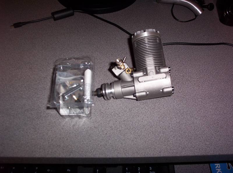

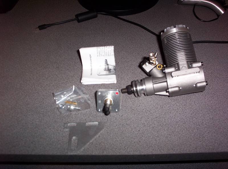

I Have been also looking at these regulators and was interested in the Webra version. Did you get any instructions/Diagram for setup? I see that it uses silencer pressure to regulate the fuel. Have you had a chance to run it? I understand that all three do basically the same thing but the webra and iron bay seem more refined. I'll be using one or the other on a Jett RE in the Atlanta and Beetle.

ORIGINAL: pitstop000
Hi Chuck
I Have been also looking at these regulators and was interested in the Webra version. Did you get any instructions/Diagram for setup? I see that it uses silencer pressure to regulate the fuel. Have you had a chance to run it? I understand that all three do basically the same thing but the webra and iron bay seem more refined. I'll be using it on a Jett RE in the Atlanta and Beetle.
Hi Chuck
I could probably scan them if you wanted a copy?? I have to get to bed now but sometime this week I can do it..
I thought you just used crankcase pressure but like I say I've not studied it yet...
It's pretty small..Here are some photos..
Chuck
