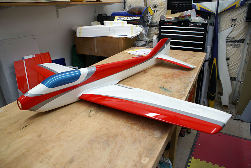

Wow! You HAVE been busy!
My own progress has been somewhat slower - although I hope to take a couple of days off around the holiday and move forward.
I found that some things need to wait for each other. For example I wanted to get the maximum length possible for the undercarriage (to clear the bigger electric prop I will need to use - most likely a 13 by 8 or 13 * 10) So I had to mount the nose retract - adjust it to maximum length, mount the wing and adjust the main gear legs so that it sits level - and all this before I could cut out the holes in the wing for the wheels to retract into!!
Also I did not want to fit the tail until I had the wing dowel and rear mounts in place so that I could bolt on the wing and carefully align the tail.
I have also spent some time on air ducting to ensure that the motor and speed controller get air flowing over them. I also spent time hiding away the flap servos (I love the effect of coupled flaps on square turns etc. and they really do cut the landing speed in half) - I mounted them on their sides under hatches just like the ailerons - neat - but it all takes SO long!
Anyway - it is all coming together now, although the poor chap who I promised to buy a canopy from has been having issues with his mold - so I still dont have the top block and canopy in place on the fuselage - and I still have a happy day of finish sanding ahead of me - although you will have that fun too right? I have heard that the Klas Kote (maybe Class Cote) epoxies give an awesome shiny finish.
I have decided to use monokote to keep the weight down, although initial tests indicate that I can pull well over 1500 watts from my motor - which equates to more than 2 BHP - so it should not be lacking in power!
I am going to copy a finish design that I saw on line - I have uploaded a copy of it here - It was a wonderful piece of work that was documented on line - but sadly met an untimely end - but I love the design - tell me what you think!
