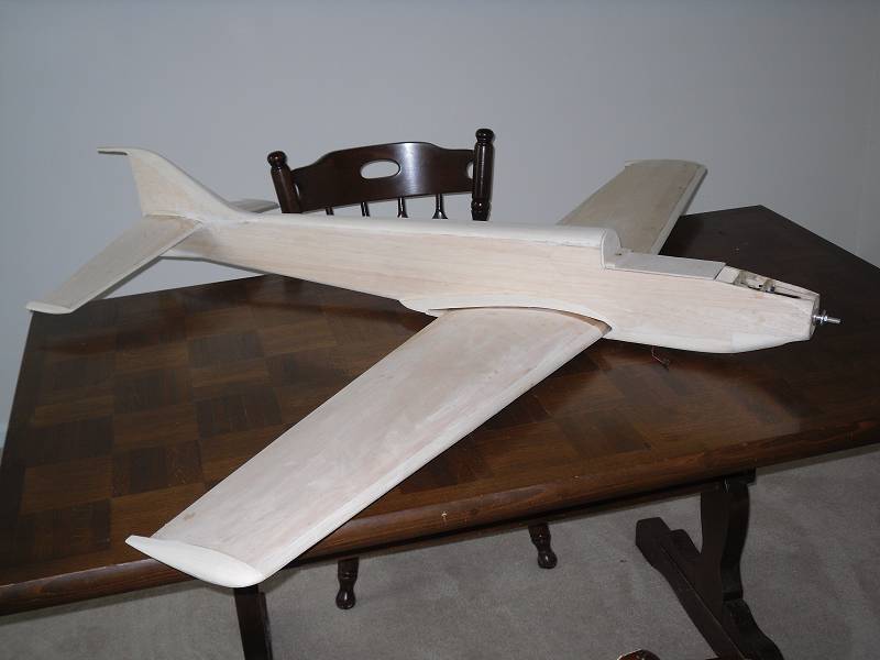

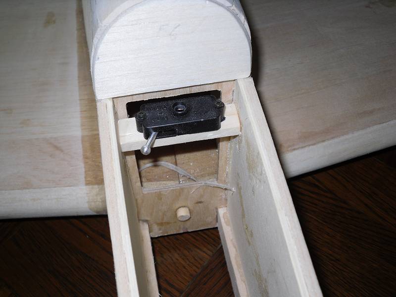

Here are a pictures of my Curare. I am very pleased with the canopy attachment method. I used a device made by MK called a "Magic Box" It allow you to positively retain the canopy without anything showing externally. Note that I dont quite yet have a canopy, but Leo is kindly helping me there and I will have one shortly
I hope to have a good "Sanding Day" this week (everything is currently just rough sanded to shape) and then proceed to covering.
Ed Lyerley has maidened his with outstanding results - so I cant wait to get mine finished.
I would love to see pix from you guys too! And yes, David Multicons are awesome arent they!!
Kevin

Kevin, wonderful job! She's going to look sweet in her colours - classic Prettner or otherwise? What electric setup will you be using?
I tell you, every other post, I discover another clever gadget made by MK - Isee how that one works - nice.
BTW, how's your unfinished weight with Multicon's? Foam core or built up?

Kevin she is look is looking very good. I am impressed with the canopy.Think I would like to do the same with mine but don't know how to contact MK. How about some help. Sorry I don't have camera to put photos of mine out but my grand daughter, who is a big camera bug, has promisedd to assist me when she returns from a summer camp in the next week or so. Will start painting today with Rustoleum. About half the price of Lustercoat. Thought about auto two part paint but decided I was not smart enough to use it plus the cost would have been upwards to $100 and then what do I do with all the left over. Color will be basic white with red and blue trim. Keep us posted.
#59
I just use rare earth magnets. For "standard" gripping power I use a nut on one side and the magnet on another. For "extra gripping power" I use magnets on both sides. Then there's nothing mechanical to fail.
Andy
