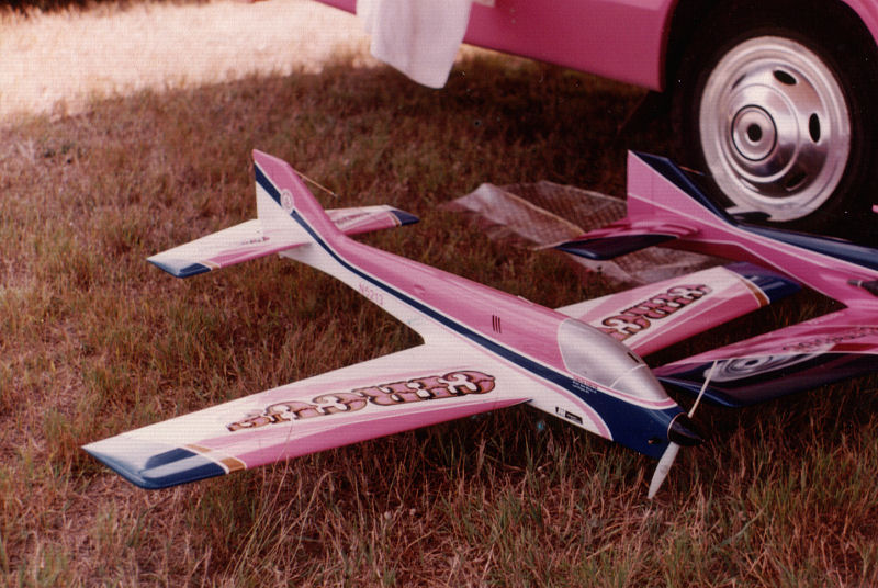

The Tiporare was based on Hanno's Curare. Dick Hanson (designer) and others (Dave Brown, Tony Frackwiac,etc..) all played a roll in the first Tiporare. The first versions of what was to be the Tiporare started to take shape around 1976-77. The first Tiporare had 680 sq. in. wing area. It was very fast! One could only build this Tiporare from plans.
The 2nd Tiporare (or also known as the Tiporare 720) is the one WK kitted. This version of the Tiporare was bumped up to 720 sq. in. wing area with a slight change to the tale moments. This change was mostly in the vertical fin shape. This Tiporare was/is a great compromise between speed and changing "pattern' maneuvers of the time. This Tiporare is the "famous" one of the Tipo line up. The kit saw production in late 1978 by WK hobbies (Bill Elliot). WK produced this kit up to (I believe) 1982-3. Then Great Planes kitted this for a while. The WK glass fuses are 10 times better then the GP one's.
During all of this... Dick Hanson was working on the next version of the Tiporare line while getting his own modeling company (DH models) going. This version is the Tiporare 750(or Tipo +). It came out in 1984. It could be ordered with the 720 wing and stab. The 720 wing and new stab. which was built with no anhedral and had more area. The 750 sq in. wing (double tapered) and original 720 stab or the new 750 wing/stab. The fuse was longer then the original and was narrowed a tiny bit. This version seems to be the rarest one of the Tiporare line up. Not to many people know to much about it. It was short lived do to changes in Pattern and also Dick was kitting this version himself. It is also the platform for the Hippo Tipo.
The Hippo Tipo was born in late 84. It was kitted in 85 and was around to the late 80's. I only seen one myself. It has a longer nose on the fuse along with a long tail section. More "meat" was added on it too. The tail moments were more squared off. The wing had 820 sq in. and was double tapered. The stab was built straight and the anhedral stab was no longer in the Tiporare line up. The fuse also had a pipe tunnel running down the side. It did not have the Tiporare sleek look do to this. This was also the 1st version that showed how to set it up as a tail dragger on the plans. "Long stroke" 61's engines were the top dawg and the speed part of pattern was coming to a end. To be honest... I didn't care for the look but it did fly well. I have been looking for one myself.. to complete my Tipo. collection since it is the only version I do not have. Many people know/owned/flown this Tipo.... just not many around anymore.
The last version of the Tiporare is the Tipo Surpass. It is designed to compete with the 4 stroke 91 pattern crowd. Looks like a early version of the modern pattern planes. Not really my thing... but still cool to have a NIB one.

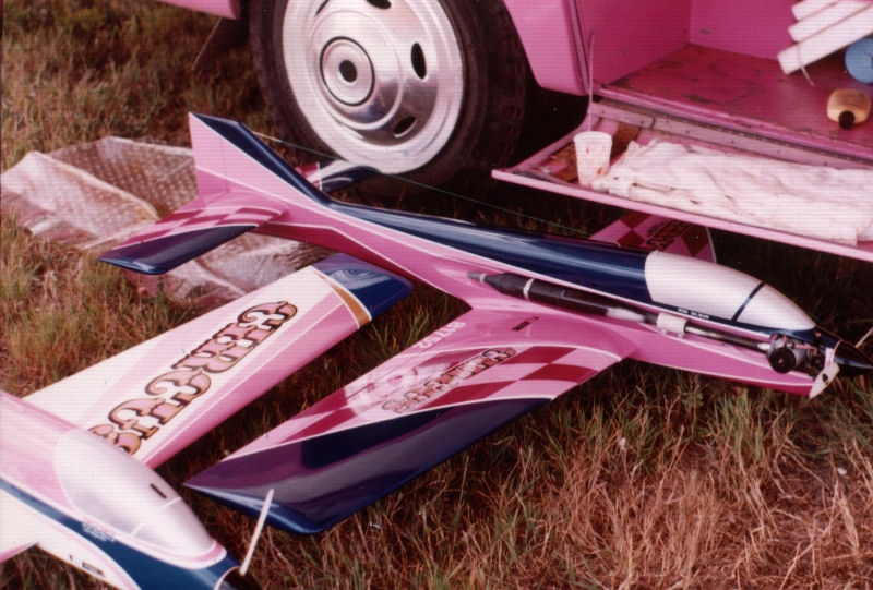

You are correct. I do not know the value of any of my old stuff. It is like I tell my wife: "If it sits for years and you don't use it or have even forgot about it...then it is junk"!
Who knows, after reading this forum and a few other threads I might like to build another " classic just for fun. I still have the old OS 58 that was in my Grapner Kwik Fli.
Pict taken in Feb 1970 After I got out of the Army

Nice looking Kwik-Fly. An Air Force buddy (we were stationed in Germany) was flying one when he taught me to fly RC (early-70's). A deBolt "Jenny" was my first RC model. You never know what the future will bring. I was out of RC for about 30 years and got back in about a year ago. Had to start from scratch except for the old Tiporare (and a couple of engines) that I hung onto and carried around in its box all those years.

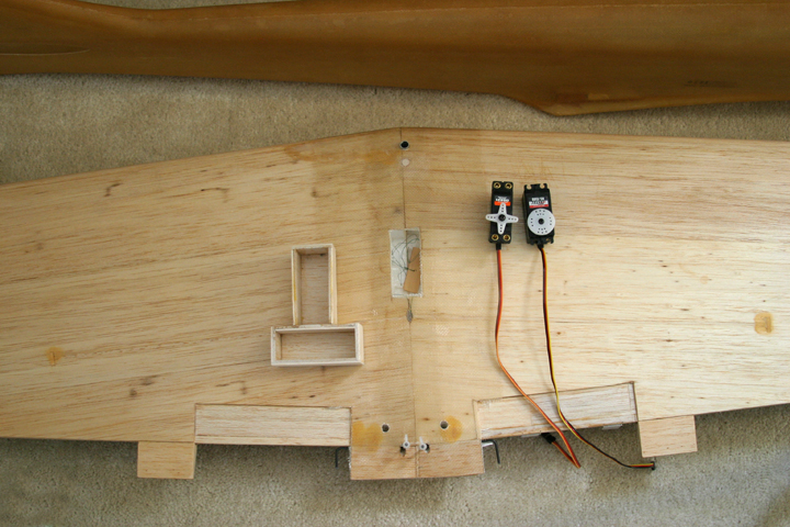

I seem to be hung up on installing the retract and flaps servos in the wing center section. I have concerns about weakening the centersection with too large a hole so my mind is working on figuring out what the most effective way of putting those servos in might be. I constructed a balsa-ply box to enclose both servos, but it just seems to have a very large footprint and would need a large cutout. I'm beginning to lean toward putting them both in laterally. What do you think? Any suggestions?

before commenting I'd just like to say that if any of these "other" Tipo builds (including my own) are not appreciated by you, please let us know. In my threads, I encourage exchange particularly if they are related to other builds of the same model but others may prefer to keep their thread more focused and dedicated to that particular build.
Greg, the first thought that comes to mind are the center sections one would see in Prettner's prototype models - notably the Magic. He used to fit 4 servos in there plus electromechanical mixers. Needless to say, the middle of the wing was barely existent!
I didn't see any pushrods emerging into the center section for the retracts but, obviously, if you need a retract servo in the wing, you're using mechanicals. I think this is the focal point of the installation. You'll want that servo installed where it needs to go. Also, I've found that the opening in the wing typically needs to extend beyond the width of the servo to accommodate the retract pushrods. Often this is done by cutting out a circle around the servo output shaft but only to a 1/2" depth at most. Some modelers (e.g., Dick Hanson) seem to be able to do without but I find it makes for difficult maintenance in that area.
The layout you planned strikes me as the second best option to go with. I think, in this case, the best option might be to install them parallel to each other span wise in the wing with their output shafts centered on the wing root centerline. Front servo would be retract and rear servo flaps (evidently). The rearward motor area of the servos would then extend outboard along the wing. Removing material span wise in the wing is not so much of an issue as it is glassed all around. Removing substantial material chord wise at the root has a more significant impact as this is the junction of the panels. However, in flight as well as in landing, the main stress on the wing is not at its center junction so there shouldn't be a need for too much concern.
Personally, my concern is always with the wheel well area as this is the section where the most material is removed and often where wings do fold if they do. I'm just now considering whether to glass the foam cores in the landing gear area back to the root prior to sheeting - something recommended in several pattern built instructions. Others recommend glassing the sheeted bottoms out to this area. Something else to consider is that in all likelihood the retract servo will be installed deeper in the core with the servo wheel inside the wing. For the flaps, this is probably not the case - you'd just have the output shaft emerging from the wing top. This allows you to remove less material for the flap servo and position it further back with two wells separated by an undisturbed center section portion. In glassing, you can also go into these wells chord wise to bind everything together. I would also use epoxy for gluing these wood wells at the root rather than some other lighter glue.
I'm not sure to what extent you glassed your wing center section but on first glance it appears to be a ~2" strip of heavier (2-5 oz) cloth across the junction followed by 3/4 oz out to 2-3" either side. If that's the case, I might be inclined to add another layer of 3/4 oz cloth out to the retract bays on the bottom and likewise on the top extending 1/2" beyond the fuse saddle after you've made and installed the center servo wells. On 60 size models I personally don't use 3/4 oz cloth (too light) on the wing center unless its part of glassing in preparation for a paint finish - perhaps you didn't either (can't really tell).
In short, I think you'll be fine with the center section but might want to pay a little more attention across the well area. The carbon fiber "spars" on the cores shown in the photo above are another nice and concealed way to add considerable strength to the wing with very little weight gain. Because of this and in the absence of flaps and since I'm using electric retracts, the wing center on my Tipo will be continuous and I may actually reduce the extent and weight of glassing. This first Tipo I'm building will be between 8 and 16 ounces heavier than the second purely on wood and fuse weight alone. GP considerably lightened their fuses as well as the wood used in subsequent kits. I think the latter kits, if built light and with lighter components could come in the 7-3/4 lb range (Greg, yours is one of the latter - I can tell by the fuse) while the earlier kits (like this first one I'm putting together) might end up closer to the 8-1/2 lb mark. I don't want to be an ounce over 136 - ideally 130.

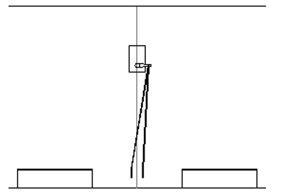

Thanks for the thoughtful analysis. You were correct in your assumption that the retract servo will be forward and the flap servo aft. I'm using a Hitec retract servo which has a "short" case... only 1" deep. The entire servo will be below the top wing skin. The flap servo will, of course, protrude above the wing skin. I currently have a 2" piece of fiberglass tape on the wing join seam and a 6" wide piece over that. The 6" piece is automotive glass and didn't specify a weight, but I believe it to be roughly 2.0 to 4.0 oz cloth. I pulled the wing retract pushrods out after determining that I could get them in again when I needed to.
I will put the flap servo in, in-line and parellel to the retract servo as you suggested, leaving an area of undisturbed glass cloth between them. I'll let you know how it's going as I progress.

Excellent Greg, have fun with it!
Quickly, I just glanced at a plan that rainedave uploaded here:
http://www.rcuniverse.com/forum/m_8704801/tm.htm
It's an interesting alternative which would be more in line with what you've already done. You could use hardwood dihedral braces to join the two wells together as shown. Of course, this could also be done with the servo's installed span wise as discussed. The rear bottom wing bolt plate on the Belaire even looks like the one on your Tipo!

I have a question about the flap install you guys are working out. If you put the flap servo in the center and connect both connecting rods from the flaps to only one side of the servo (let's say the right side) and connect both the right and left flap to this arm, wouldn't the fact that one connecting rod is longer cause the flaps to be at different angles once they are deployed?

The Tipo 680 was only offered via plans for the scratch builder to build. The 720 was the refined version of the 680 which had a slight change to the tail section and the wing was a little longer. The 720 was the one WK did then GP took over. I have the 680 plans that I will lay the 720 fuse on to show the difference.
It was not so much as a license deal..... but more of a DH letting the WK and GP (I guess you would call it "Rights") to produce the kit. Bill did due all the glass work for the first Tipo from mold to production. Then, for what ever reason the rights we given to GP. As far as I know Bill did not due any other glass work for DH after the first Tipo.
The later Tipo instructions were building instructions with just the basics needed to put the plane together. No where near the detail the the WK or GP manual (GP basically took the WK instructions and change the name on the first page and copied the rest word for word) has.

If installed the way you have drawn it, there certainly would be some difference in the travel of the two pushrods. I planned all along to offset the servo enough to center the servo arm and I also plan to use a Dubro reverse splitter to enable a single pushrod to actuate the flap control arms. The dual clevises will be minimized very close to the control arms. I believe that Dave Brown also sells a larger reverse splitter to support dual elevator actuation from a (mostly) single pushrod, but I'm going to adapt the Dubros for both jobs. In essence, it will be a single pushrod from the elevator servo to the exit holes at the rear of the fuselage, split there to the control horn on each side of the fueslage.
Greg
Greg
