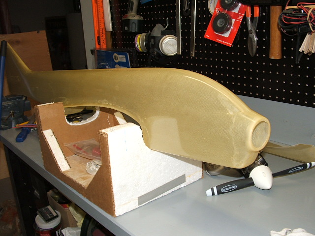

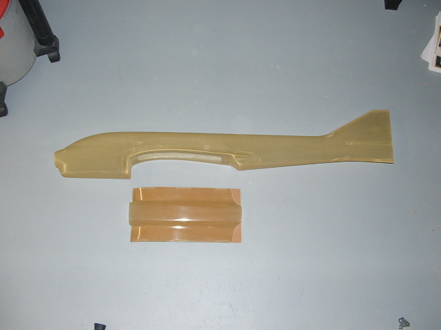

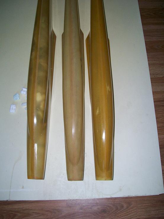

Had a little break here to get pictures of the fuses. The top fuse is the GP/WK Tiporare (720). The 2nd one down is the the fuse for the Tipo + (or 750) depending on how you ordered it. The 3rd fuse is the Tipo Surpass which is designed for the 91 four strokes. (thinking about getting rid of this one). As you can see the major changes took place from the wing saddle forward. The Hipo Tipo goes in between the 750 fuse and the Surpass. I'll fill in the blanks later when I get more time.[&o]
Mark
Mark

ORIGINAL: joshman123
The fuse does not have the stab location marked.. there is a line on the front and back near the location but not sure if it is factory.
DH put a "+" and a "-" on the tails of the other Tiporares. (It can be a pain to see) The 720 is the only one to have a solid line the marks the where the stab goes. I am willing to bet that your Hippo has the same marks
#132
Mark,
fantastic!
Nice to finally see an almost complete lineup. It's interesting how the canopy progressively receded backwards (or shortened in length) as the models evolved. The Surpass sure is an odd looking bird. If you do decide to part with it, please let me know!
After seeing them all, I have to say that the original 720 has the most graceful lines. However, the 750 might be a better model for the 60's we use today - those 30 squares sure help to lighten things up on the wing.
David.

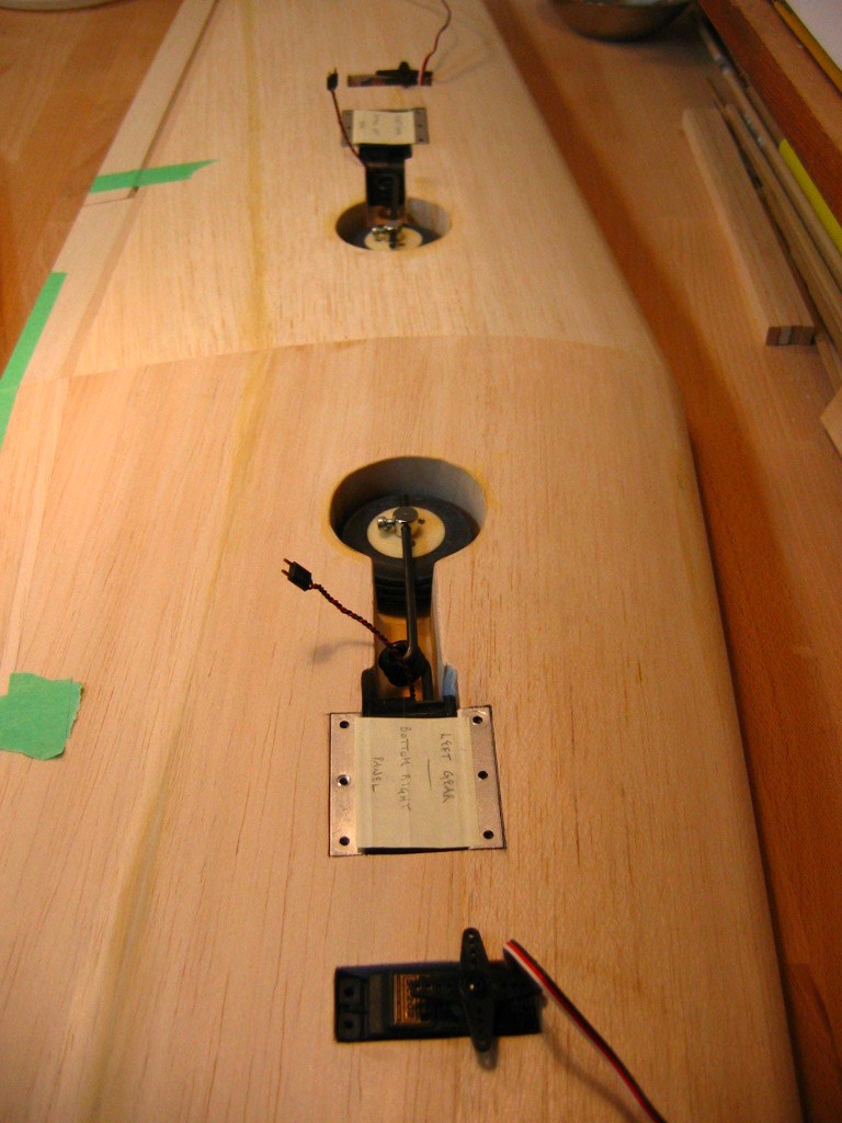

Well,
after a few weeks of working on wings and stabs, I'm running out of reasons not to join their panels. Although the retract wells are perfectly functional, they are a hair off perfect circularity (cool word) - or shall I say: gibbous wells. This is primarily due to the stub spars lining the well area which prevents a circle of the ideal diameter when using 2.25" wheels on mains. Perhaps a landing gear plate of 3" width would be more suitable to allow the entire wheel well to be encompassed by foam rather than bordered by stub spars. I'll get them perfectly circular on the next wing.
For those interested, attached are a few snaps of the electric Kraft Multicon (4.8V) & wheel setup (11+ oz [X(]) in the wing cores. Ailerons and elevators are also hinged using Robart hinge points.
Hope all you other Tipo builders out there are making good progress!

If you are like me and get a kick out of things like this, have fun with the 1 min movie attached. Save file as Tipo-Multicon.avi
Actuation is accomplished via a double pole/double throw switch powered by a 4s NiMH pack. In the model, the gear is actually operated via a vintage amp (essentially a wheel-less servo) connected directly to the Rx with a few leads sticking out of it. Power for the amp and gear can be supplied from the Rx or from a separate dedicated source. 2.4V gear also existed (earlier models) which today could be operated via a single 1100 mAh A123 cell - fast charge, steady voltage and light when combined with a 2s lipo Rx pack.
Playing with stuff like this can actually delay completion of a build by a week or so...
David.

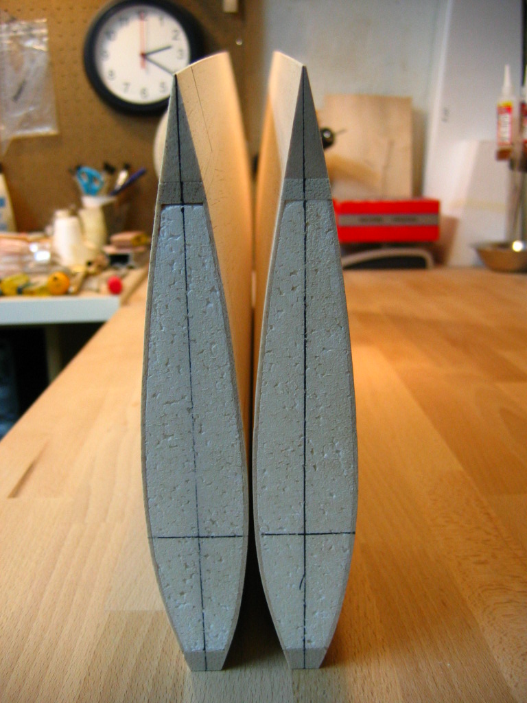

#138

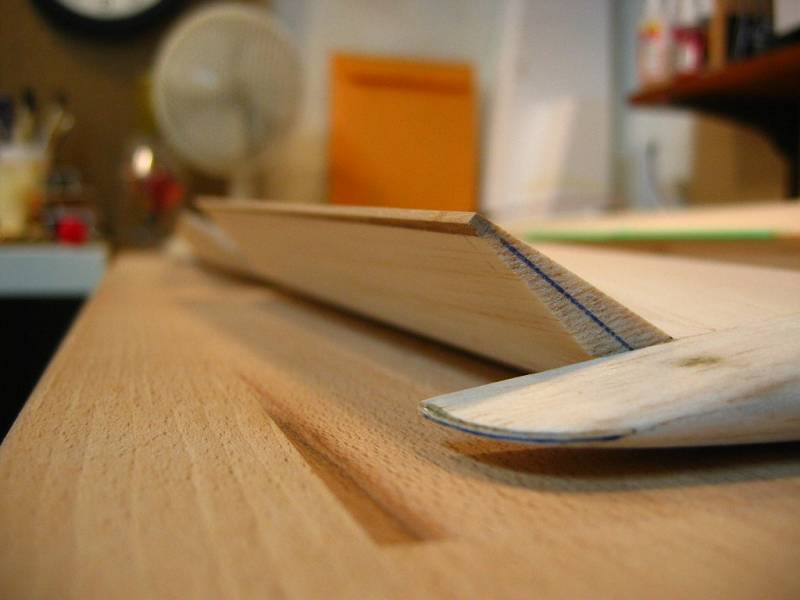

It shouldn't really apply to any scratch built projects with freshly cut cores but it serves to mention, for others who may have GP kits, that I had a manufacturing problem with my first set of cores:
The root airfoil templates were dislodged (in all likelihood) on passing the bow through the foam. This seems to have been a systematic problem (probably the first few runs) as the exact same error is introduced in each core. The LE expands in thickness toward the root (last couple of inches) and since the core panels are all cut single sided, one ends up with a LE which is overly thick on the top of one panel and on the bottom of the other. This leads to unequal incidences in the panels when joined.
In order to correct for this, I had to sand out the excess thickness in each panel leaving me with even thickness LE's. I'll have to check but hopefully the roots will now bond squarely while producing equal incidences.
The second set of cores, produced 5-10 years later, has another set of issues but I haven't gotten to them yet. I'll probably try to fix any problems with those at the core level prior to wrapping them in wood.
I suppose this is an example of lack of proper QC in the early days of Great Planes. My original '82 Tipo kit (described above) was one of GP's first production kits given GP was founded in '82.
David.

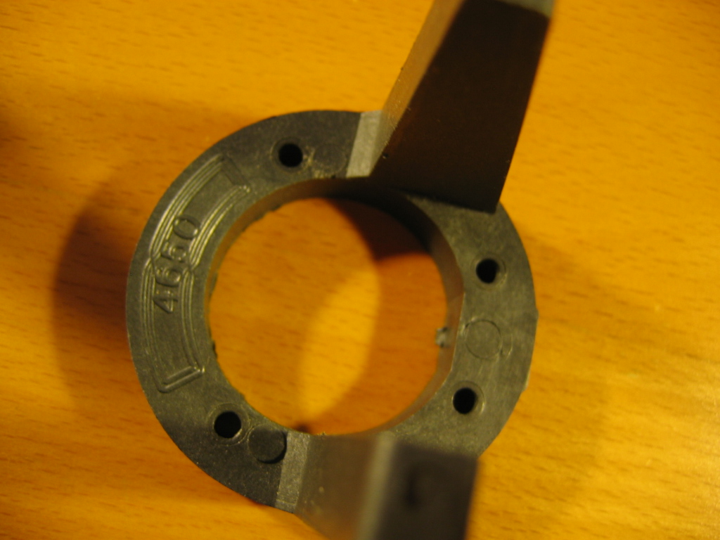

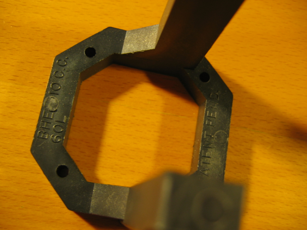

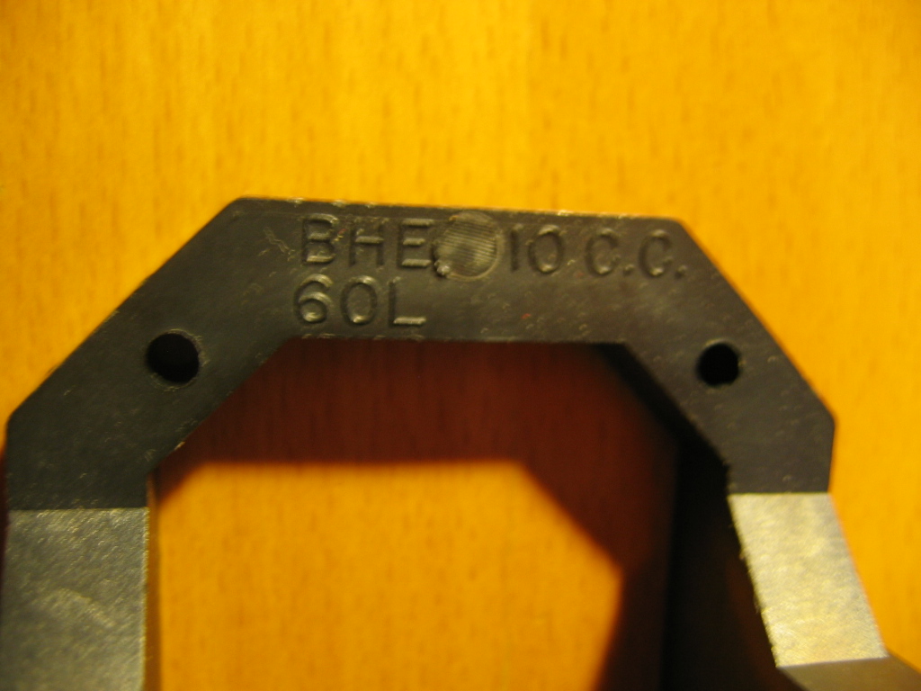

Mark,
BHE stands for Bridi Hobby Enterprises. Joe, made some nice mounts back in the day but they are now discontinued. BHE mounts had the mounting holes drilled in a square arrangement so that you could bolt on the mount in any direction you wanted once the holes were made in the FW. The crankshaft remained in the same position regardless of the orientation of the cylinder.
Nowadays, one of the standard glass filled mounts is the Dave Brown mount which doesn't have symmetric mounting holes - the bottom two are closer together than the top two. What's nice about the DB mounts is that the holes in the mount are arranged so that you can get a ball driver at those locations even when the engine is installed without it interfering with it.
When building a Tipo fuse in wood, the BHE mount is helpful in the construction of the nose although not mandatory. Modelers have never lacked creativity in finding solutions!
Photos attached - BHE 60L mount (e.g., OS 61 SF) and DB 4650 (e.g., YS 45).
David.
P.S. Are you building a wood Tipo fuse?
