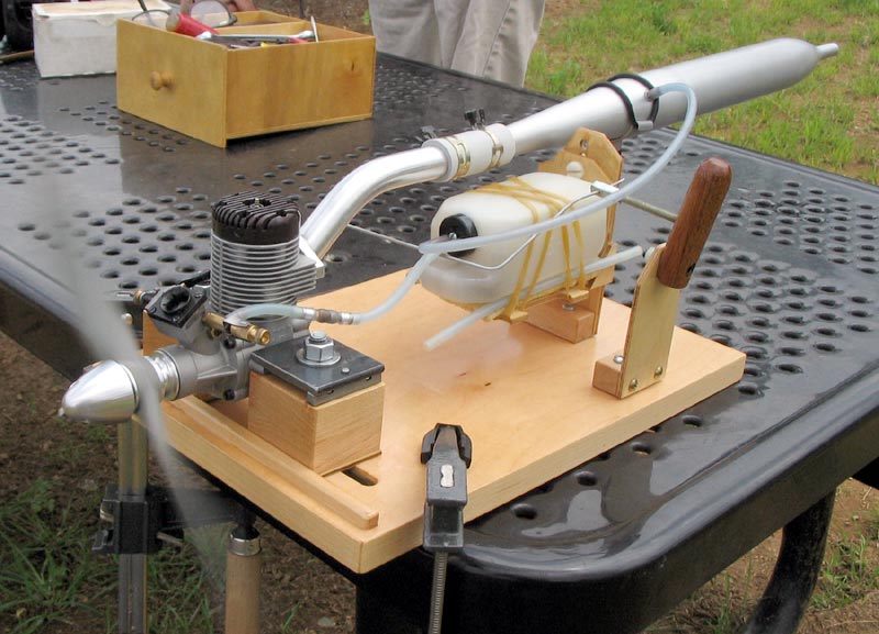

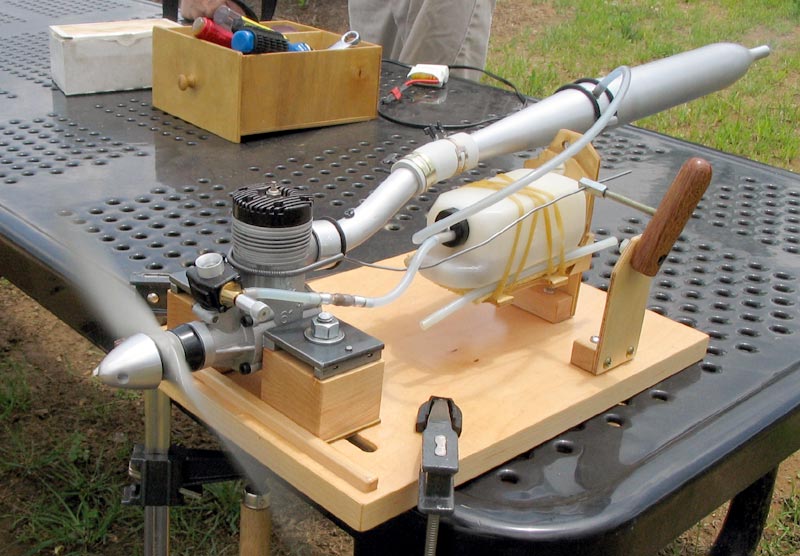

I was all set to do some pipe tuning/testing today. I packed up the car and drove down to the schoolyard (where noise isn't an issue). I remembered to bring everything except a spare 9v battery for my tach. I went ahead and ran a couple of engines, but I'll have to go back again tomorrow to get some tach readings. I still had fun (but my ears are ringing). Pictured below are my Rossi .61 RE and Webra 1030 RE. Both engines seem to run great.
Anyway, I'll try to post some rpm numbers tomorrow.

rainedave,
What kinda test stand is that? I am considering an upgrade for mine.

I've been meaning to ask you the same thing. Iseem to remember you designing it - beautiful stand. Do you happen to have the plans/drawings for it?
Ireally need to get a good stand. Waiting for aircraft to be ready prior to running/testing engines is not a great way to go.

No, I won it off the auction site. I do not know the guy making them, but they are absolutely first rate stands. He is clearly a skilled woodworker. It's the best test stand I've ever used. His seller name is eyespy241 and here's a previous auction:
http://cgi.ebay.com/ws/eBayISAPI.dll...m=300305556615
I think he makes them in batches; there aren't any up right now. He saw a post of mine a while back in the engine forum and is using my photos of my G.60 BH and TD .051 in his auctions. But, I honestly have no connection with him (I did tell him it was ok to use my photos). Just keep watching. I got mine for $36! They are worth $50 or more, IMO.

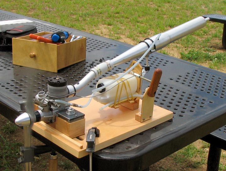

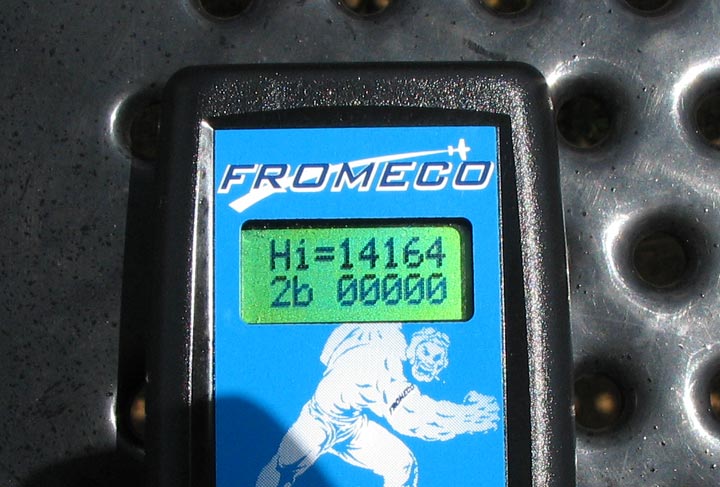

With a fresh battery in the tach, I did some more running today. These are both used engines that I cleaned up and restored. I'm sure I could trim a bit more off the headers and gain a bit more, but I'm very impressed with what I got. Readings are peak. I would back off a few clicks for flying.
Rossi RE with old-style Mac's Muffled Pipe:
81°
Powermaster GMA 5% nitro/22% oil
OS #8 plug
APC 11x8
14,164
10.11lbs static thrust
2.06hp
93.2mph
Webra 1030 RE with new-style Mac's Muffled Pipe:
81°
K&B 1L plug
APC 11x8
14,420 WOW!!!
10.48lbs static thrust
2.18hp
94.9mph
The Rossi was fitted with an OS #7L carb and the Webra has a Dynamix. The #7L was leaking a bit around the needle valve, so it needs a new O-ring. The seal against the case might have been leaking a bit, too, since it didn't want to shut down. The Dynamix is maybe the nicest carb I've ever used. Both the low speed and high speed needles have a very broad range. Transition is great with no loading up in the midrange. No problem at all with fuel draw at any setting. Though, the fact that my test stand has an 8oz tank might be helping that a bit.
