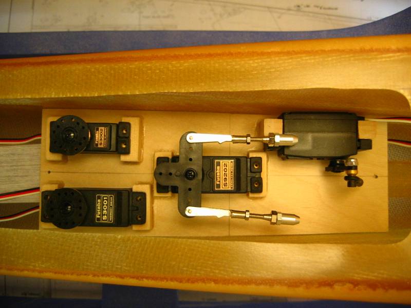

I am actually doing exactly this on a GP glass Tipo. I'm using Kraft multicon gear on mine so I have a total of 6 servos in the model (+ 1 amp for the gear) with one being used specifically for steering. A picture of my radio install is shown below. In your case, if your fuse is made of wood, I'd install a steering servo (a flat one would do nicely or another 65HB) on the tank floor and use the space for the steering servo in my layout for the retract (pnemuatic) servo. Of course, you might need a larger plate (or a separate one) to mount the valve. An option would be to put the throttle and gear servos up front behind the tank plate and under the front wing mounting point. On wood fuses this is nice because you don't have a screw plate that gets in the way of the radio install. Finally, I strongly recommend that you install your elevator servo for linear output if you are going to use a forked pushrod. Other options would be dual rear mounted servos or to use an MK elevator bellcrank system. Both are nice but neither is classic.
