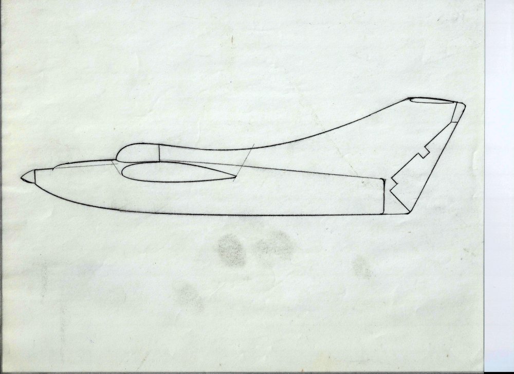

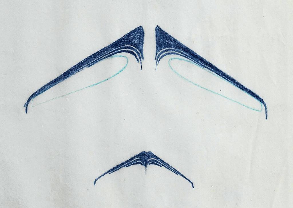

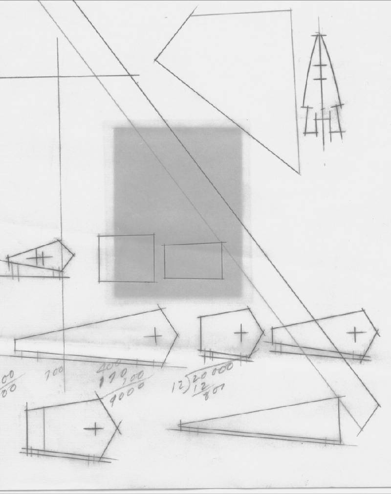

Back to the TBX-1 Drawings:

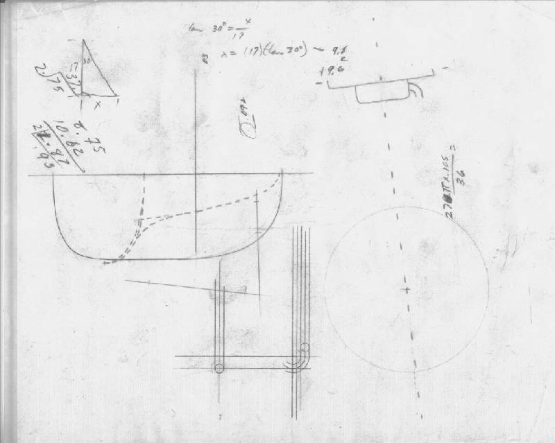

First, I wanted to show you the three drawings that are a mystery to me; in fact, I'm not even certain which way is UP, (though I took my best guess)
. BTW-They are essentially "life size" , (or a bit larger than), and just fit on to a standard size 11-1/2 X 8" scanner. My hope is there may be somebody out there, (UStik??), with concrete knowledge of what Tom might have been thinking at the moment. While not immediately understandable to me, they are still interesting to me for several reasons:
1) That Tom would choose to preserve these, (at all), with the rest of the drawings rather than being ultimately thrown away. This small glimpse into the design process is pretty unusual whether it means anything to the rest of us or not.
2) The use of geometry and other math equations. As an engineer, Tom actually USED a lot of the math I learned in the 9th grade and never used again having to do with tangents, etc. We see pi, (3.1416), in one of the equations. These equations show the plane was not just guesswork, but a lot of engineering went into its development. We see other figures drawn on some of the other sheets as well.
3) You see the calculations from all directions and on both sides of the velum.
To be fully open minded about the sketches, it certainly is possible these drawings might have nothing to do with the TBX-1 at all...but they were included with the other drawings, so most llikely the DO have something to do with it.
Speculations anyone??

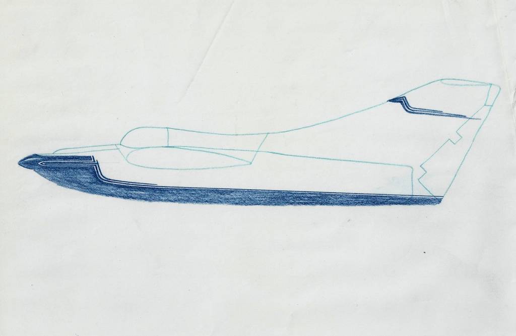

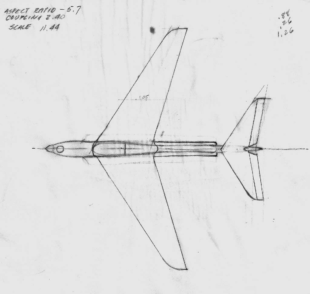

IMHO, the first drawing is exploring the center of pressure and the hinge point possibilitites of the ailerons.
Second drawing, see photo attached.
Third drawing I think has to do with the landing gear and torque moments.

I'll agree with Nic on the first picture, TB may have been looking at hinging and moments of inertia on the ailerons. I believe the second and third sketches may be for calculating bulkhead area, ((a "section cut") at a particular fuselage station. As far as the large circle, Tom may have just grabbed a reasonably clear sheet of paper and started sketching for some other idea.
Bottom line is who knows for certain except for those who may have had contact with Tom during the design/build process.

Now that I look at it, the large circle drawing may go with the drawing above, and MAY have something to do with the fuel tank, but who knows, (actually the tank is smaller than that though). The drawing has been preserved with everything else, and it's interesting to look at and speculate about.

I think the first one is cross sections for the tapered rudder. The ailerons and elevator appear to be pretty close to constant chord. The rudder is the only surface with great chord changes.
Those might be ribs for a built-up rudder.
Andy
Andy

You may very well be right with that one.
When I posted these three drawings, I had real doubts as to whether or not we would get any closer to an answer about what these drawing are for...yet I still thought of them as interesting none the less. Looks like we are making some progress.
These are no doubt early sketches. It will be interesting to compare them to the final blueprint plan, (whenever I get it back), to see if they correspond to features in the final plan.

Now that I look at the first one again, I'll agree that Andy may have it right. Duane try this: take the mystery sketches and overlay them over the master drawing. You may find your answers.
Since these items were rolled up with the identifiable TBX-1 drawings, I'll bet that they are part of the package. If I was working on a particular drawing, I would certainly keep all the materials together when stored.

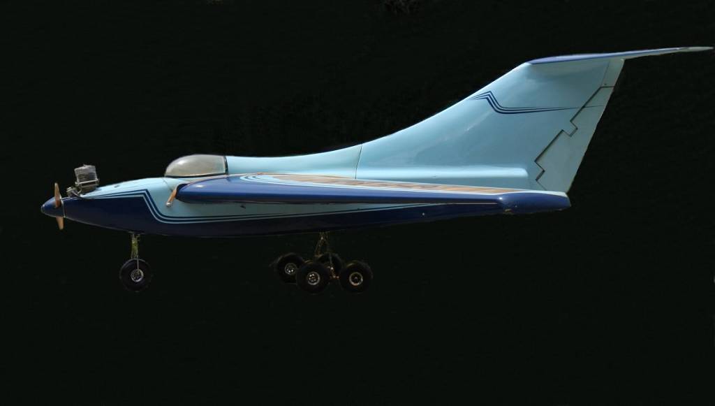

Let's look at the details of the TOP and SIDE views, while comparing them to the finished product. It took more than one viewing for for me to notice the changes between the concept sketch and the final TBX, (and like a "Where's Waldo", there may be additional details to discover).
The TOP VIEW is very much like the final TBX with the exception of the "side air inlet scoops", which have been erased, but you can still see the outline of them. It looks like Tom originally intended the TBX to look even MORE like a jet aircraft than the final version does. By this time Ralph Brook's "CRUSADER" had been published. Perhaps that model was at least a partial inspiration for the TBX-1.
#89
The SIDE VIEW reveals more detail changes, and confirms those we just talked about. The air inlets are shown both on the SIDE VIEW and the FRONT VIEW detail, (which was NOT erased). The finalized version IMHO, was a move toward more conventional, less complicated construction for the fuselage. The rounded jet fuse gives way to a boxier, easier to build fuse, yet the final look of the plane are not changed all that much...much of the fuselage is hidden under the swept wing.
In addition, a conventional fuel tank position was first planned, but then abandoned in favor of the rear location over the C/G. Doing this however presented some real problems to overcome as a pump would be necessary.
Notice also that originally there was a mock jet exhaust planned, with the rudder ending above it. The rudder was later extended down to the bottom of the fuselage. The original sketch shows the conventional two wheel main landing gear rather than the much more involved and ambitious 4-wheel arrangement of the final version. Remember not only were there four wheels, (which I don't believe I've ever seen on ANY pattern plane since), but Tom devised an electric braking system on two of the wheels, (perhaps when he learned the site of the 1965 NATS, with its concrete runways).
Retained in both the concept picture and the final version were the droop wingtips, the LAS, (lateral area special) outline with large vertical fin and the T-stabilizer, flowing into the partial bubble canopy. The wing to me at least, seems largely unchanged from the concept sketch all the way to the final aircraft.

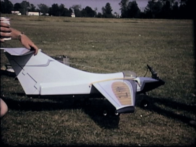

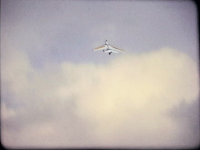

ORIGINAL: CHARLES WINTER

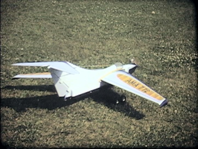

Hi Duane and Tom Brett fans. Just putting a few Still pictures taken out of my DVD to prove again that Tom did fly the TBX-1. Col. Chuck Winter
And it sure DOES look COOL in the air IMHO. While the stills are great, it doesn't quite capture the Victory Roll at the end.
Chuck, just an idea, would you post an additional 10 or so "stills" from that small segment of your video to give a better feeling for what the plane looks like from different perspectives? Please!!

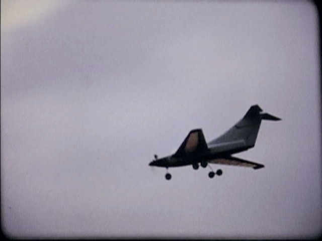

Hi Duane, I hope these ''Stills'' will help you. Col. Chuck Winter
Those of you who have not yet seen the video, it is well worth watching. I just sent one to Don Lowe.
