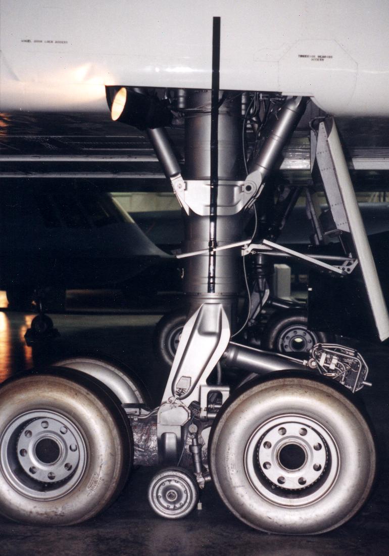

I get the impression many pattern ship designers of that era were going for 'the jet look.' I'm guessing it was more for cosmetic reasons, not necessarily functional.
Many jets of the period used the double wheel landing gear. Tom's got that too. No need for it on a model, but it looks cool.

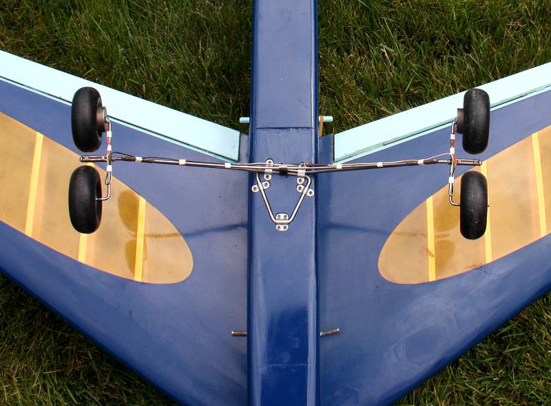

Sorry for the delay in posting, but our big Asheville SPA contest consumed most of my time last week.
I wanted to discuss a few of the features of the TBX-1 in detail before moving on to something I feel will be big news for those who like this plane, (and potentially other Brett designs).
I wanted to look at the landing gear set-up. As we discussed earlier, there is no real reason for dual wheels on each side of the main gear; I believe the L.G. choice was made to give a certain look, as seen above on a full-sized aircraft. Tom was a meticulous builder, and engineer. Workmanship throughout the L.G. system is extremely neat and clean. Notice the wire and metal hold-down clamps are embedded, (recessed), so the main L.G. is flush with the fuselage bottom. The landing gear was custom designed, and what appears to be a custom braking system was used. Willie told me Tom made all his own hardware.

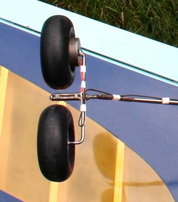

First, notice how the main gear appears to be "toed-in" slightly. Willie told me this was done deliberately to provide better tracking during take-off and landing.
Secondly, look at the brake system. One wheel on each side of the main gear contains what appears to me to be an electric drum brake of some sort. The wire coming from each side looks more like an electric wire than a mechanical cable. COMMENTS???

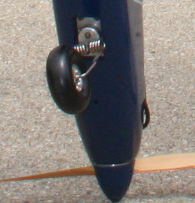

The nose wheel is also custom made. Back then, (correct me if I'm wrong), there were no commercially available dual strut nosewheels available. It appears Tom fashioned his own dual strut nosewheel that looks professionally done. Unfortunately I didn't take any detailed pictures of the nosewheel.
Any additional thoughts on the landing gear and how it was set up?

Willie is right on the toe-in. It keeps you tracking straight more easily. Otherwise, it will tend to zoom off in one direction or another with the nose off the ground and insufficient rudder authority.
As for the brakes, the other lead is likely the gear leg itself. There are a couple ways to do this, but the simplest is just to have a coil inside that thick hub and a magnet on the wheel hub. As the magnet spins, electricity is generated. By shorting out the leads (look for just a switch inside the fuselage), the wheel sees a braking effect. In the latest MAN there was an article on making a dyno. Same concept.

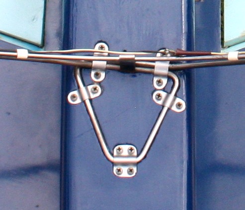

Tom sure was a true scratch builder. It appears if the main landing gear is formed from a single length of wire. Looking at the overall design and the triangle shape in the center, it must have taken more than a couple of tries to make it. It couldn't have been easy! I have to wonder why he choose the design he used instead of a 2-piece torsion design. Certainly would have been a lot easier to bend!

The larger area spreads out the shock into a larger section of the fuselage, enhancing the life expectancy of the plane by reducing the strain in any one area, and potentially allowing it to be lighter (reinforcements add weight) because fewer materials were required.

Some additional thoughts on the main landing gear:
The wire is too thin to carry the weight so there is a spring strut (just don't remember the correct name) similar to those on old light aircraft like a Cub. It's a thinner wire soldered to the outer ends of the main wire and hold by kind of a block in the middle. I suspect this "block" is a bit springy and makes a suspension for the vertical loads.
In horizontal direction the landing gear is a torsional spring, the actual leg (from fuse to wheel) being a lever arm and the short part across the fuse being the torsion spring. The twin wheels might be added later when this torsional spring turned out being too flexible. When horizontal loads from the ground hit the wheels, the tandem stays level and prevents the landing gear leg from swinging too much. Maybe...
Maybe that's why the brakes are on the rear wheels. It could be magnetic brakes (disk brake actuated by an electric magnet) as offered in several ads in Grid Leaks magazine at the time. They were not uncommon in the sixties (Graupner had them but way too expensive for me).
Seems the toe-in is quite big because it is reduced when the landing gear retreats under load.
The complicated triangle shape is actually a simple solution. Separate landing gear legs with a torsional part across the fuse need a rigid attachment to the fuse. This one-part triangle solution is simply attached to the fuse bottom by clamps. The triangle is the rigid attachment.
