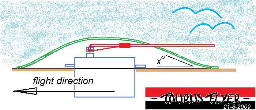

When you make a hatch (drop form?) over the outside part of the servo then it has less resistance (drag) than without. It is also a solution to keep them dry when it rains.
Try to make the angle of the backside less than 10 degrees (related to the surface of the fuselage) to prevent turbulence, better is 8 degrees. (angle x).
Of course you make the left and right side of the fuselage the same! Both side need the hatch.
Remove the unused lever of the servo then you can make the hatch as small as possible.

I think Taurus Flyer has the right idea for you. You can make a wooden plug exactly the size of your servo that you need to cover and then just form it like you would a canopy. I make "hatch covers" for all of my external servos with only the servo arm exposed to the air. Since your servos are in the fuselage airstream, I think his suggestion is very workable.

I did tell you, you are going to do both sides!!
It isn't only the oil!. It is also drag and FOD I did tell you and third less important fact is the oil.
LOL (I am a perfectionist)
Even it is not possible to make the angle 10 degrees, it always better to have the protection.
