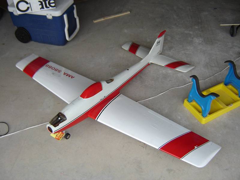

OK fellas, looking for opinions.
I am looking to start a classic pattern project (my second). I have the below pictured Tiger Tail 3, and a WM Intruder ARF with the covering stripped off. My engine would be an AXE/Rossi .60 side exhaust with a pipe and I will install Spring Air retracts on the intruder (which I have) or refurb the Tiger Tail (needs sanding, repaint and some structural repair, leave the Dave Brown retracts).
If you were me, which would you do?

No question, re-furb the Tiger Tail!

TT - again, no question.

Do the Tiger Tail!
Too many Intruders around.

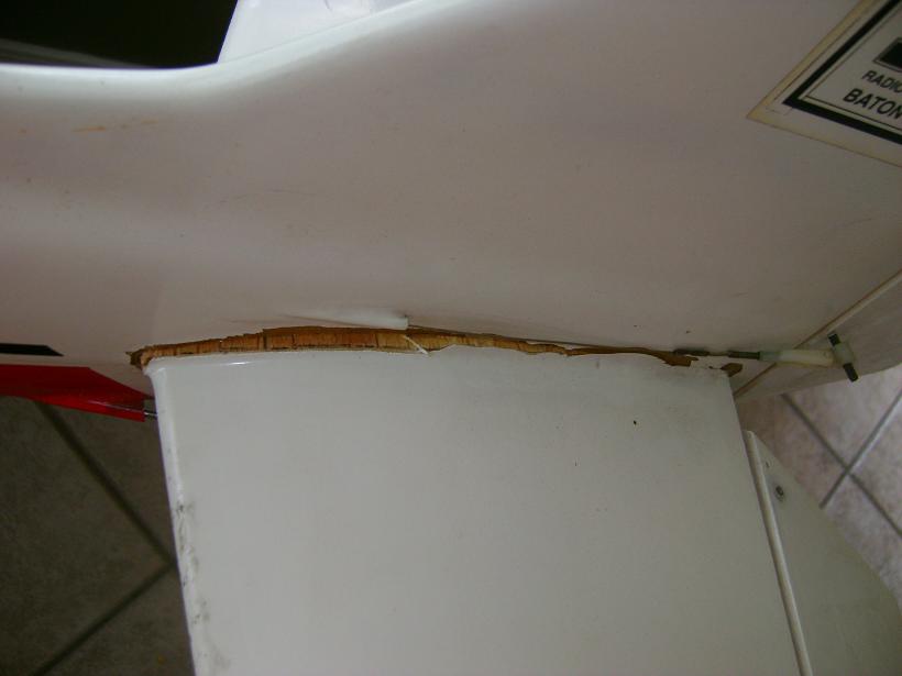

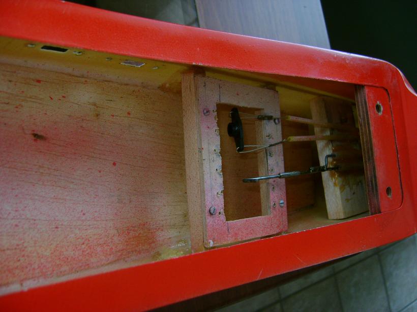

It's going to be a lot of sanding, glass patching and Bondo for the chips and such. I worry the firewall and inside wood structure might be a little over fuel soaked to use. I'll get some pictures together and let you guys chime in on if the project is really viable or not. The wing is in great shape though.

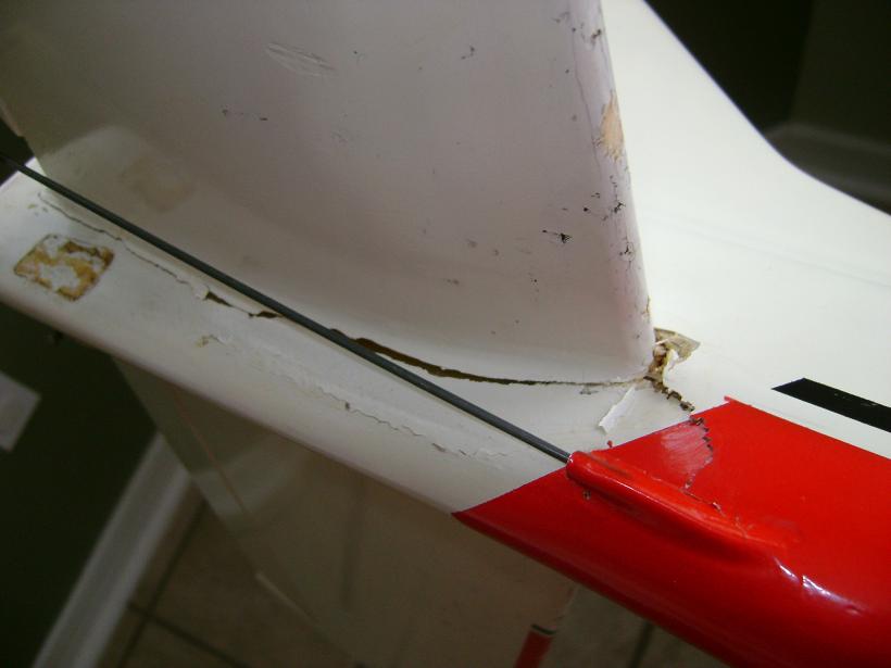

Here are a bunch of pictures. The tang over the rudder is missing (i'm sure I can reconstruct something), but the big job is fixing the stab. It's been completely broken free of the fuselage ($%^& MOVERS!). Not sure the firewall wood looks all that great, but I'll take any and all opinions before I sink the effort into this one. The engine mount is junk and would be replaced, plus it's off center. Again, the wing is in great shape. Mainly worried about that stab.
ALL comments welcomed.

Ouch!! was looking really good until I saw the stab saddle.
Repairable definately! with the help of the gods in here.
Off the top of my head, Chuck (Atlant60) and Mike (8178) can lead you in the right direction.
Take a look at 8178's thread on his SBA. He did quite a bit of glass repair on it and it looks perfect!

its very doable. i would cut out the rudder block, and then have excellent access to fix the stab fractures, then make new rudder hinge block and carry on, the firewall could use some cleanup, but seems viable, i see some rot on the pipe floor at the front, cut it out and patch it then re coat with epoxy. dont get rid of the engine mount its a keeper. oh and get some carbon veil it rocks for this kinda fixin!

First thing I thought, was sand away whats left of the fillet on the stab and pull it completely out since it's broken loose all the way around. Then repair the cracks, re-install and fillet the stab.
