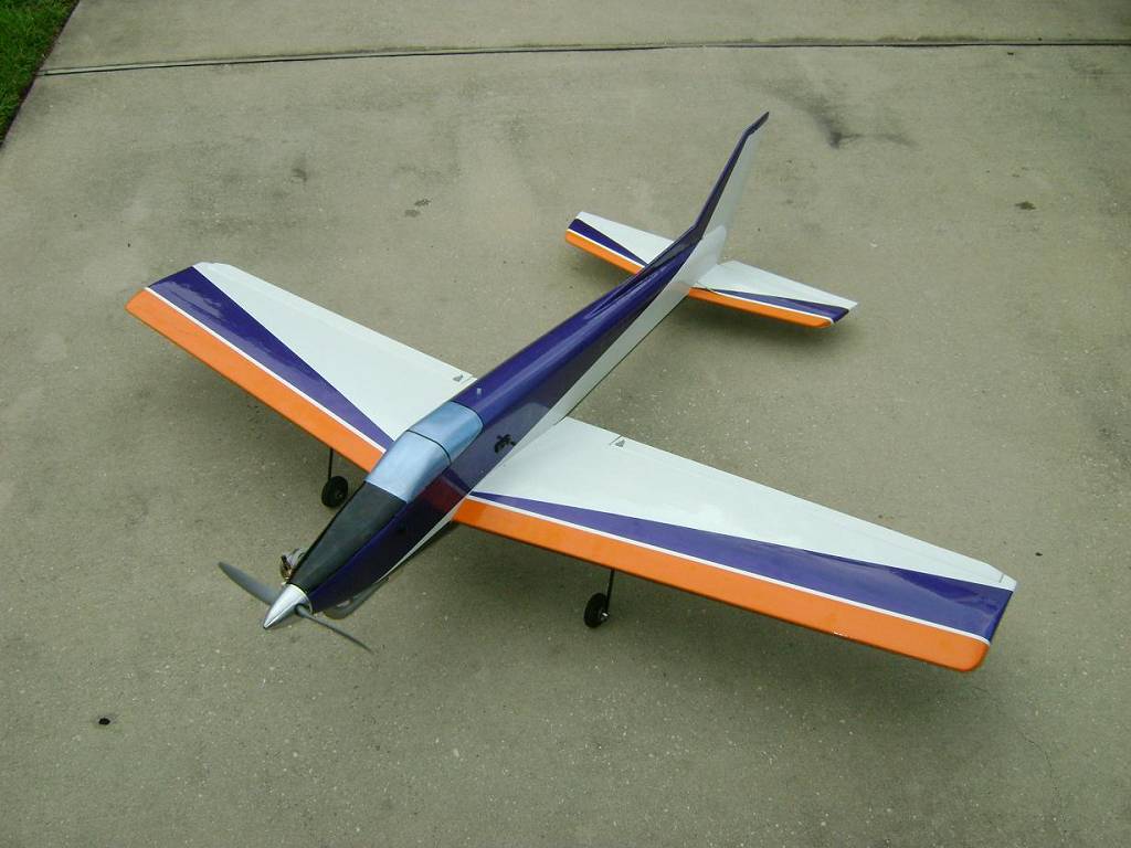

At the time being I am trying to decide between the Deception and Tiporare for a totally scratch built project from plans (going to be a ballistic, gear and pipe project). However, I have my Eureka Troublemaker in the garage about to be decommissioned for the engine and radio gear. Before I give it away, I was thinking about redoing the landing gear to tri-fixed and putting a standard .61 with muffler on the front. maybe rotate the engine to 90 degrees, etc... My question is... are any of you using the Troublemaker with a .61 two stroke in SPA? I don't know if I will ever make an SPA meet, but to me, building and practicing are over half the fun.
So, any SPA guys you know of using the Troublemaker with fixed tri gear and standard muffler?

I believe the Troublemaker is being flown in SPA events. I's certainly not the most popular choice, but it is out there. Yours is a very good looking model. If you like the way it flys, by all means convert it to SPA standards (fixed gear, no tuned pipe). I like the way mine flew back in the day.
BTW: Is yours the standard Troublemaker or the "extended" version? They're both SPA eligible as far as I know.
Greg

J&J kit, all wood. 3/4 oz glass and HobbyPoxy paint. Webra .61 Speed, ProLine radio, mech. retracts and Mac muffler.
The smaller trophy was from the 74 Nats, larger, the 74 Florida regionals.
Thanks for the compliments.
Greg
