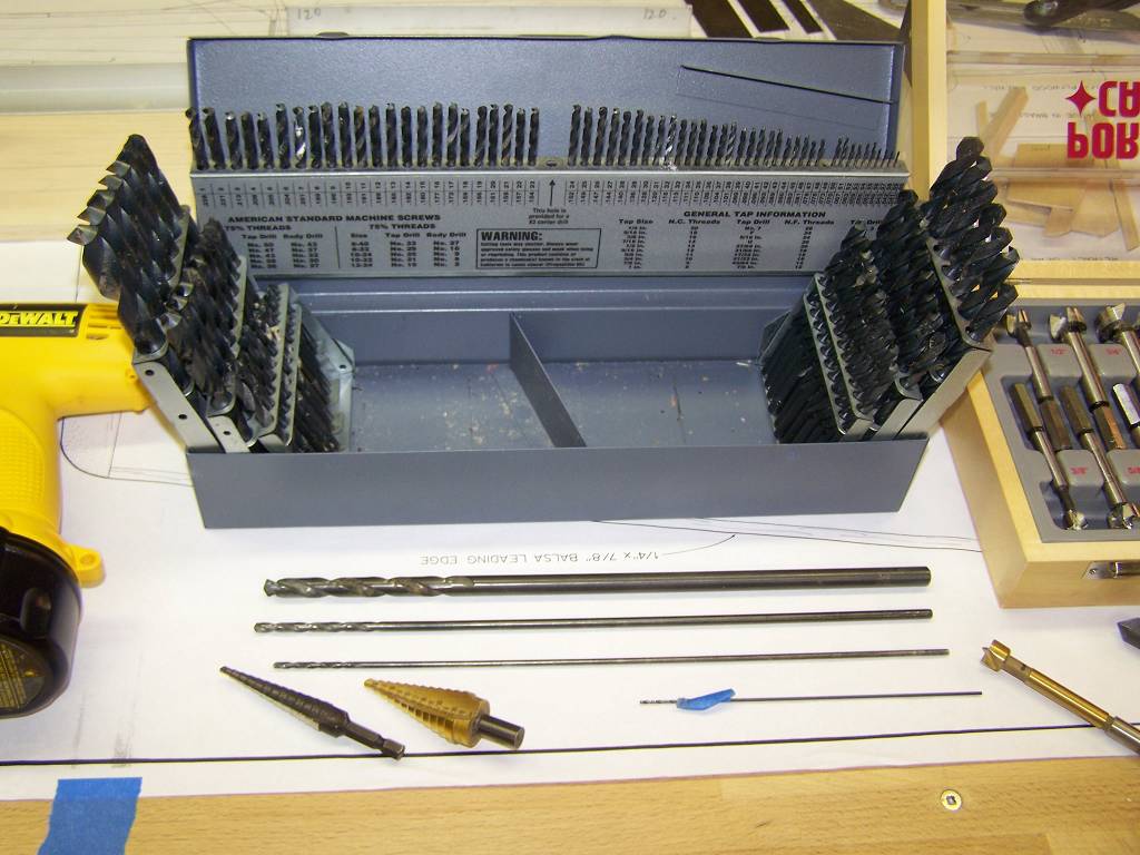

Tools, tools and more hand tools. The photos show tools I use to measure, shape, copy, bore and drill.
