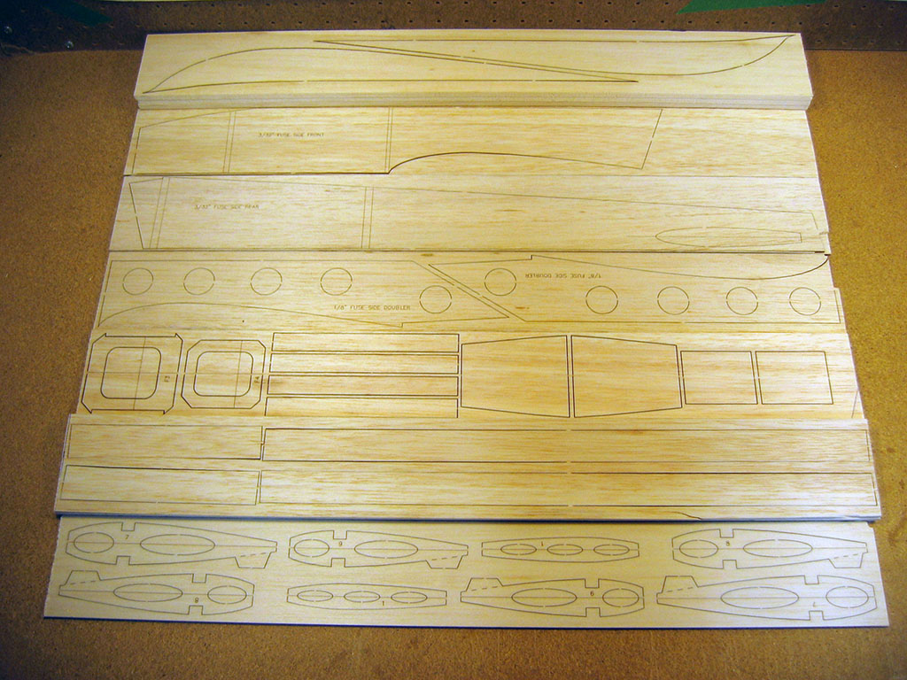

After some delay at the cutters, the UFO 25 development stage is complete. Yes, the laser kit is ready!
I am quite happy with the outcome of the plans and kit but like always, there is a first prototype plan, kit and build. Master builder Ralph (R_G) has offered to do a build thread on the first prototype model and I may interject some images of my own (if I'm be able to keep up with his build schedule) for comparison purposes. My build will be from a very similar kit to his - minor differences will be detailed as the build progresses. In essence, a glow and electric version of the kit was produced to cater to each type of power plant. The electric version should build somewhat lighter due to some lighter sheet stock used - primarily fuse sides, top and vertical. Wings and stabs in both versions are identical.
Those who expressed interest in a kit will be receiving it shortly.
A few pics of the kit:
[ul][*] 4" x 24" balsa sheets.[*] 3" x 24" balsa sheets.[*] 3" x 24" ply sheets and long stock.[*] Unbuilt kit weight: 28-1/4 oz.[*] Kits ready to go!

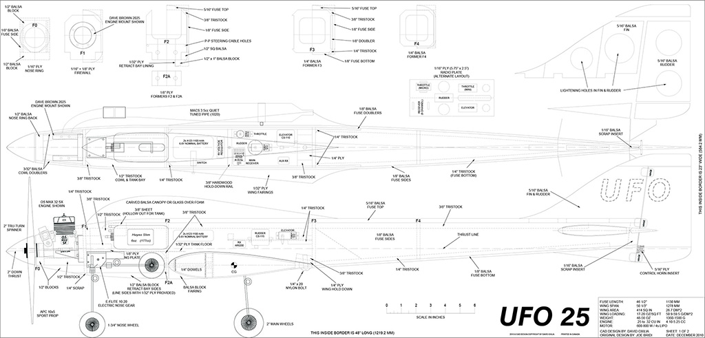

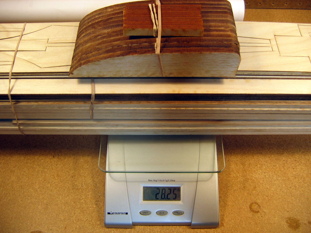

I began with the breakout of the parts from my kit to get a sense of the fit and accuracy of the parts. CAD is just wonderful as is laser cutting - just a world of difference from the days of gluing flat rectangular sheets together and carving an airplane out of it. As I learn more about CAD, I realize the level of accuracy and detail that can be designed and built into a model - something impossible to do without a substantial amount of time, in the days before computers when many of us began modeling.
I took a few snaps atop the 24" wide plans I produced (two sheets: fuse/vertical & wing/stab) and also took some weight readings to estimate the airframe weight prior to glue joints.
Parts Weight
[ul][*] Fuse & Vertical: 7.7 oz [*] Blocks & Sticks: 5.3 oz[*] Canopy, Wing and Stab Tips: 4.6 oz[*] Wing & Stab Ribs: 0.8 oz
[/ul]
This results in 18.4 oz but is incomplete because the kit does not contain the totality of the wood required. Wing LE and center sheeting as well as stab sheeting is not included. Triangle stock is also not included as are some other details such as servo boxes, control surface TE hardwood and the wing bottom fuse fairing. Estimating this wood to weigh a total of an additional 7 oz., the airframe can be expected to build to about 30 oz max. With a target all up weight of 56 oz (3.5 lbs), that leaves 26 oz for airframe finishing, retracts, engine (motor) and radio gear.

Ralph,
glad to hear that your kit arrived safe and sound. I haven't had a chance to reply to your email yet but will soon. Since the kits sent have reached their destination, it might also be a good time for me to make some comments regarding the kits (glow and electric) now that you guys have had a chance to take a look. I'll do so tomorrow when feeling a little more fresh since I've been lofting more ribs in CAD this evening.
In the meantime, here are a few snaps of the final building plans. There were a couple of minor variations from the plans on the actual cuts - particularly the control surfaces and how they are built.
David.

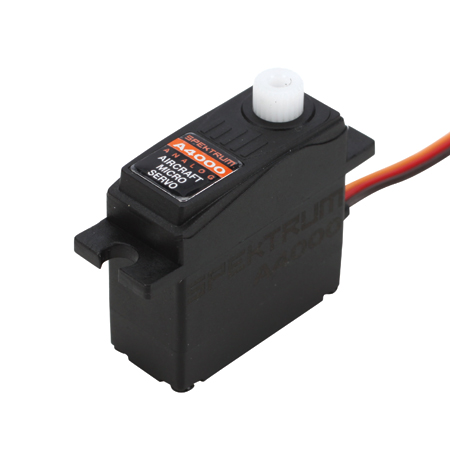

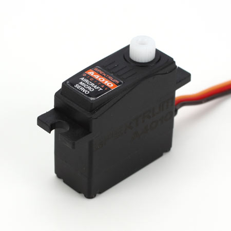

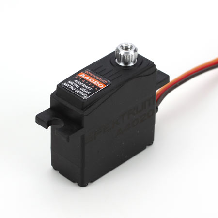

I just posted the below info on Ralph's UFO 25 build thread. I'll re-post it here for posterity as it's a good reference spot.
I recently purchased some in the 3000, 4000 and 5000 series (and a couple in the 6000's). The last two are aimed at 15-25 size models and 25-32 size models, respectively. The 4010's look good for ailerons on the UFO 25 while the 5030's look good for elevator/rudder control with a 3010 for throttle. I will be using a very similar setup on another 30 size model.
Here are some pics of the various servos - unfortunately with no quarter for scale reference. Basically, they are micros (3000 - similar to HS65), larger micros (4000 - similar to HS82) and mini's (5000 - similar to HS225 although slightly smaller). The two 5000's look to be very good on paper, I will be trying them soon. They all come in specification pair sets with one having nylon gears and the other metal gears. The four 3000's series are geared for speed (3010, 3020) or torque (3030, 3040).
The last picture is of a 4000 servo which is the only analog servo in the micro/mini lineup. Specs are otherwise very similar to the digital 4010/4020 versions
David.
