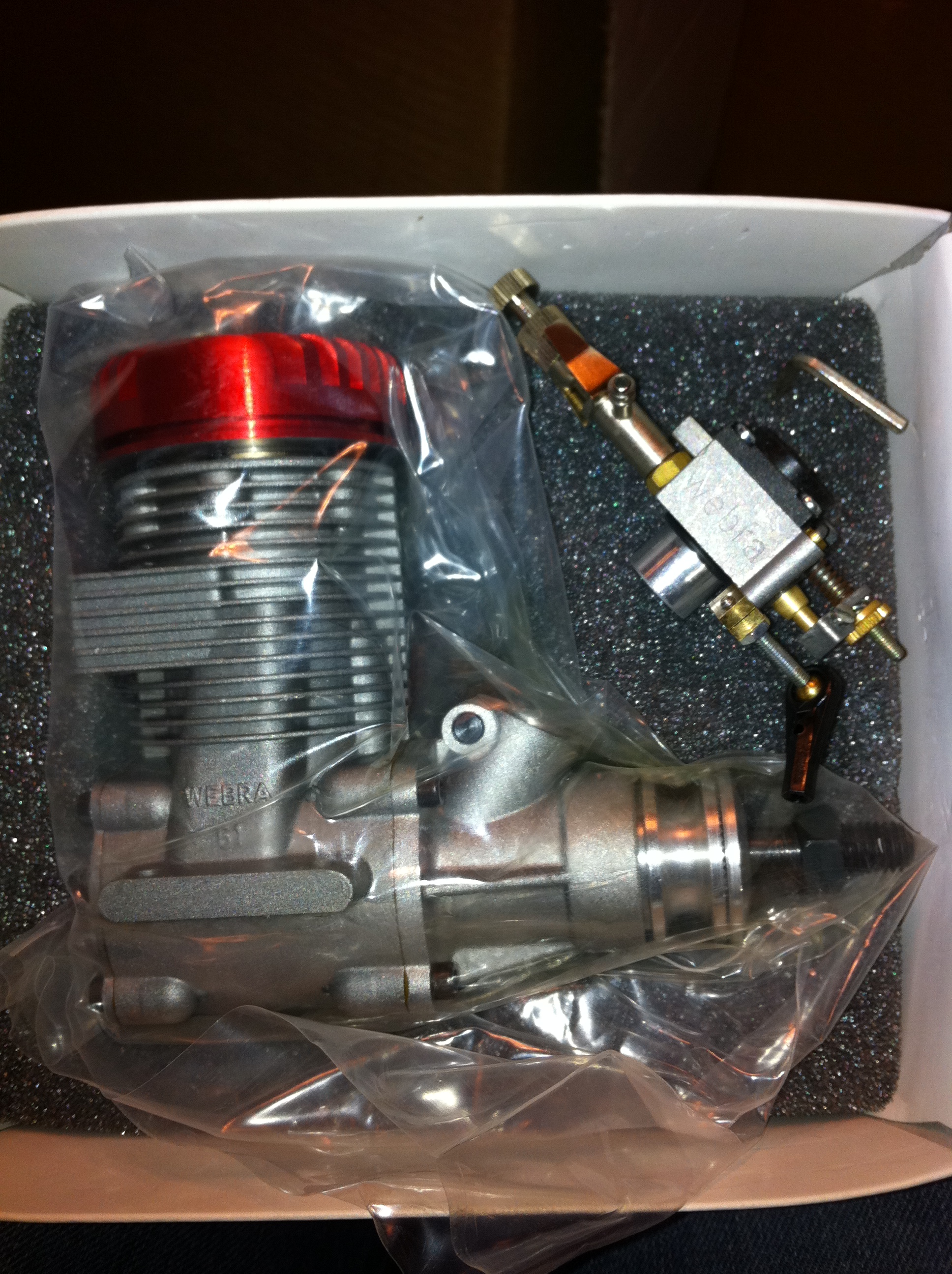

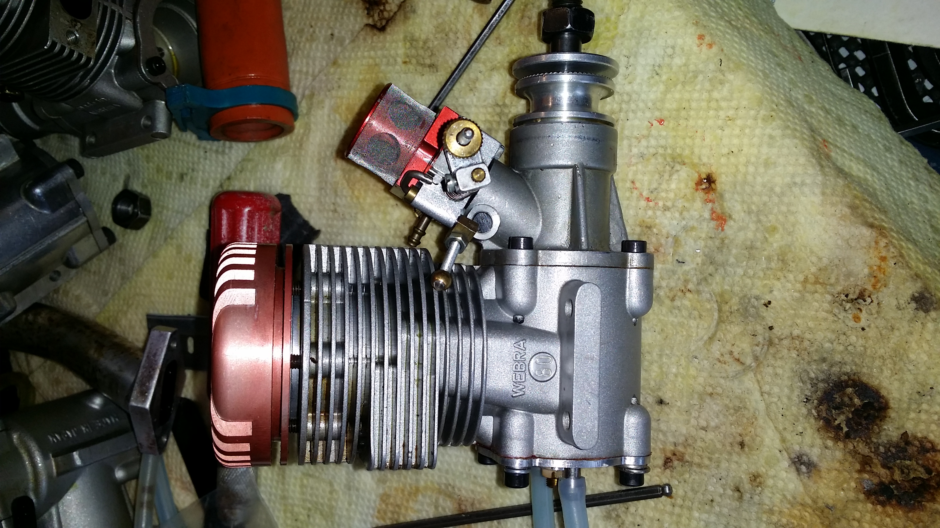

Here are some pictures of the 80 Racing Competition and the 61 Racing Competition

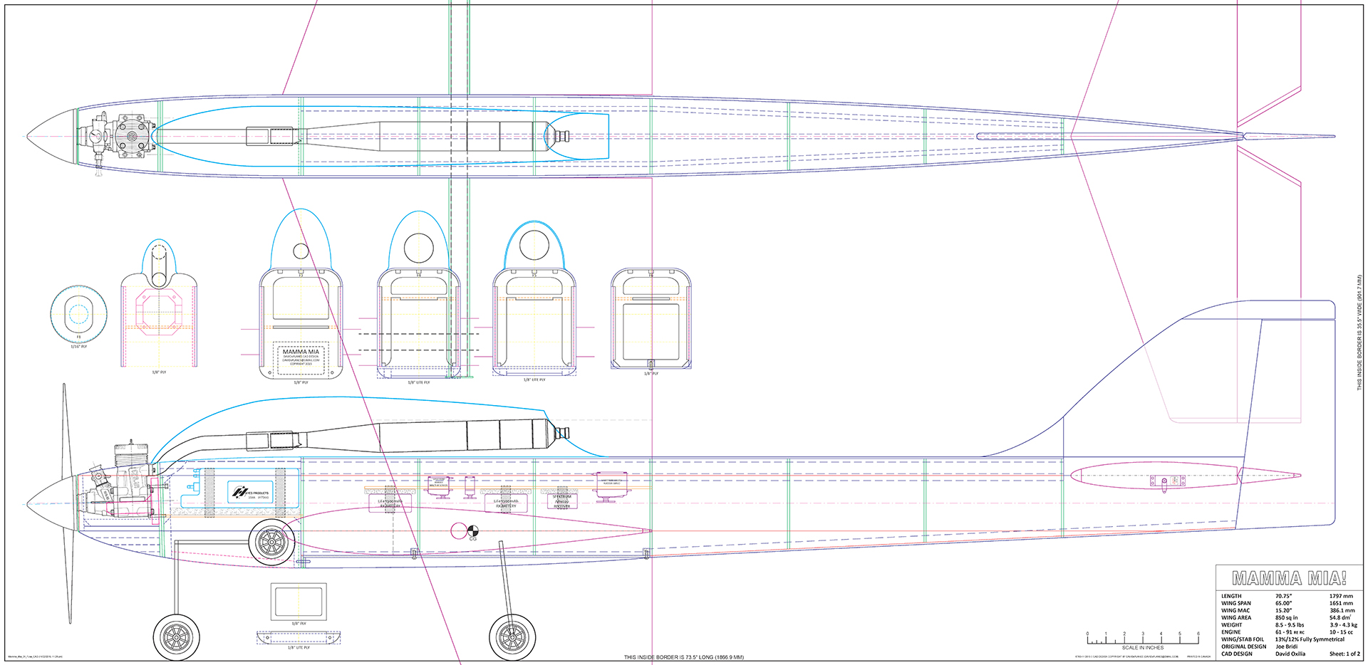

Ralph,
I think I'll eventually have what's needed for the subject of this thread!
6' length!, 65" span, 850 squares, framed up surfaces, plug-in wings, once piece stab, 3/32" skinned top deck, skinny foils for good penetration (13% wing, 12% stab), etc...
The original was a tank at 11+ lbs. I'm hoping for 9 lbs max for 80 RE power or,... one of today's monsters such as a YS Classic or a YS AR/OS Hanno. I'm thinking 13" props.
Work in progress...

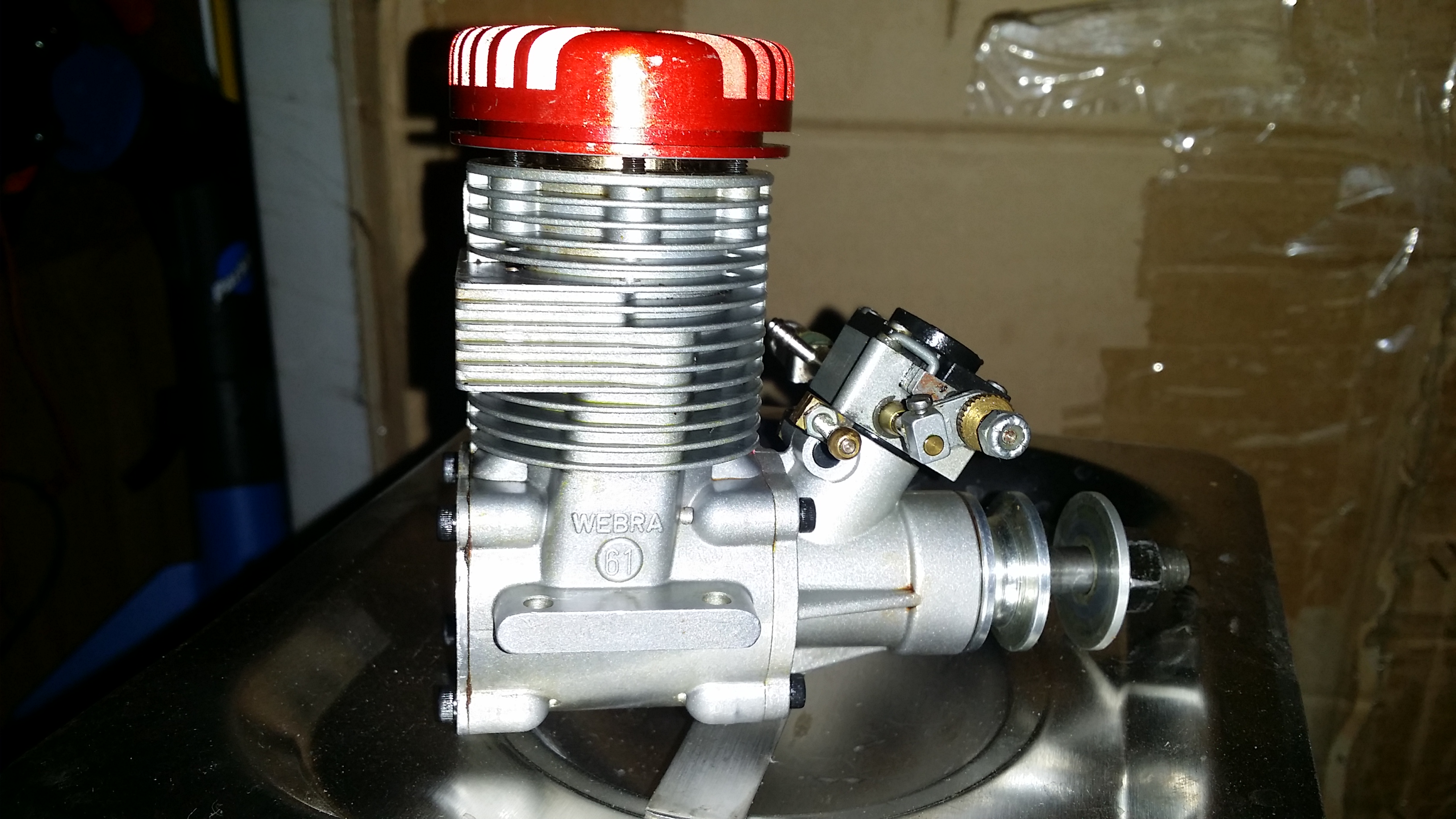

Whoo hooo, I have my Webra 80 back together with new bearings and a re-chromed cylinder and fitted piston. Now to run it.
There has to be someone else that has ran this engine or the 61 competition. Would love to hear your experience with the engine.

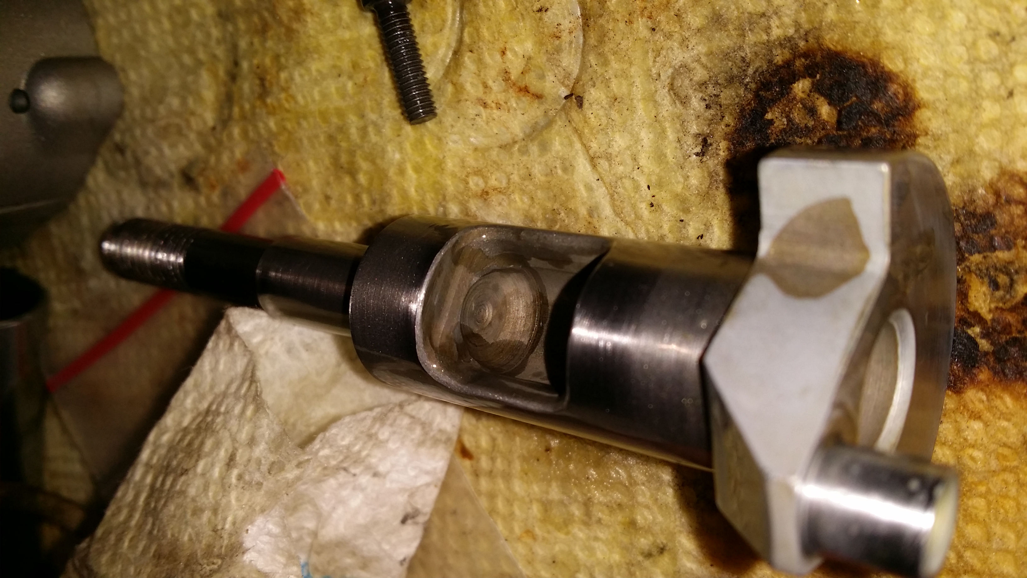

I had the crank pin chromed also.
