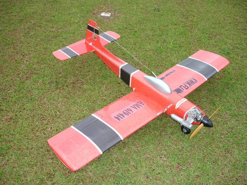

Ok I have received a set of prints from the AMA plans dept{Greg} for a Phill Kraft Kwik Fli MK-2,
While I start to gather and cut parts for my "kit" ,I would like to have a motor from the same time period to complete this project.
Could you gents provide a list of motors from the early 60's era along with comments of performance and collectability.
Swap meets are just around the corner here in the north east and it would be great to have a list of what to "hunt" for !
Mike

The Kwik Fli II was designed as a "smaller" version of the Mk.I, to be flown with the still popular Veco 45. As you may expect, with proportional radio "excessive power" became a nonsense, and quite soon Phil used a Veco 61 or a Supertigre ST 56/60. By the way, the aluminum plate mount can be used with the same hole pattern for both the Veco and ST engines. Webra Black Head and ST G-60 Blue Head (I like this one much better) can also be used, but they were released between 1969 and 1971, according to the different versions, while the Kwik Fli Mk. II was designed in 1965. I used an ST 56 on mine.
Happy flying!
Beppe

bepp: Nice work on that .60 engine performance list you did <P51#9031328
Thanks for the picture of your MK-2,that is the first one i have seen posted.
