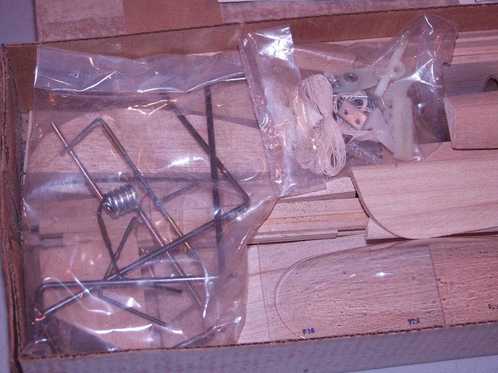

Hey Guys! Here we are at the start of another year and decade! Happy New Year to All! It seems it was just yesterday that we were worried about Y2K. There sure are a lot of other worries out there today that make Y2K pale in comparision.
I got a NIB Top Flite Taurus kit under the tree which was one heck of a big surprise! Earlier this year, I was talking to one of our club members about old kits and he said that he had a NIB Taurus but wouldn't sell it. Well I told my wife about it in passing and then let the subject drop. I guess my wife got in touch with this guy and convinced him to sell the kit to her. It had to be a really sweet deal or she wouldn't have bought it (my wife hates the fact that she'll buy a kit as a gift and then it sits unbuilt for several years). Well this is one kit that'll get built! Now I know that there's collectors out there that will cringe at the thought of building this kit, but I'm a builder, not a collector. And the Taurus is one that I've wanted to build for many years. The build will kinda be old school, as it'll be built as kitted. I'll be using old school type cement (Sig-Ment), Titebond and epoxy were appropriate, CA adhesives are not allowed! The trim scheme will be the traditional red, white and black colors that the Taurus is so famous for. I haven't decided yet on the type of finish to be applied, but rest assured, it won't be an iron-on film. The build will probably progress at a moderate pace until I get to all of the heavy shaping and sanding; that'll be done outside on warmer days. I'm really going to enjoy this!
Anyway, I have a tradition of starting a new build on January 1, and being this is the year of the Taurus in the Vintage R/C Society, what better reason to get started! Here some pics of the kit. All parts are accounted for, except for the Taurus decal which is missing. For a kit that's over 40 years old, it's in remarkable shape. All parts are still in their carrier sheets, and for the most part, the die cutting is OK. There is some crunching on the thicker parts. Tune in later today as I'll start on the fin and stab first. It's been far too long since I've built a kit.

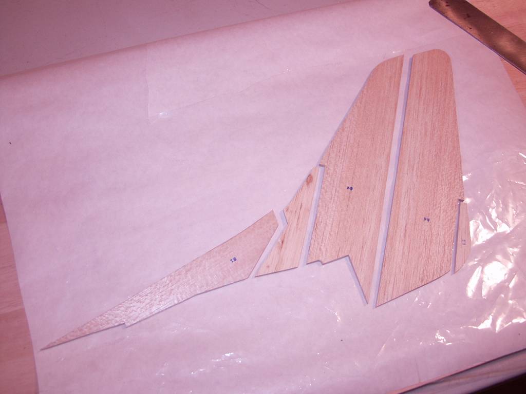

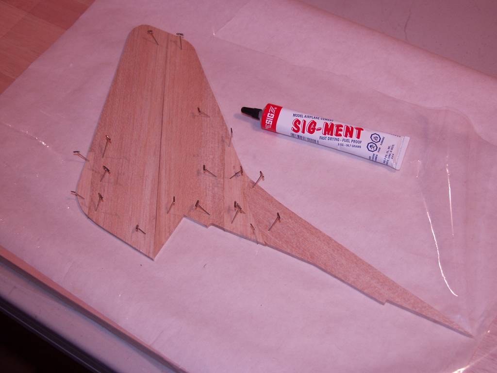

Here's the fin and rudder pieces before and after being glued together. As expected, minor trimming of the parts was needed to make them fit together well.
More to come....

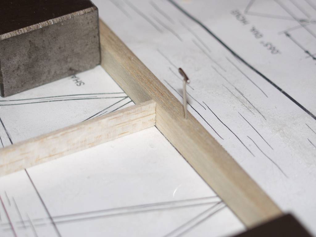

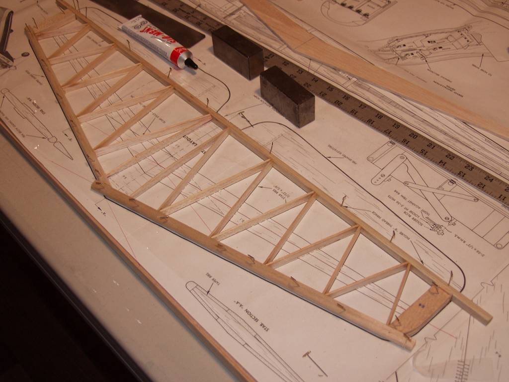

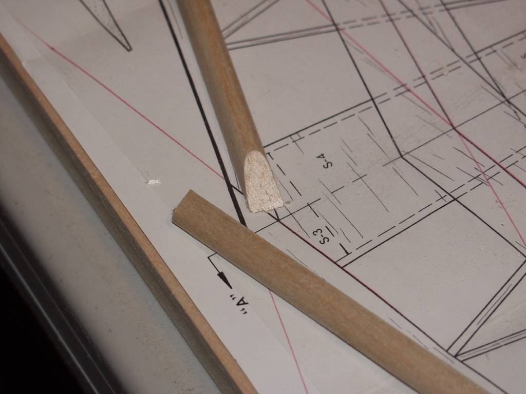

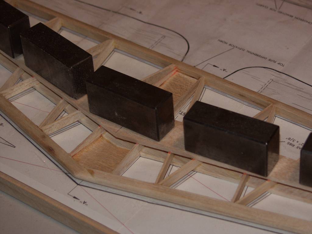

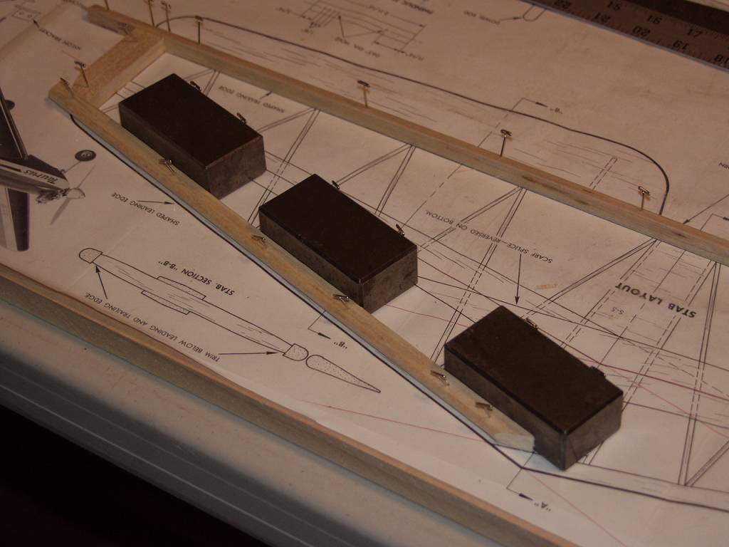

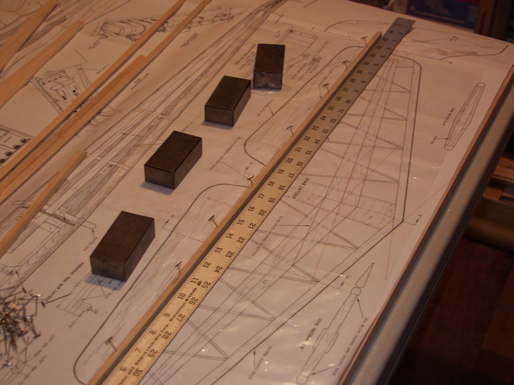

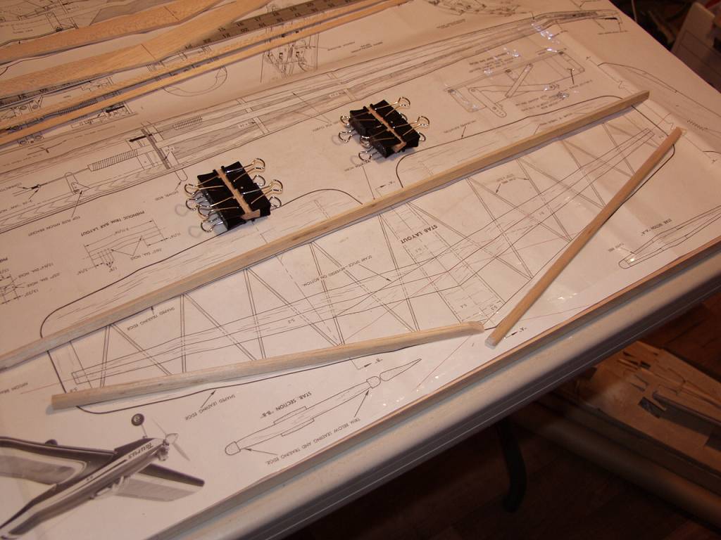

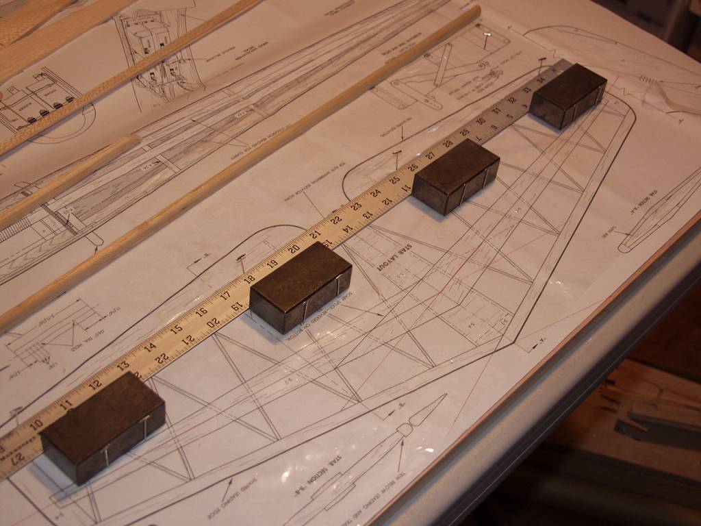

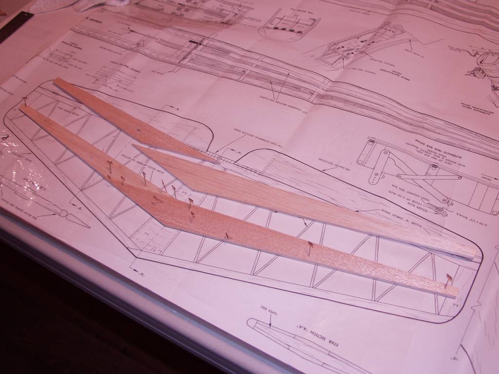

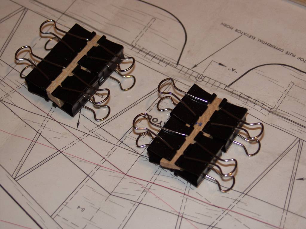

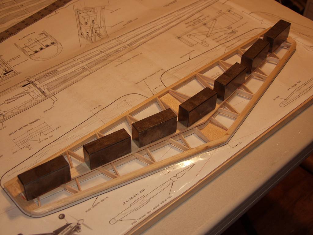

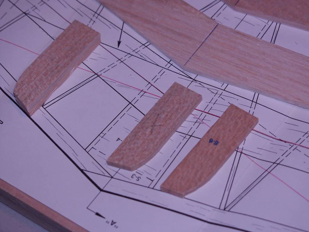

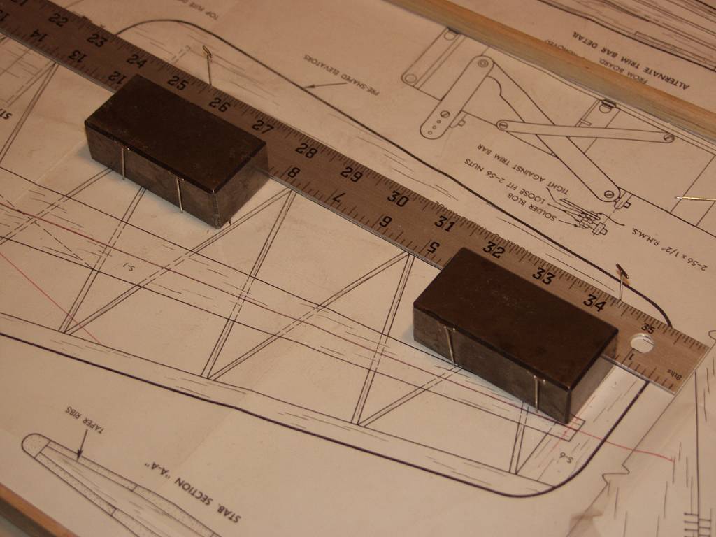

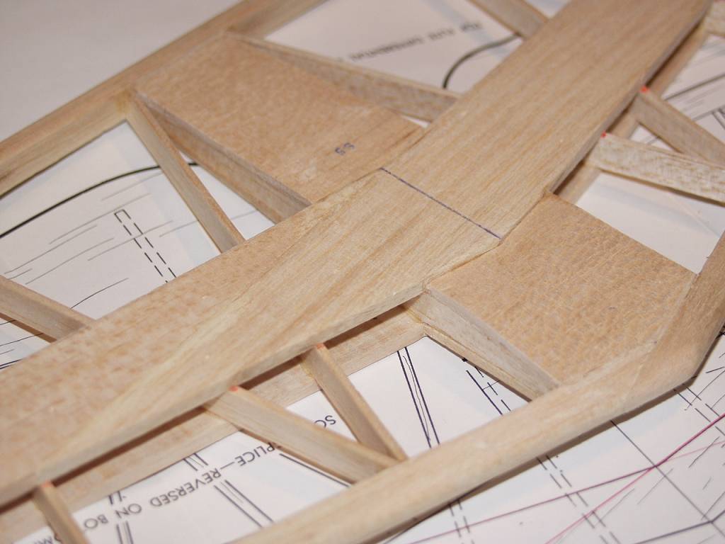

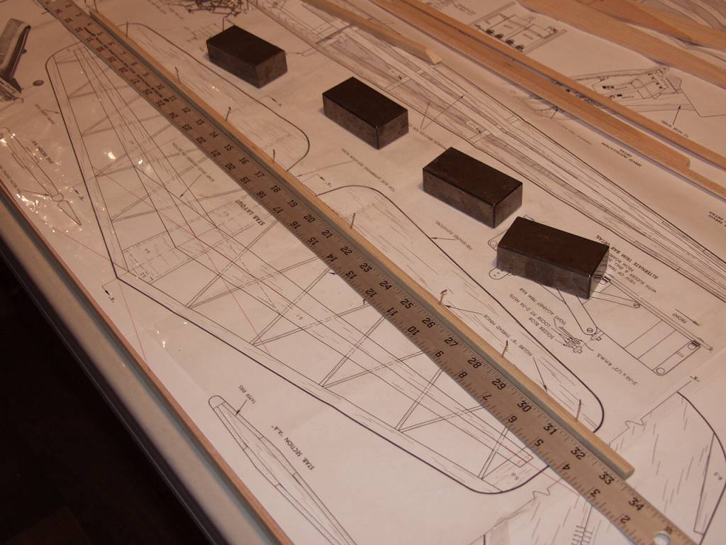

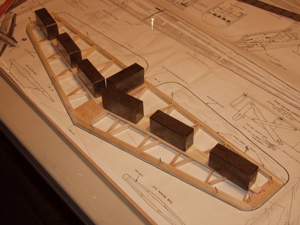

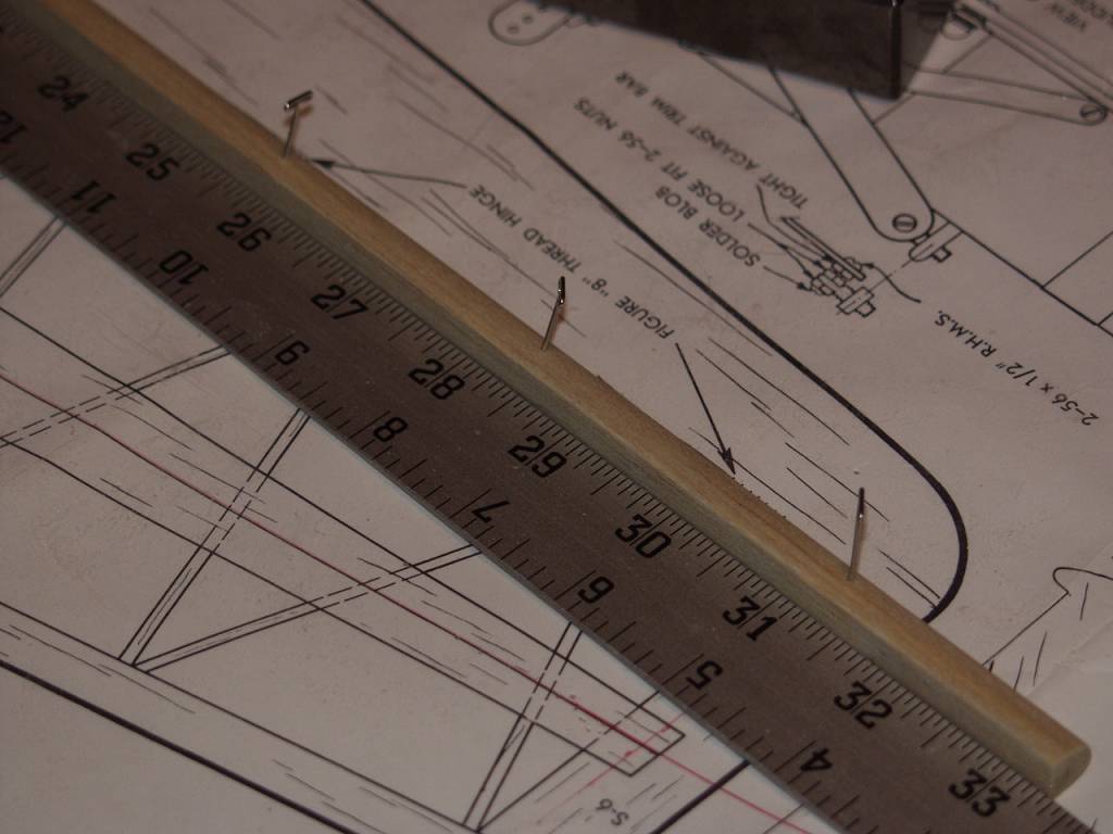

One of the things that I'm going to try and show in this thread, is all of the parts needed for each assembly. After reviewing the plans and isometric drawings, one can quickly see that there's a lot of parts (unlike a modern kit).
While the fin/rudder parts were drying, I got started on the stab. Before actual building of the stab, there are a few issues that need to be fixed. First is the pre-shaped leading and trailing edges, they're bowed pretty bad and need to be straightened out or make new ones. Being I'm trying to use as many of the original parts as possible, I'm going to straighten them out. I've wetted them, placed a shim in the middle of the bow and weighed down the ends opposite of the bow. I'll let them dry for 24 hours before checking them. Sorry no pics of this as they're in a furnace room that has a little more heat. (I tried but they didn't come out very well).
Next is the spars, they needed a bunch of work to make them match the plan before gluing them together. Ahh....the joys of building an old kit. The stab tips also need to be laminated so that got done today. As you can see, I used binder clips to hold the stab tips together while the glue dried.
More to come ..... on Monday as I have to work both days this weekend.

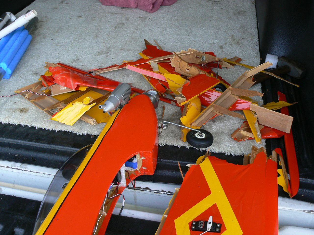

Here is a thread to my rebuild of two old Taurii, http://www.rcuniverse.com/forum/m_82...tm.htm#8237130 . Post #19 shows the new OS 55AX that was installed. After a longer break-in than most two strokes require, it is a really good match for the plane. I'm running an APC 12.25X3.75 prop and it screams. It could take a bit more pitch but it will climb out of sight with that prop. The only thing I wish I had done differently during the rebuild would have been to add wing fillets. Pics below are before and after the rebuild.
The pictures did not load in the order I selected, but the crash photos are the "before" pics.

Old 01-04-2010 | 09:50 PM
Joined: Nov 2005
Posts: 2,239
From: Farmington, CT
Default RE: Top Flite Taurus Build
One thing I forgot to mention. The center ribs that are under the center sheeting, needs to be tapered before the sheeting is glued into place. This allows the spar to be tapered to its diamond shape without thinning down the thickness of the sheeting. You can see the trimmed ribs in the first pic in post #21. Note how the spar stands above the sheeting.
More to come....

Old 01-04-2010 | 09:53 PM
Joined: Nov 2005
Posts: 2,239
Here's the completed stab ready for final shaping and sanding.
More to come....
FB
