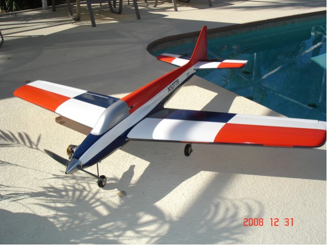

Chief - This P-6 was carried around for over 30 year's, transfer's, etc. When moving, it went with me, in the car, or whatever company vehicle I had at the time, or the wife's station wagon, (soccer mom). Not stealing your thunder here.

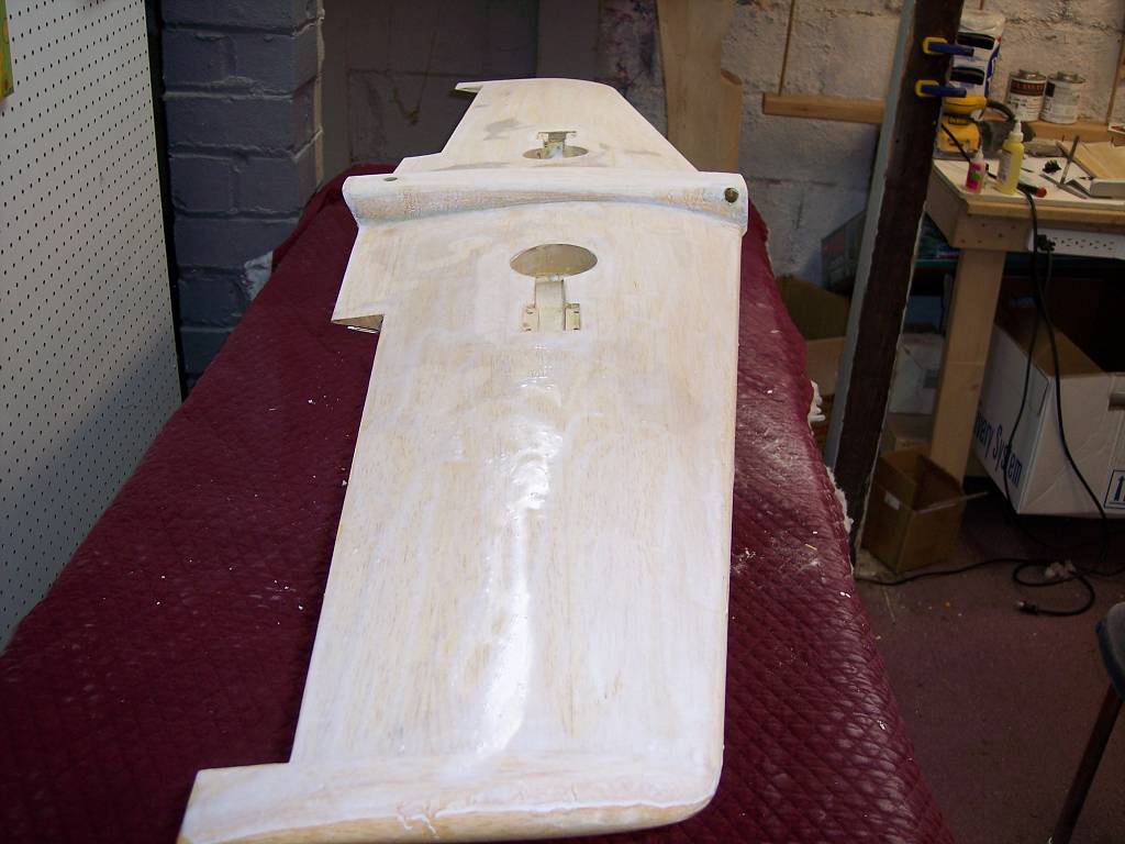

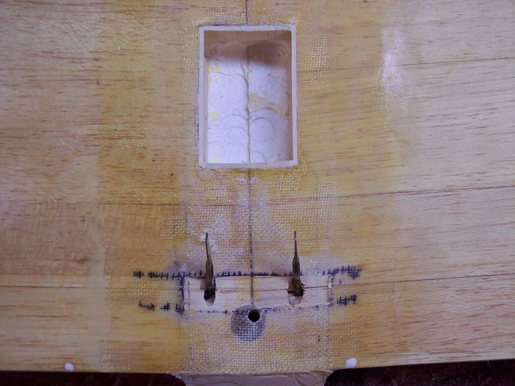

I have added the servo pocket, should have done it BEFORE I glassed.[:@]
I brushed on the weave filling slurry of vinyl spackle and water 50/50 mix. It fills in and sands easily in one coat w/o adding any weight.
Control surfaces ready for primer spray coat.

Sanding the slurry coat off, very messy

Old 10-13-2012 | 02:39 PM
  #193
edp's Avatar
edp
Posts: 624
Received 6 Likes on 5 Posts
From: Canton, OH
Default RE: Deception Build
Ready for spray primer next weekend A little over 4-1/2 lbs for complete airframe

It sits now in primer. I was surprised to find only a few blemishes pop up, mostly where the cloth sucked down into the grain in the top block . The slurry idea worked great.

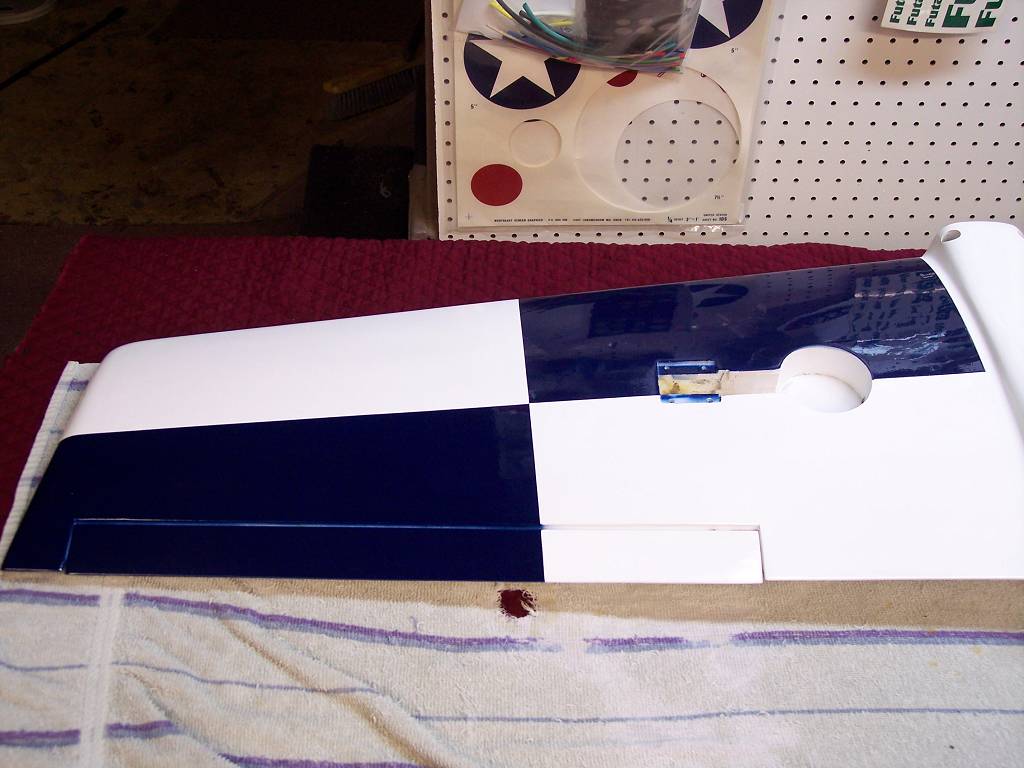

Blue and white done.

I like it!
