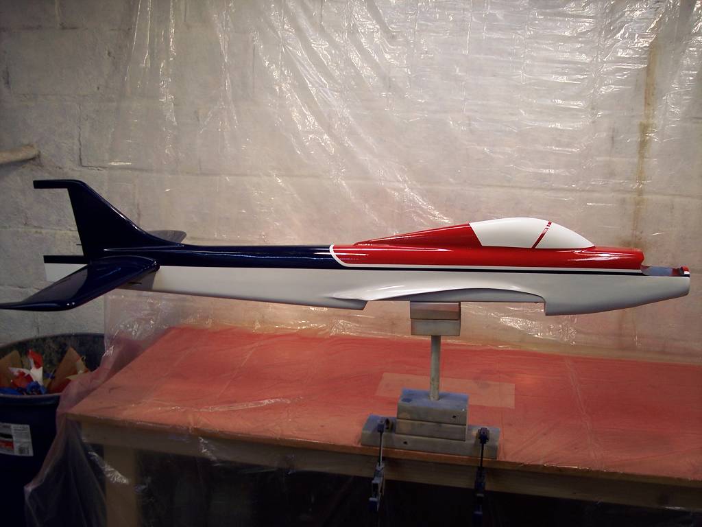

Default RE: Deception Build
The red on the fuselage is done. I just unmasked this at 1:30 am. Love that fast tacking paint!
Now I need to find a font I like for my lettering[:@]

It is ready for clearcoat
I let the geek in me use a Star Trek font called"Final Frontier" I will clear it in the Spring. I made all the graphics but the manufactures. I could have scanned them and make water slide decals like the off and psi set (someone always asks how much air I use).

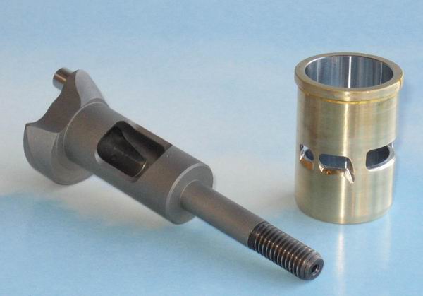

ORIGINAL: Roguedog
Not to hijaak the thread but do you have any detail's on exactly what your friend did to mod the VF. I have several.
Ialready modded one of my 61VF's with an OS PA-102 pump system. This is the same pump and carb used on the OS 61SF-P engines. I figured the larger throated 86 carb and matching pump should provide a boost and better top end.
Theonly other mod that I was thinkingwas to raise the exhaust port timing for the tuned pipe. Is this the mod your friend did?
Negative on changing the port timing. That would effect the idle and overall handling characteristics. It's been a LOT OF YEARS and I'm going strictly from memory.
If I remember correctly, the lower edge of the outer part of the side ports were angled downward. The port opposite the exhaust port did not have this feature, causing a 90 degree turn in gas flow at this port. We simply ground the outer side of the sleeve at that port to match the other two, leaving a 0.010" to 0.020" lip on top so as NOT to change the port timing. Nothing fancy but it worked.
BTW - I still have all my old pattern engines. OS 60 FSR, OS 61 FSR and VF, OS 61 LS rear exhaust with and without pump, ans one Bully 1.45 2-stroke from my 2 meter planes. Oh, a YS 61 AR that I never flew in a contest before going to 2 meter 120 size planes.
Jim

Sounds a bit like this sort of modification made to Rossi engines.
David
