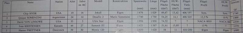

What was Chip flying in Austria '93? Who was third?

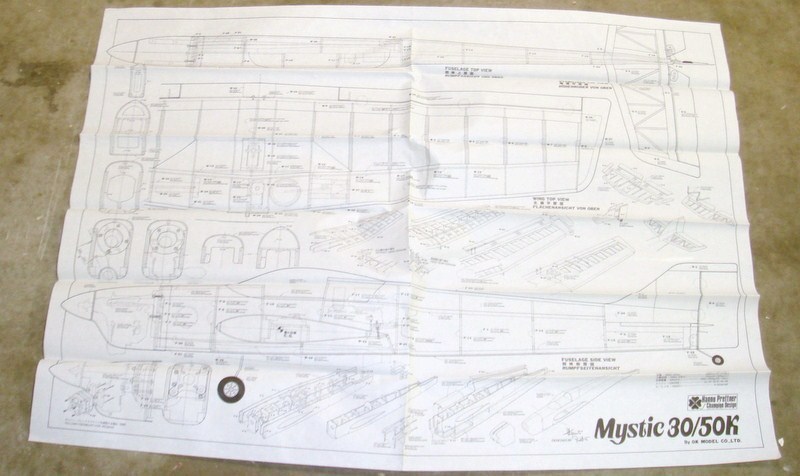

I know you've posted the F3A top three for the last 20 years or so before but I forget where it might be now.
I'd be interested in seeing that Supra Star plan if you have the means. I'd like to see how he changed it compared to the Supra Fly.
David.

I can't remember where I posted it either [
Chip was flying a Jekyll with an OS 120 and Wolfgang Matt was third with a YS 120AC powered Rubin.

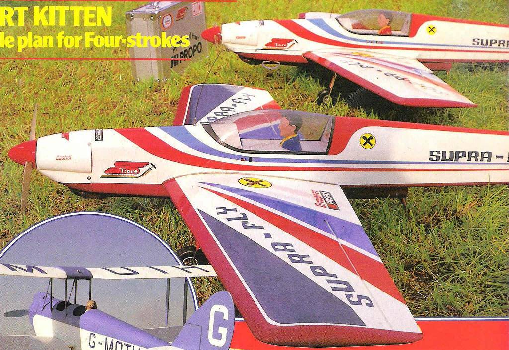

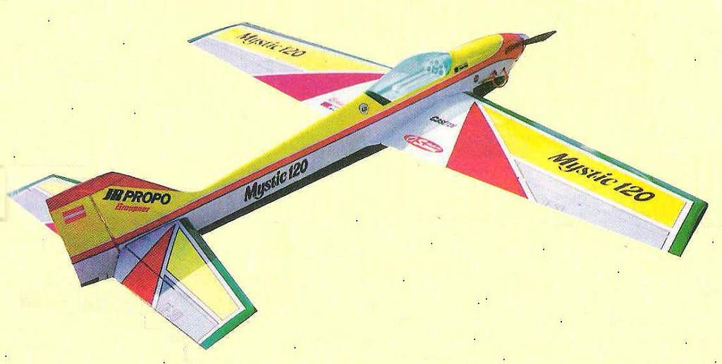

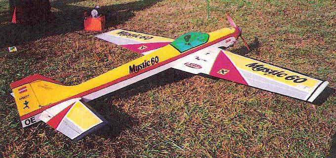

Ray,
fantastic shots! Thanks for posting them.
Now I know how Hanno's Mystic really looked. My scheme will follow his - just seems fitting. Question is, a 32 SX and Hatori 300 or a smooth closed cowl, 700W electric and a three blade Graupner 11x7?
It's interesting how the designs seem to sort of morph from one into the next. A composite scaled morph of the complete Hanno's design evolution would be cool to see (but that's just me).

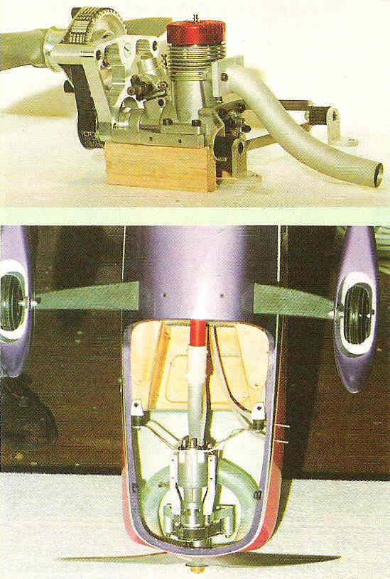

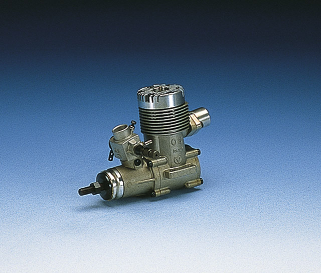

Some additional shots.
It occurred to me that the OS 40 VF on a soft mount might be the perfect candidate for the Mystic 30. But maybe a tad heavy. I'm going to have a field day going at that fuse. It'll loose 5-10 oz for sure.
I wonder why the Mystic BGX if there was a Mystic 120. This last must have been to satisfy F3A requirements.

Don't think I posted that but it does indeed show the final placings at the 1991 World Champs held in Australia where Hanno placed a disappointing 5th with the Mystic 120. Perhaps that's why he returned to a 60 powered Mystic ( Hanno Special) to win the event in 1993
The Mystic (OS)BGX was designed for use as a display model and possibly for a European contest class called, I think, RCI-X. This uses larger and heavier designs outside FAI limits. It was available as an ARTF and the shots you posted were taken at the annual Kempton Park Show ( a horse race course near London) which Hanno attended for many years as a demo pilot. I saw him fly the Mystic BGX there and it was the first time I had seen a knife edge loop performed. Needless to say I rushed home and spent months learning how to do it.
Ray

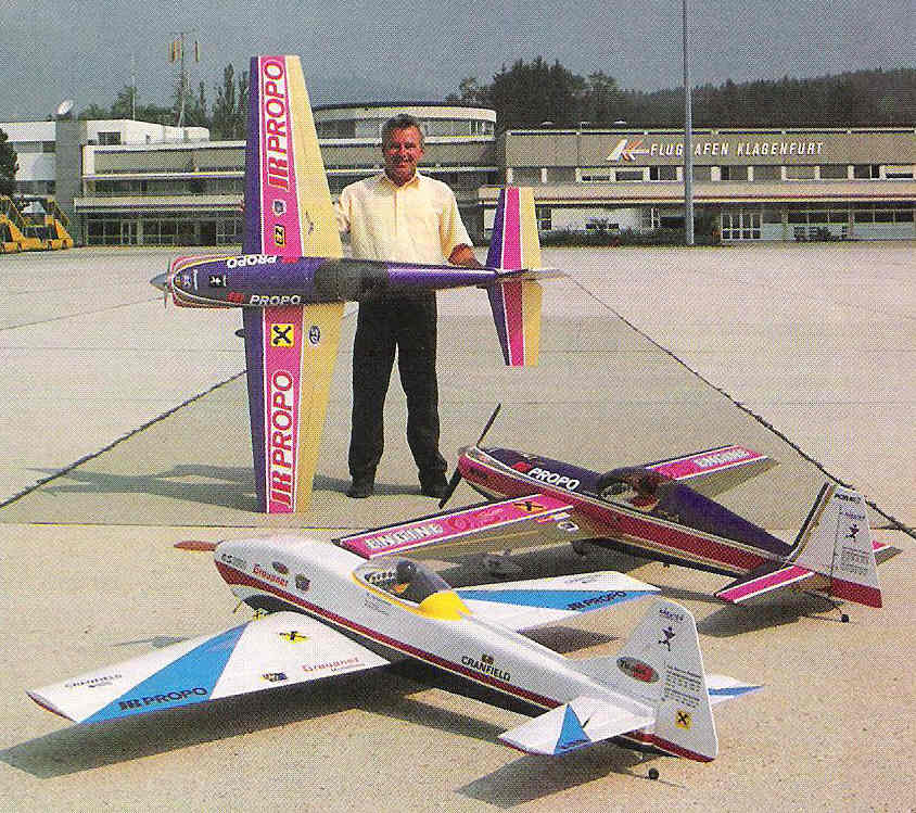

Well, if we are talking "serious" FAI, F3A type competition models as opposed to his numerous demo designs ( Supra,Sensation etc.) then this is what Hanno was working on to use in Japan at the 1995 World Championships. In the end he didn't compete in Japan due to illness and indeed never flew in any more World Championships. The end of an era - World F3A Champion seven times between 1971 and 1993.
They are both 2 meter turnround designs - an Extra 300S and a Cranfield A-1. One of the Extras and the Cranfield are powered by the OS supercharged 120 four stroke and the other Extra by a Hanno Special with 1.82:1 reduction belt drive.
