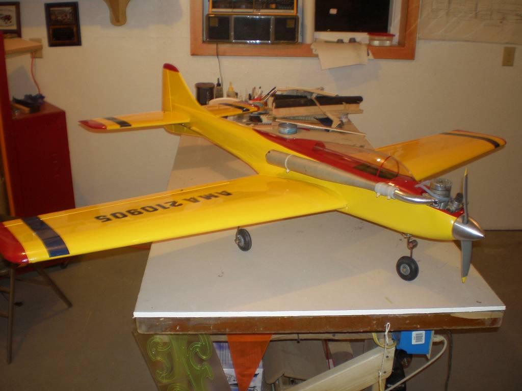

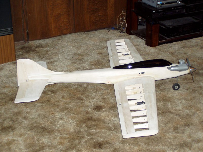

DIRTY BIRDY “60â€
Joe Bridi’s Dirty Birdy is one of my favorite planes. There have been numerous discussions of problems with the instructions so I thought that while I built a replacement for the one that I killed last year it would be a good time to keep some notes and post a few corrections. Let me start out by saying that this is not a difficult plane to build. If you’ve built a few planes the Dirty Birdy shouldn’t present any real challenges. However due to a few errors and some changes to the kit through the years, the instructions can be somewhat confusing. I hope that these instruction updates will help eliminate some of this confusion

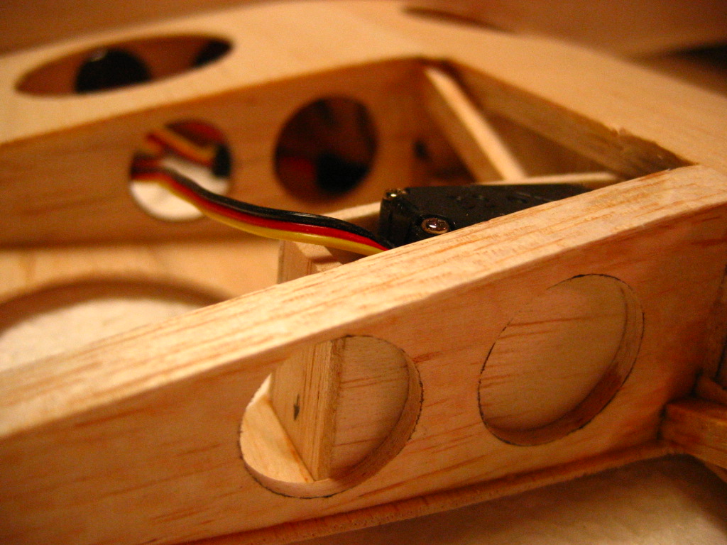

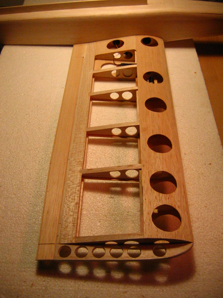

The Wing Panels
Paragraph 3 of the wing panel instructions describe drawing lines on the ribs. This doesn’t work with the current ribs as they have notches in the front and aft ends. More on how I used these notches later.
Paragraph 4 of the wing instructions says that ribs #3 and #4 are notched but that is no longer the case so be sure to notch them for your desired gear position. Note that on the plans the notches are not as deep as the landing gear block. The block actually stands above the ribs by the thickness of the sheeting so the block winds up flush with the sheeting. On my first DB, I made a mistake and cut the notches to make the block flush with the rib so I just sheeted over it. I wound up liking this much better because I’ve always had trouble fitting the sheeting neatly around the blocks. Of course if you sheet over the blocks, you’ll have to carve away the sheeting where the LG straps go so they don’t crush the sheeting. To do this neatly, drill and install the gear straps. Then use an X-acto to cut the sheeting around the straps. Remove the straps and cleanly remove the little half moons of sheeting. If needed, add a little patch on the inside. When you cover, just MonoKote right over the depression and ignore it. When you mount the straps they will pull in and everything will be very neat.
I like my planes a little tail heavy and my first DB liked to sit on its tail when the tank was empty so I moved my gear back about 1/4" on this one. If you plan to use individual aileron servos in the wing panels, plan their location and provide holes through the ribs for the servo wires.

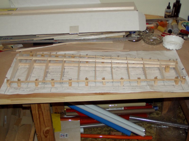

I understand the wing ribs in the newer kits have holes for a wing jig. I didn’t have the newer kit and I don’t have a wing jig. The instructions detail how to build the wing without a jig but I decided to build a jig on my building board. My jig consisted of balsa strips that fit in the slots in the front and back of the ribs and blocks to hold the strips off the building board. The jig was more work but was very solid and accurate. These instructions are for my method of building the wing. If you don’t want to build the jig, just follow the original instructions. But be sure to read the original instructions if you follow my method too. The steps marked with an asterisk are applicable to both methods.
To make the jig, cut four 3/8†strips from hard 1/16†balsa. Make these at least 1†longer than the wing, you want them to extend beyond the outside ribs. Make a pile of 26 - 1†x 1†x 1/2" blocks from 1†x 1†balsa. Pin the balsa blocks to the plans between the ribs about 1/8†inside the position of the leading and trailing edges plus one just outside of the first and last rib. Make sure the blocks do not touch the line on the plans for the LE or the TE or they will block the LE and TE. Look closely at the included picture. I build on a very flat hollow core door and hammered the T pins into the table. It was lots of trouble and lots of bent pins but it worked very well. The picture of the jig, spars and ribs tells the story. Note that this picture is before the LE and TE are added.
1. Pin the root end of the spar to the plans. Pin a couple of balsa blocks on either side of the spar in the outermost rib bay but don’t pin the spar itself, just capture it in place so you can lift the tip of the spar while the blocks keep it lined up with the plans. Again, look closely at the picture
2. Put the ribs in place on the bottom spar. Be sure ribs 3 and 4 have the LG notches down. (On the second wing panel ribs 3 and 4 must have the notches up.)
Slide the strip of hard 1/16†balsa into the front and back slots of the ribs, lifting the ribs so the strips will sit on top of the 1†blocks. These strips are only for positioning the height of the wing, they do not need to be glued to the LE or TE so seat them deeply into the slots. Make sure the strip extends beyond both end ribs to sit on the jig blocks on the outside of the first and last ribs.
Pin the hard balsa strips to the jig blocks. Make sure the strips do not extend beyond the front or the back of the ribs. Check the position of the ribs and square them to the table.
Add the top spar and be sure to set the spars completely into their notches. Realign the ribs. This is where the picture was taken.
CA the ribs to the spars making sure the spars are fully seated in the notches. Do not glue rib 1 to the spars! Use a square to line up the front and back of the ribs and tack glue them to the hard balsa strips. Do not get glue on the jig blocks.
3. Add the trailing edge. Glue only to the ribs, not to the hard balsa strips. Doing so will risk gluing the wing to the jig blocks

Add Bottom Cap Strips. If you are building servo bays in the wing panels, you may want to omit two cap strips on each side to allow for your servo mounting.
