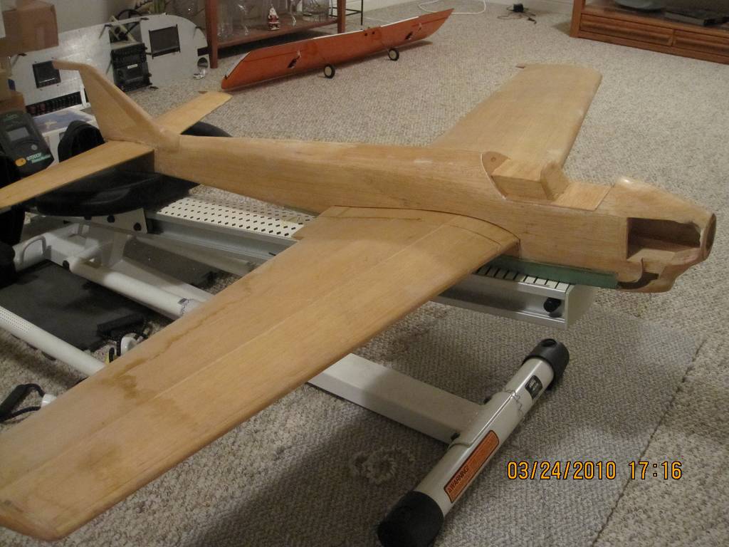

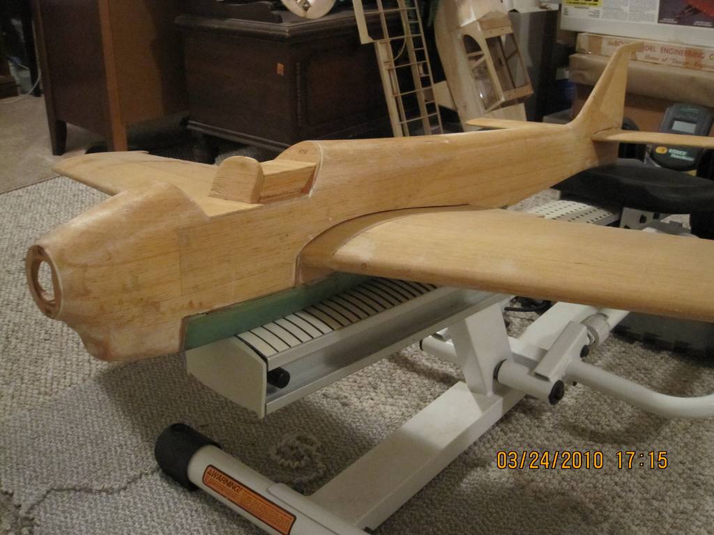

Boy do I feel stupid!!, this is a comos 45 not a 60. here are some pic's. wing span 57 1/2" Pete

Pete,
well, she looks ready for some primer! Other than that, all you need is a YS 45 FS, Hatori header and 400 pipe!
Were you able to get a copy of the plans for the control surfaces?
David.

The Hatori header should be #552 if your running a YS 45 FS engine (which you should!!)...
http://shop.singahobby.com/?q=node/18127
Boy that thing looks really nice Pete!!
I see a nice looking scale dash leaning up against your back wall in the first shot...Oh..That may be for the .60 size plane cause it looks a little big for the .45...

Hi Chuck and David, sorry I have not called you Chuck after finding out I had a 45 I was depressed! not really. The Cosmos only has 1 coat of on it and its been on there a long time some of the fiberglass has pulled off. Chuck maybe you can look at it and give me some advice finishing it. The plane you see in the background is a sterling Piper Tri Pacer 54 WS.
I met Dan Hines down at Perry and he gave me that plane with the Cosmos that I traded him for.
Regards, Pete PS: Chuck could you call me PM sent

By the way,
those rowing machines are actually intended to catapult launch classic pattern designs with gear up!
Pete, if the wood is sealed and there's already glass on it, I would consider using waterborne primer/paint starting with polycrylic prep followed by a mix of talk/PC to fill the weave. I don't think there's any issue with using PC atop epoxy if that's what Dan used to lay the glass down. A good sanding might be in order first though.
David.

Aww Pete I was talking about your RV-7 dash...

Chuck, sorry, your right that is my panel for the RV7 did not see it! lol! I might try that David, just don't know if I can get my wife to row it that fast! Pete
