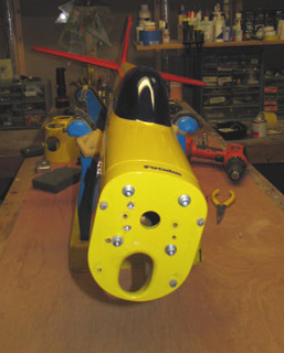

Anyone know anything on a plane called Papillion??
Here are the measurements:
Fuse Length: 58.5"
Wingspan: 72"
Chord Root: 12.5"
Chord Tip: 12.5"
Weight: approx 9lbs
What sorta engine would you think to power it?? I'm thinking it may be a little large for a .61 rear exhaust..Any Comments??
Notice in the picture of the bottom of the wing the sticker which appears to say 1971 R/C World Championships...This plane is not of that era is it?? It has a pipe tunnell and modern looking retracts so I kinda figured late 80's to early or mid 90's...
Maybe a YS 120 for power?? I see what appear to be two fuel dots on the side of the fuse which is how I set my YS engines up...One dot for fuel and one to vent..Just an observation..
The cowling is so hacked up I can't envision what type of engine would have been in there...Maybe more than one over time?? The round cut out on the bottom of the cowl initially had me thinking it might have had a .61 rear exhaust mounted inverted with the pipe running down the belly...Then I got the information about the size and I'm wondering if it's too big for a .61 two stroke?? So maybe a YS 1.20 with a pipe?? I dunno...

Sooo...If you were a butterfly who was in a movie...What engine would you put on this plane???
Old 03-12-2010 | 06:48 PM
doxilia's Avatar
Joined: Apr 2008
Posts: 5,200
Received 9 Likes on 9 Posts
From: Montreal, QC, CANADA
Default RE: Ever here of a Papillon??
120AX
Old 03-12-2010 | 09:54 PM
My Feedback: (121)
Posts: 2,307
Received 40 Likes on 39 Posts
From: glen allen, VA,
The movie was good. The book was better.
120AX sounds good to me, too!

Hi Chuck,
Re: my Papillon- I have an O.S. .91 RZ-H heli engine which I converted to an airplane engine by adding the drive washer and prop nut. This engine was perfect for the plane because it has rear exhaust which, when installed in the plane, will sequence the header and pipe right into the provided cradle beneath the plane.
About 5 weeks ago, I called MAC PRODUCTS (http://www.macspro.com/prodline.asp) to order the header (part no. 3901). The problem is, after calling twice to see if it has been mailed, I'm not sure that I will ever see the header?
Do you know any other source from which I may get the header to fit the engine?

Mac Header arrived finally! ... perfect fit. I'll post new jpegs once all is installed.
