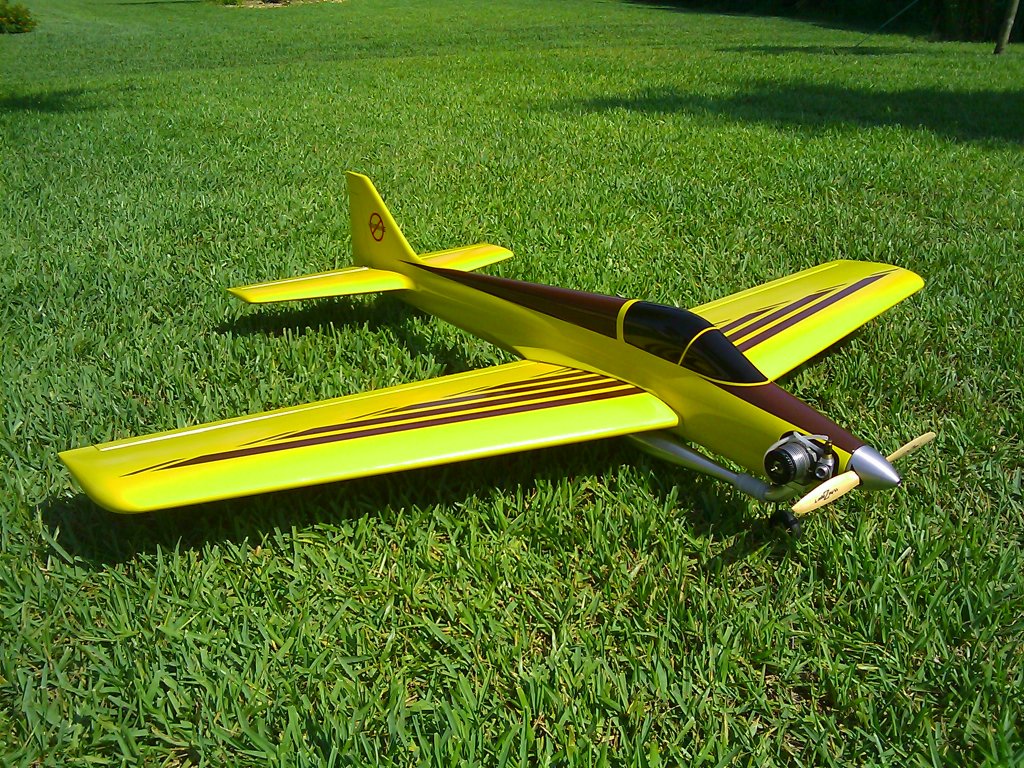

Phoenix 7 and 8 from original kits. Circa 1977 for the youngsters. All glassed with PPG concept urethane finish, piped Rossi 60s, and Spring Air retracts. Dan - I really wanted that Brushfire to be in this line up!!!

Well Mitch I have to ask you, are you going for the “Phoenix Rising†theme with your graphics? (Dumb Question) I love how the graphics on the wing create the illusion of bird wings and of course the fire yellow. How does the bottom look? Solid yellow? I always wanted to paint a Phoenix and capture the rising from fire concept. I think your graphics does it in a very clean format that I love. So if you were not trying to interpret “Phoenix Rising†then serendipity has played a mighty hand.
PS I'm very jealous. I flew Phoenix in competition in the early 70's to 79. I quit flying in 79 and returned recently. One of my goals is to have one of each version of the Ps. You are half way there!

I'm partial to the one with the shorter nose, from a strictly cosmetic prospective. The one that's in the rear, in the first picture. Would that be the Phoenix 7?

Yes the P7 is 10.125" from the wing leading edge to the spinner back plate, the P8 is 10.625", .500" difference, I'm surprised you could see that in the photo!

The Phoenix theme was my exact intent. It is a bit more subtle but if you look closely you will see that they both have forked tails also. I was initially planning my classic pattern checkerboard at the root and striped leading edge, but as I started laying out the tape for the trim colors I decided to go this way because they were both phoenixes. The bottoms are all yellow. As I get older I have reverted, again, to the old trainer trick of distinctive difference between the top and bottom simply because my eye sight is not what it used to be and the contrast does help, particularly in following the orientation in a spin.

Nice planes, you can see attention to detail in those gorgeous tailplane fillets, but you spelt "hoovering" wrong!!!

Mitch - You have matched the spinner's to the nose, looks perfect to me. Any mod's to the nose for spinner fit ?

No mods. I do shop for the spinner that has the best angle, they are not all the same. It is always the most expensive one = see joke above. Seriously I use metal spinners almost exclusively and there is a limited selection. These are standard true turn and they fit very well. I use a 1/16 ply shim to get the angle and spacing perfect which I think is critical to the way the front end looks.
