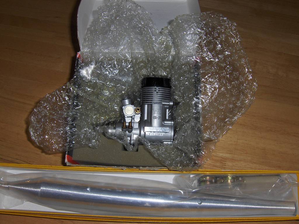

<p class="MsoNormal" style="margin: 0in 0in 0pt"><font face="Verdana">
Arch, Thanks for the heads up.
</font></p><p class="MsoNormal" style="margin: 0in 0in 0pt"><o
><font face="Verdana"></font></o
></p><p class="MsoNormal" style="margin: 0in 0in 0pt"><font face="Verdana">Motor arrived, Now waiting on the Performance Specialties Kit, decided just to get it and make it work for a rebuild.</font></p><p class="MsoNormal" style="margin: 0in 0in 0pt"><o
></p><p class="MsoNormal" style="margin: 0in 0in 0pt"><font face="Verdana">Looks like The AR case was clearanced for a mount, The raised letters “made in Japan” were removed from the case.
</font></p>
></p><p class="MsoNormal" style="margin: 0in 0in 0pt"><font face="Verdana">Looks like The AR case was clearanced for a mount, The raised letters “made in Japan” were removed from the case.</font></p>
