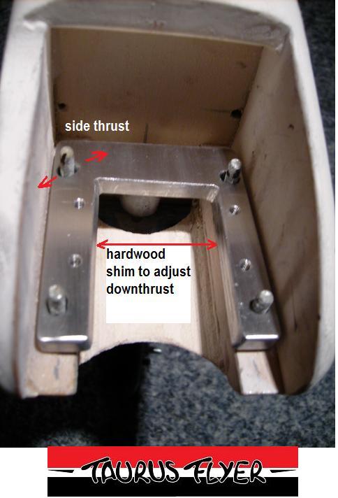

The Top Flite Taurus normally has hardwood rails
My Taurus already has many hundreds of flights in the logbook, the bolts are glued in the rails. Even the Taurus is “overpoweredâ€, I have no technical problems with this method.
My replica of the first Contest Taurus, as many planes of that era, does have a mount plate.
This plate is bolted on the rails. The engine bolted on the plate.
With this method it is possible to mount different engines in the plane or easy change side and down thrust.
Now I am redesigning the Simla I am thinking of use a mount plate again.
A study plan of that method see picture 3
Cees

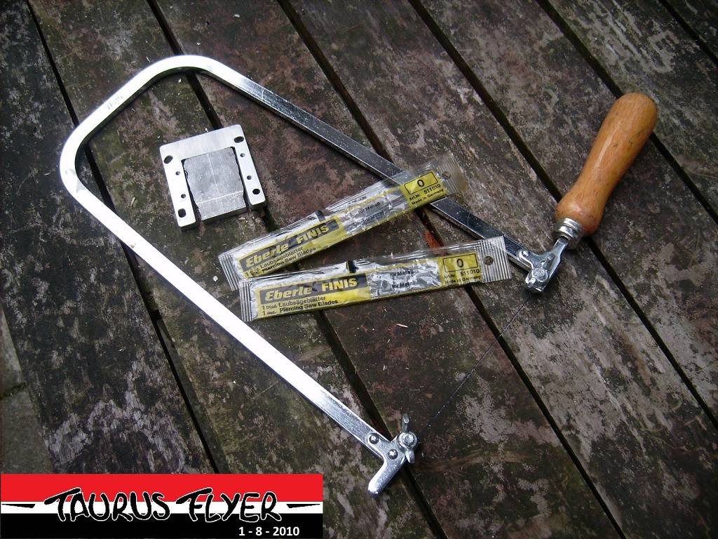

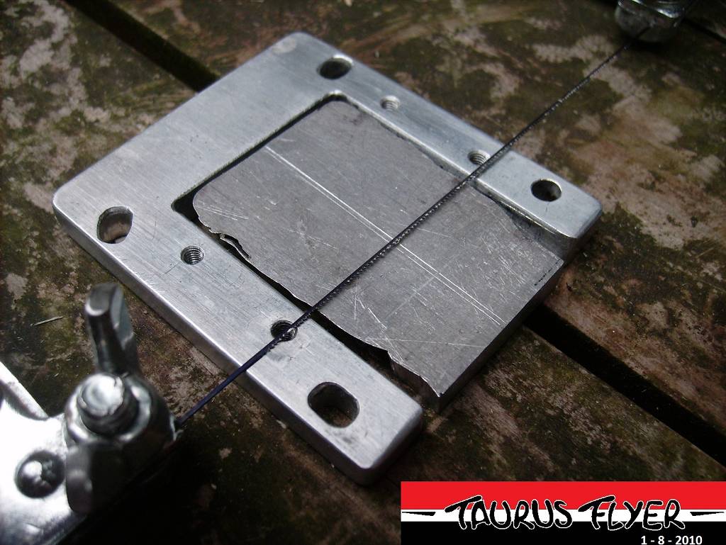

Brian.
This is the saw I use to cut this 6 mm, ¼ inch aluminum. (How do you call this saw, a “fretsaw�)
Saw blades I use, “piercing saw blades for metalâ€, brand “Eberle†number 0.
After cutting of course the normally used files and drilling- and thread tools.
Very important is, using cooling liquid, “spiritus†(Dutch), spirit is maybe the right translation. Keep the cutting area of the material continuous wet by dripping a little bit of this liquid (drops!) on it. (sawing, drilling, making thread)
Without this liquid it’s not possible to saw the aluminum or make a good thread in it!!!!
You also can use less thick aluminum but you cannot use threaded holes I think.
I also do use this saw to saw all the wood of my planes, it allready has hundreds of feet on the counter.
Cees

Brian,
Someone has to help us with "spiritus" and the right translation. Cutting oils I use for steel.
Spiritus is a normal "household liquid" (my coal English!!) to clean windows, it's a kind of (95%) alcohol.
In the Netherlands "spiritus" is also used in little burners for (cheese) fondue.
The saw blad is only 0.0135 inch wide (0,34 mm) so it cost me nearly no power to saw, only time, one quarter of an hour for this piece of material.
Of course you also can use or try other tools/saws, whatever you can handle.
With my saw I can make curves.
Cees

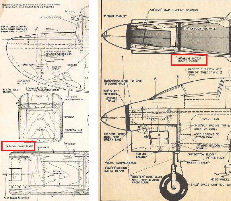

Ed,
I did not see examples of a shear plate made from plywood. Maybe these are used for small engines
I show the Smog Hog of Howard Bonner, a Tufnol plate is used (known by me as brand "Novotex") and an example of a later plane, the Crusader of Ralph Brooke, 1/4 " aluminum.
Another method to reduce crash damage is using brass bolts/screws to mount the engine on the plate or rails (Ed Kazmirski)
Cees
