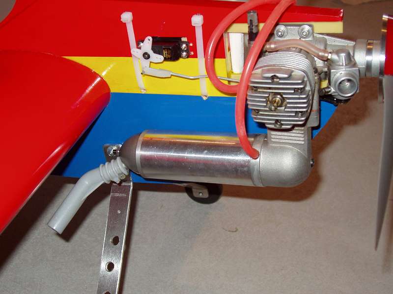

Hi guys
I practice the inverted flat spins on my profile Edge540T but the engine wants to quit when the Edge is spinning inverted? The power come back as soon as i recover the plane to normal fligh?
I can fly all day long inverted without any power issue but the engine wants to quit as soon as i do inverted flat spin.
Do you have any idea to solve this issue?
Os46FX with tower muffler

Scooby,
It sounds like the clunk in the tank is either hanging up and not picking up fuel or getting kinked. In any case, you will find the cuplrit in the tank somewhere.

My clunk should be fine because i don't have power problem when i fly inverted?? It happens only in flat spins inverted??
Anyway, i am going to open the tank to be sure....[>:]

I just took a close look at the photo. Try getting rid of the exhaust deflector. That's a lot of extra back pressure, and the deflector on the while engine inverted at idle may be letting a lot of oil remain in the exhaust pipe, possibly causing the glow plug to cool or foul.

This is happening because the clunk gets folded forward when inverted, and spinning. It drops down (maybe getting tangled in the vent line) then the rotation of the spin forces it forward, and now it's got the fuel line kinked.

Thanks for all the suggestions guys, I am going to try each one, step by step..
Yesterday, the engine was a bit better. I cut 2 inches of tubing between the tank and the muffler. The engine gave me a bit more spins before to quit.
They suggested putting a one way valve in the pressure line to keep tank pressure up. I've got to try that
David, i tough the one way valve works for liquid only? Are you saying the valve will keep the air pressure at the maximum in the tank? I like this idea but what valve part number are you talking about?
Good idea!

Daniel, It's a suggestion I heard on another post. I have not been to the hobby shop yet to ask. You may be correct about it only working on liquid. Or maybe there is enough fuel residue in the exhaust line to make it work? I am going Sat I'll pick one up and try it.

It's called a "check valve" and they work on fuel or air. They are standard on YS engines to maintain tank pressure on the air side. I think Jettblue's explanation might make more sense and a stiffer and/or longer fuel line on the clunk may be the answer.

You can make a check valve if you've got a BB and the type of fuel filter that unscrews. It has a little, fine screen in it. You unscrew the filter, put the BB in one side, and then screw it together. The BB should be on the side of the screen closest to the muffler. Or....the sequence of parts: 1. muffler pressure line 2. filter half 3. BB 4. screen 5. filter half 6 muffler pressure line to tank.
Won't work/run with it backwards.

I tried the check valve thing on my OS 91FX. The pressure helps at at higher speeds. but when the engine is brought back to idle it would flood out. It seems as if a regulator of some sort would be needed.
I think I would also look at the clunk set-up first.

You will need to re-set your low speed adjustment.
My engines are always well set
I usually use 15% nitro Wildkat fuel on my os46fx with tower muffler. Someone at the field use only 30%nitro, 18%oil to practice 3D with 2 strokes engines. He tried many things with tuned pipes, 4 strokes engines and on the same planes. He got the best results with 2 strokes engines and more nitro than any other solutions. The engine will run colder and be more crisp. I bough on gallon and i am going to try it next weekend.
