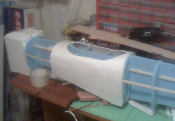

I found one(free2design) that will print, but I need to be able to print out the fuselage profile in full size. I want to use the print out as a template to cut out two pieces of ply to build on. I'm going to place the formers on the cut ply, fill in between the formers with foam, sand the foam to shape, then finish off with some kind of filler to a smooth glossy surface. I have tried enlarging at kinkos before but it was a real hassel and hard to get the size exactly right.

I'm going to build similar to what this guy is doing with a yak, but I will be using wood and foam rather than all foam.

ORIGINAL: jeffk464
Hey, thanks. I could use wood too, but this foam was at hand and decide to give it a shot. It turns out well so far. I did print all parts on tabloid size laser jet. Only couple of gluing was require to get full size plans. May be next one will be all wood too. What size your FW is going to be?
