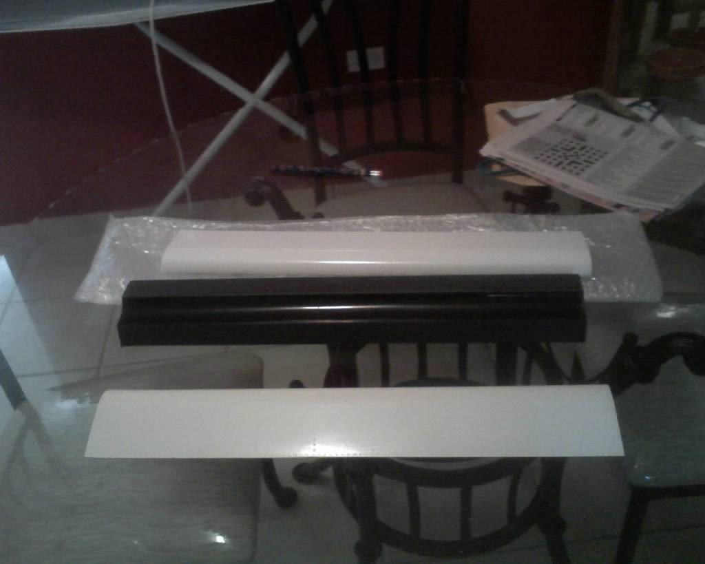

To give you the idea. This is not a fuselage but the same principle is apply. This is my first attempt doing a mold. Not perfect but I'm happy with the results. There is much more info here. Do a search and you will find lots. In a whole rainy weekend with not much to do I decide to do it. This is the splash of an AW Hawk jet kit flap. I use the original flap as a plug and make a female mold of the LE in order to replicate the Flaps Vanes. Glass stick to the parting board even with 8 coats of wax and PVA. Next time I will use some clear tape or monokote in the parting board. For fuselages after the female molds are made is where it comes what Ed is describing. Wax, PVA, Paint, glass cloth, balsa core and another glass cloth. All this get in to vacuum bag.

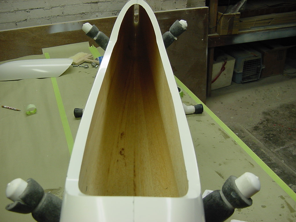

I'm not a manufacturer but I'll try and explain the process I use. I've made about 5 glass, balsa fuselages and seem to learn something everytime. But here is how I do it.
1. I use 1/32 balsa and glue it together with medium CA then sand the seams to a smooth finish. (wood glue will not hold up to ammonia water)
2. Using a pattern I made off the inside of my mold, I cut the balsa the shape of the fuse.
3. I wet the balsa skins with ammonia water then bag them in the mold to form it, leaving it in the bag for 24 hours.
4. After the balsa skins are dry, I seal the wood with hairspray on both sides so they will not soak up a lot of resin. The hairspray will somewhat relax the formed skins so I lay them back in the mold while the hair spray dries.
5. Wax and PVA the molds, then prime them with PPG epoxy primer
6. First layer in the mold is 2oz cloth from nose ring to tail post and 5oz carbon from nose ring to slightly past the chin cowl
7. next lay the wood then glass it with 1.4 oz cloth to complete the sandwich.
8. Cover with peel ply, then release film and finally breather cloth. ( use the release film so the peel ply doesn't stick to the breather cloth)
9. Put it int he bag for 9 to 10 hours pulling 8 to 9hg.

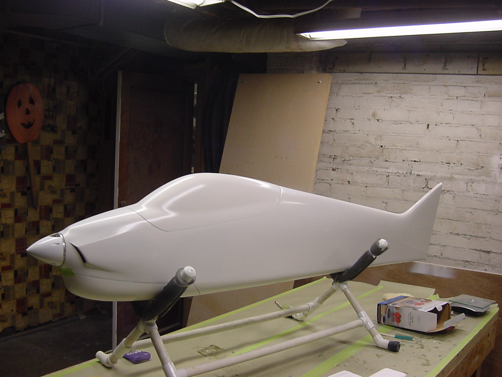

Attached are some pics of my latest 2 meter pattern design. This fuse is quite tall at 14". The total fuse weight is 31oz including canopy and chin.
Hope this helps!

If you use PVA properly it will always come apart but PVA "must be sprayed on" in a thick layer like a layer of plastic. Wiping it on is a waste of time.
Jim Fox
My Feedback: (14)

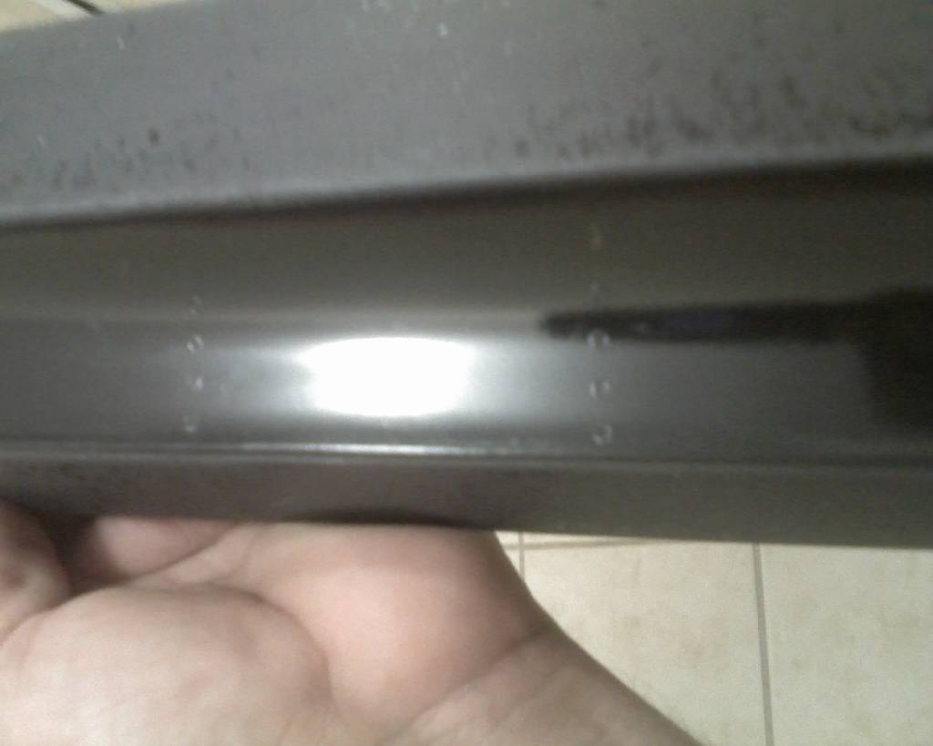

Jim the sticky problem was only in the parting board. The mold came off the part very easy with no work at all. But yes the walls of the mold that was held on the parting board was different story, They came off with no much effort but they do stick to the parting board. I guess cause I did not seal the parting board prior to wax. For me make the first part I'm very happy with the results. But I'm open to listen all opinions to make it better next time. Thanks for your comments.
Alex
