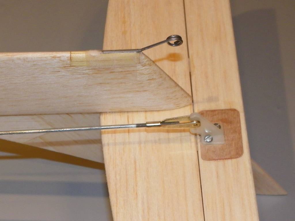

Default RE: Flite Streak for Tee Dee
Here's how the controls will be...
ID:	1581259   Click image for larger version
ID:	1581260   Click image for larger version

Old 04-05-2011 | 08:33 PM
GeorgeG97322's Avatar
Joined: Nov 2010
Posts: 41
From: Albany, OR
Now we're adding the weight... Covering is teal monocoat and the body is black Formula-U
George
ID:	1589949   Click image for larger version
